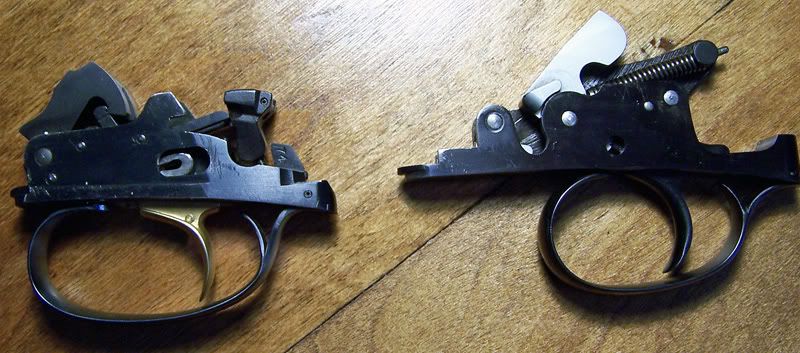

Thanks for the explanation Bryce. I took out the triggers from my DT10 and TMS. One is coil and the other is leaf spring.
Here's the DT10. I checked the 'play' in the hammers and here is what I found:
Notice that the top hammer is back a little further than the bottom hammer. This shows the amount of play left after the hammer has been released. This is a good indication of the inertial aspect of the leaf design. Interesting...I never knew that. My coil spring hammer from the TMS has no play due to the pressure constantly exerted from the spring.

That is the ticket Rastoff.
On a Perazzi trigger the hammers will not actually sit there like you show with the one hammer forward on the DT10 trigger. You can pull them forward but the spring will pull them back to their rested position.
I don't know if the DT10 does or not but the Perazzi uses a bridle on the hammer, essentially a pivoting attachment that is fixed to the hammer that the little hooked end of the spring pulls up on.
You can see the bridle sticking up with the top leaf of the spring hooked under it. Imagine a bridle as in horse riding stuff, shape is along those lines, basically a sort of plat sided looped link between hammer and spring. If you take the spring out the bridle is free to flop back and forth but constrained sideways. You lever the spring in with the tool and flip the bridle over the hooked end on the spring and the spring tension holds it all where it ought to be.

Yes, I get it. The Beretta is essentially the same, but the hammers are not constrained/held/assisted by the 'bridal' you describe. Also the springs are in a completely different geometry. Still, the end result is the same.
