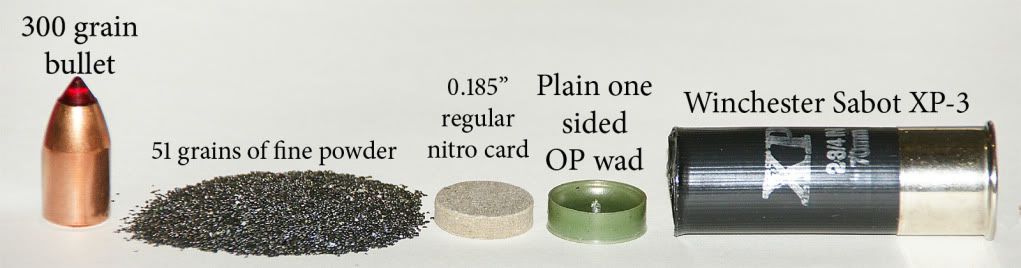

 Post subject: Re: 12GA 3 & 3/4 (From Hell)
PostPosted: Sun Jun 24, 2012 6:37 pm
Joined: Mon Nov 03, 2008 9:38 am
Posts: 1318
Location: Iselin, N J
Ok Ed, now that we got your undevided attention:
I just got 500gr 58cal in accutip sabot over 2000, that is 5000 ft lbs
Both loads in 3.5" REM STS green cases. Rem STS primer Both with
accutip sabot setting on x12x seal and 1/4 white felt/fiber wad.
Powder was 100gr of IMR 4759, compressed hard and enough room for
medium length roll crimp down over the top edge of the sabot.
Now Ed, does this picture represents your load 100% to your satisfaction or are there some mistakes in the picture, correction, please!
Ajay
Video Memories
VdoMemorie's-Blazing Sabots
www.PreciousVideoMemories.com

Hello SlugShooter, start with
3 inch Fed. GM hull, Fed 209 primer, starting load of 47 gr of Blue Dot
next 48, 48.5, 49 gr, 49.5 and then finally 50 gr of Blue Dot, look for pressure signs or extraction marks etc,
now cut a 1 inch square of any photocopy paper lying around, now push this down with a .625"
( 5/8" ) wooden dowel over the powder to gently cover it.
I hate this powder seeping issue so this is how I fix it!
Now take Hornady Versalite red wad or Fed.12S-4 brown wad and put a .125 nitro card of 16 ga at the bottom of the shot cup and then the slug on top of it!
Now place the hull on a weighing scale and with the wooden dowel push it down till the scale reads 40 to 45 lbs, roll crimp right away for a 1/4" deep crimp like in my picture above on the right reading
40 gr of steel!
Its fun time now go shoot and report back with the target picture and a chiropractor bill!
Do the above at your own risk and from a barrel of at least.905" at the muzzle for your own safety!
