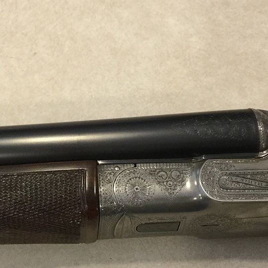

Hello All,
Well, the 700 NE finally arrived home on 4/5/16. Total build time was just over 5 months. That's remarkable! But I think Aaron went above and beyond as a personal favor to me. I expect a build time of 6 - 9 months is more realistic for such a project.
Finished weight with the 28" barrels is at 18 pounds 1-1/2 ouces and 18 pounds 10 ounces loaded.
When loaded, balance point loaded is "exactly" centered on the hinge.
Fit and Finish are amazing, and I expect its Aaron's attention to detail that defines him as a Master Gunsmith. My pictures don't do it justice. Hopefully, tomorrow I'll get some nice weather so I can shoot it.
Compare these pictures with the ones on the first page; before - during - and now after.

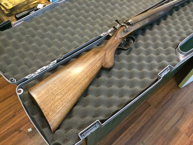

Hey, I hunt too! Took my WW Greener 12bore on a duck hunt, she's still relevant after 120+yrs.

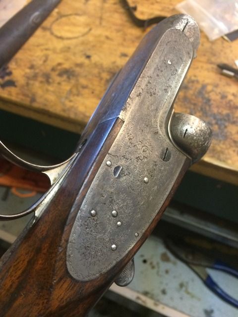

Ugh, looks like someone left a 1910 era Purdey in a soft case! This one is still in the works but will have the puts laser welded and stoned down, engraving recut, action color case hardened, and stock refinished.

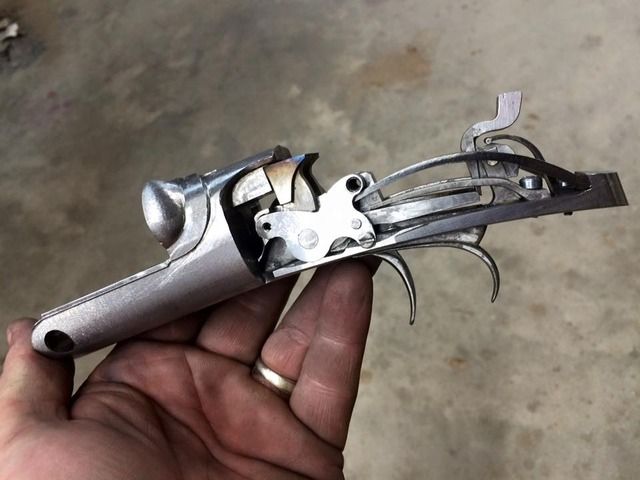

Round Action trigger plate guns anyone?

Wow! A greener with the greener safety is one of the last guns on my list. Great job! In a later post on the WC Scott does the rifle still swing the same? Mine from them has an incredible flow

The Greener can be yours!
The WC Scott is a 12bore shotgun, the only work I did to it was restocking.
