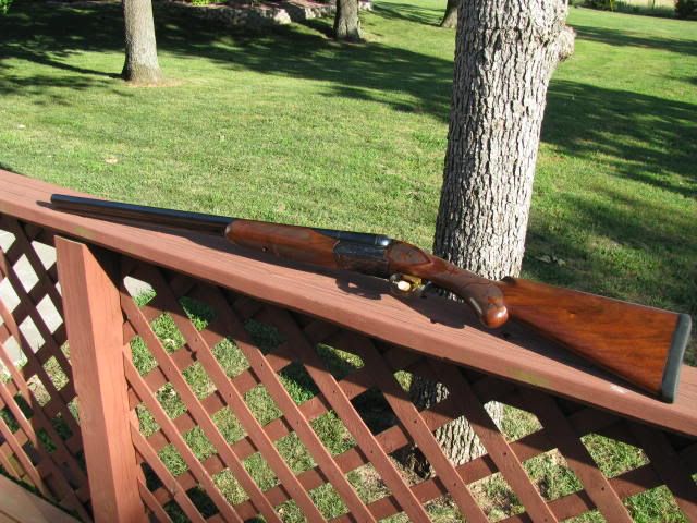

I've really enjoyed shooting my Zabala made BSA Classic 16 ga this year on birds, but have been lusting after a similarly configured sidelock 16 ga. I'm not looking for a "Best" gun, just a good, honest hunting sidelock 16 ga. I've come to the conclusion that they just aren't out there.
This is the BSA Classic 16 ga with Briley chokes that I've been shooting real well this year.
I went to this site: http://www.ugartecheashotguns.com/ and determined that I could have a gun built to the POW stock, single trigger configuration I want. I sent an E-Mail to Ugartechea last week, but have not heard back from them about building such a gun. This morning I called Lion Country and talked to them and they said no problem and are sending me a custom order form. The only issue is they will not warranty the single trigger.
I've decided to go ahead and order the gun and have decided on the following configuration:
16 ga Model 257
Old coin finished receiver
28" barrels choked IC/Mod for upland game over a pointing dog
Plain rib (not hard over on this one)
Half pistol grip stock (POW)
Medium beavertail forend
Single trigger (non selective, same as my BSS and S&W Elte Gold)
My fitted dimensions of: LOP-14.25", DAC-1.5", DAH-2.25", Cast off- .375"
Spare firing pins and springs
Anyone see anything that you would disagree with? Of course I realize most of you would not order a gun configured like this, but other than that, any red flags?
An elderly gentleman, his faithful dog, and a 16 ga SXS. All is right with the world.
