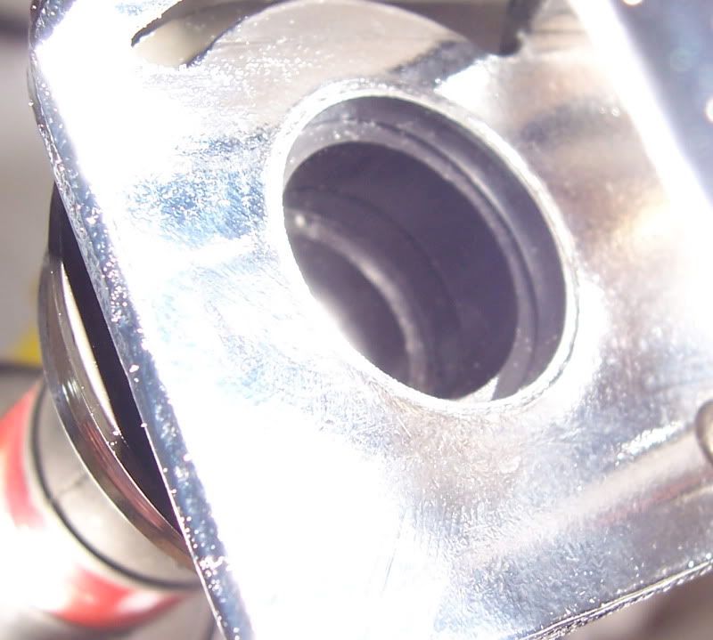

bggwind wrote:
I have installed the Powder Baffle over my universal charge bar, but my baffle is the zinc one from Multi-Scale (came with my charge bar in a package).
I guess I'll start with my bottle tension, but I believe I have the washer/grommets correct as per the enclosed instructions. Any ideas?
Yes, - you can not use the .060" thick, flat brass washer that comes with the MultiScale baffle. You need to use the MEC-supplied thin beveled brass washer and the black neopreme washer that came with your machine (that you can also get from MEC).
Here's how it works...
Consider this photo of a Multi-Scale metal powder baffle screwed into a MEC 9000 (with no washers):
#1:
Notice that the spring-loaded black plastic nipple on the metal baffle is larger than the bore of the housing. The I.D. of this nipple is close to the ID of a MEC powder bottle (.625 on the baffle, .618 on the bottle).
The O.D. of the nipple/sleeve on the Multi-Scale baffle is .747, and the I.D. of the base bore hole is .727 which is a .020 difference.
The spring-loaded nipple/sleeve of the Multi-Scale metal baffle doesn't go thru the bore on a MEC 9000, - it simply provides a flat/square "seat" for the washers to mimic the flat surface on the threaded edge of a MEC powder bottle. In this configuration, the nipple is nearly bottomed out in it's travel with only about .005" of travel left, - not enough to take up the .050" that you'll read about in #3c below.
#2: (common sense instructions)
The bore hole thickness at the base of the threaded hole in the housing of my 9000 shown above is .140 inches.
a) The rubber washer is .130 inches thick.
b) the MEC supplied springy brass beveled washer is .010 inches.
c) .130 + .010 = .140 which is the thickness of the base bore hole in the housing.
d) The bevel in the MEC brass washer is the element that is providing uniform contact pressure.
#3: (Multi-Scale instructions):
a) The brass washer supplied by Multi-Scale is .060 inches (original ones were thinner).
b) .060 + .130 of the rubber washer = .190 inches.
c) .190 - .140 = .050 of an inch that the rubber washer gets compressed when you seat the metal baffle if you use the thick brass washer.
d) The charge bar will be completely clamped, and immobile in the housing if you tried to apply the Multi-Scale instructions on a MEC 9000.
#4: (possible stupid-user tricks)
a) If you were careless enough to do #3 above, - you already know what happens.
b) If you were careless enough to just use the Multi-Scale supplied thick brass washer (and no rubber washer), then you will get powder leakage (ball, flake, square, oval or otherwise).
c) If you were careless enough to use just use the black rubber washer an no brass washer (of any kind), well, then you still belong in category #4.
