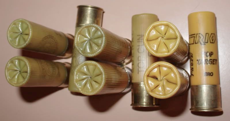

The universal's will reload, but like others have said, it's not a good reloading hull.
The cheapy Federals (Top Gun) and Rio's (Top Target) load well, as do the Estates as shown here :
The Orange duster works well, and Hodgdon's Unaversal is a good loading powder. Unique works too. Here are some recipe's:
viewtopic.php?f=13&t=205722&start=0&hilit=misc+20+gauge+chrono+test
