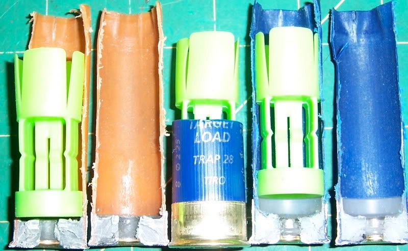

Rio used 3 different base wads. The most common in the Rio hulls that we see out here have the taller base wad which has a fairly thick edge on the top of the base wad that will catch on the lip of the powder cup of the wad depending which wad you use. My Chrono testing indicates a vast improvement in SD's when the base wad is not canted, and hung up on the lip of the base wad.

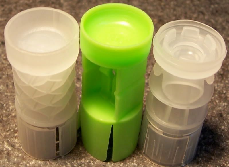

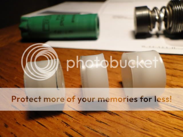

Left to right: CB-6100A, Bossi wad used in factory Rios, HelarcoUS VP-13:

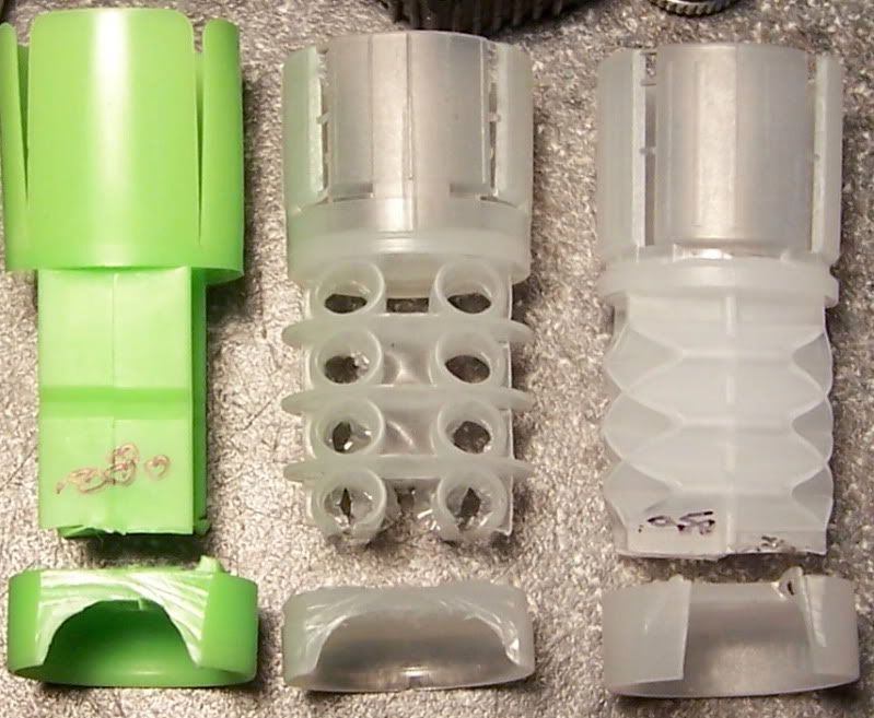

Left to right: HelarcoUS VP-13, CB-6100A, Gaulandi GU-1225:

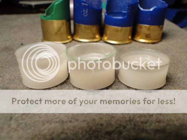

Left to right: CB-6100 in the Fioochi (orange), CB-6100 in the Rio blue:

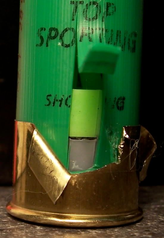

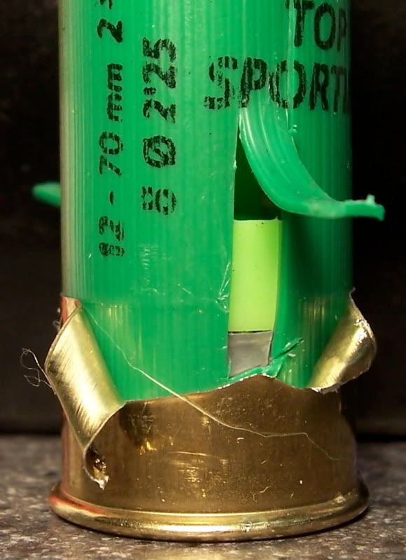

Rio hull loaded with denser Clay dot powder causes power cup to get canted/cocked:
Rio hulls with 20.0 grains of Hodgdon's Clays gets the power cup off of the base wad:

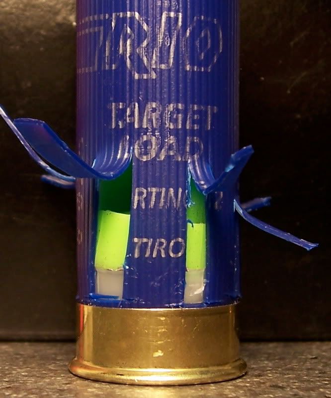

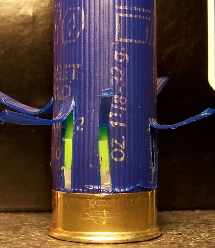

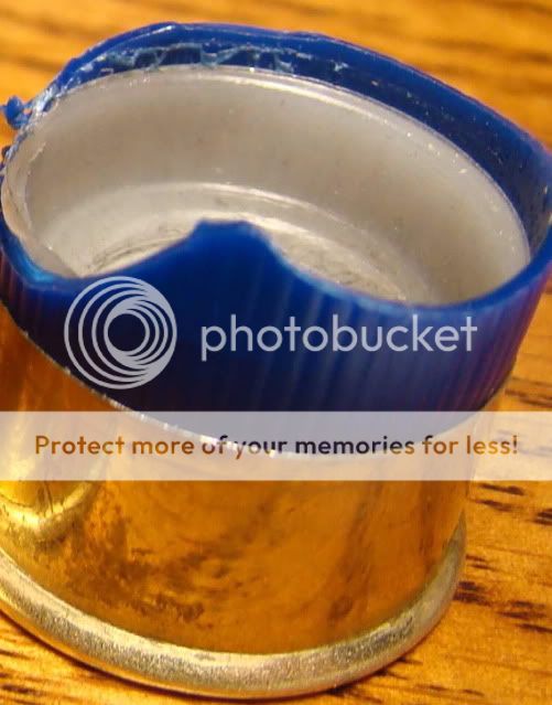

Also notice that the Rio factory hull and it's Bossi A41 wad is manufactured with with the lip of the wad's powder cup just off of the lip of the base wad as well:

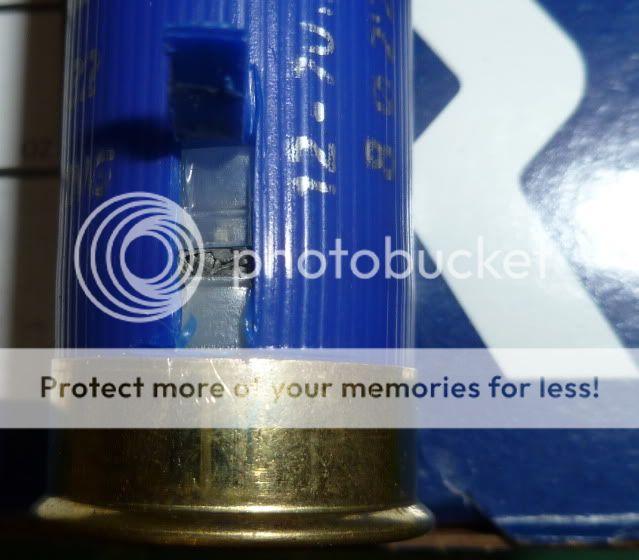

Another note (about Rio's in general), is that it appears that the hull tube used in the newer style Rio's (new style blue and brown box) are now unmarked. I'm not sure if this is a regular pattern, but that's what it is of late. I think someone else is now making the hulls (which, as junk hulls go, appear to be a tad bit higher quality than previous ones).
