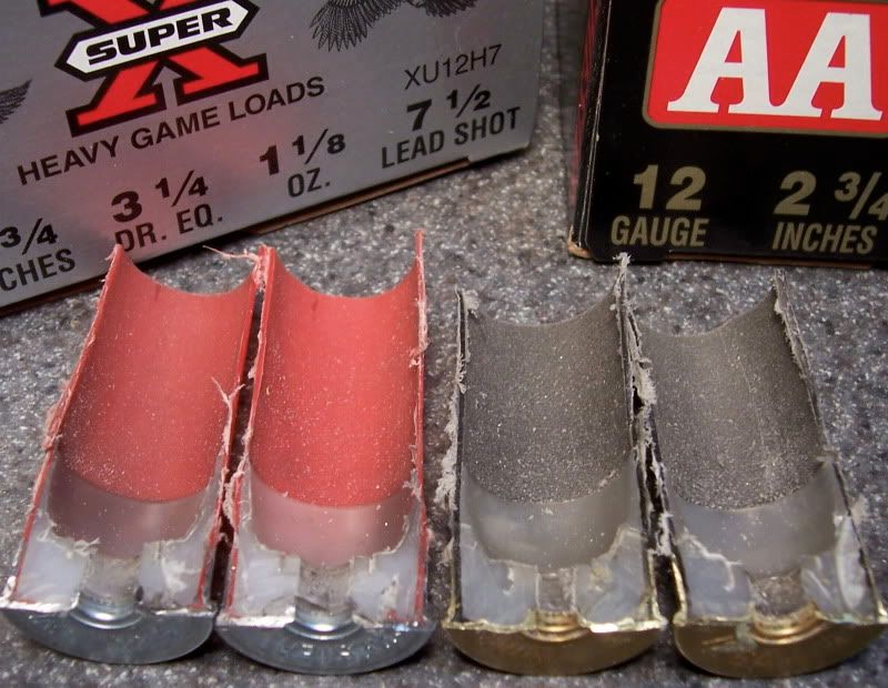

I sliced a 12 ga 2 3/4" Winchester Super Target in half and it looks the same as the Winchester HS illustration in the Lyman 5th ed., except it has a white base wad instead of red. I know the Super Targets are not the best quality hulls, but am I right to think it would at least be safe to substitute once-fired Super Targets with any recipe for AA compression-formed or HS hulls? Thanks.

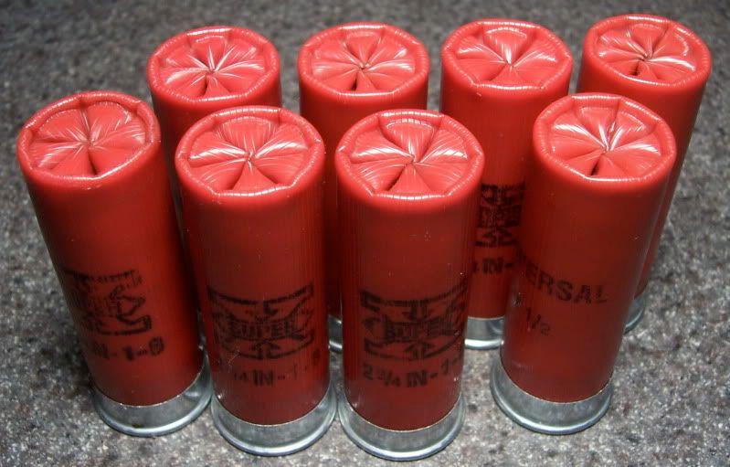

Crimpability of a hull has more to do with component selection and press adjustment than it has to do with the hull type, - be it a Federal promo, Fiocchi, Rio, or Winchester Universal or Super-X....
And just as you discovered, the internal contour is identical to that of a AA HS:
However, the base wads are different in that the base wad in the Universals and Super-X's don't have the additional external sealing barbs on the outside like there is on the AA HS's:
I read the text/context of the Winchester memo differently than some here do, - it says that they "don't consider them reloadable", - no where does it actually say to "NOT" load them, or that they do "NOT" recommend loading them. In fact, the word "recommend" doesn't even appear in the memo (nor does the word "NOT"). The word "recommend" is a term being attached to, and "inserted" into this subject by certain posters in this forum.
But, reloading of the Winchester Universals, and Super-X's is probably not something that a newer reloader should be doing anyhow, - it should be left to the more experienced reloaders. Simply put, if you have to be asking about them here, then you probably shouldn't be reloading them, at least that's the advice that you'll most likely always get from some posters here in this forum, of which, isn't necessarily bad advice. You don't need any single concrete, or "documented" reason for not wanting to load them, as none exists.

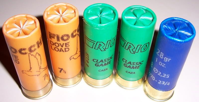

I shoot them out of autoloaders, and pumps, and I do not check my barrels. I load Rio's, Fiocchi's, and Super-X's and Universals.
After that, yes, crimping quality will be your main concern, specifically component selections. With the thinner hull tube plastic, it makes component selection and press adjustment more critical in that they are less tolerant to loads that require any amount of wad pressure, and/or less than optimal press adjustments. The loads that you see pictured above required no press adjustment whatsoever when switching between reloading Remington STS's and Gun Clubs and the Rios, Fiocchi's, and Universals/Super-X's. Only the components were changed.
There is no reason to expect that these won't shoot just fine for you if you are able to get them loaded and crimped correctly.

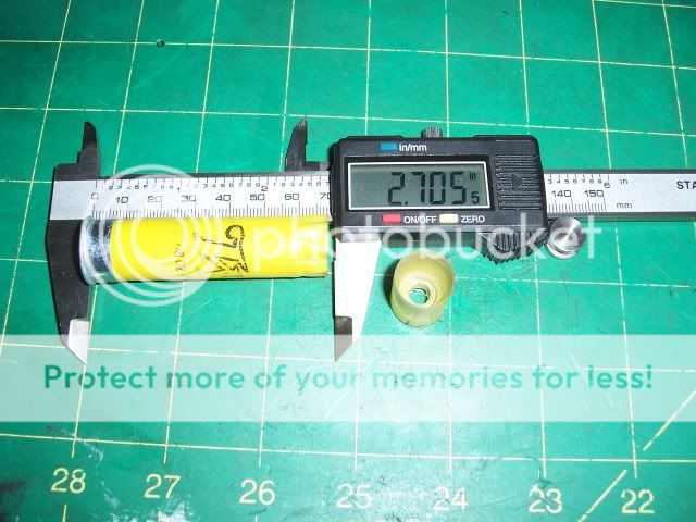

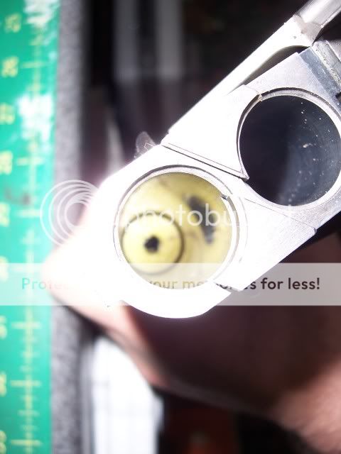

Ok, so if I understand this correctly now, you are saying that you had the sheet metal headstamp with the base wad still in it in one hand (as pictured below), but the empty, hollow yellow tube still in the chamber, is that correct ?
So where I have trouble with this is, is the fact that the base wad is crimped in the hull tube with the edge of the tube molded and folder over the bottom edge of the base wad as shown in the above photo.
I just don't see how the tube can pull away, overcome the folded over portion of the base wad without it (the tube) taking the base wad with but leaving the base wad floating unsupported and only hanging to the metal headstamp by just the primer (which doesn't take much force to separate).
I also wonder why it is that an empty, thin wall hull tube would remain in the barrel, - what was holding it in there with enough friction much force that a rear-ward moving base wad wouldn't pull it all of the way out.
Lets say for the sake of argument that, due to a Q/A problem, the folded over lip shown above didn't get folded over the base wads on the batch of shells that you got. In my tests here (and reference the included thread link in my post above), I find that the base wads in the AA's, and Super-X's has SO much of an interference fit in the hull tube, that even if there were a mere 1/8th inch of the top of the base wad still in the hull tube, it's takes many MANY ounces (pounds in some case) to get it to pull loose from the hull tube which is still in the chamber.
Further that QA/manufacturing problem to envision a situation that maybe only 1/8th inch of the hull tube was under the sides of the metal head stamp (extreme worst case scenario). That still puts well over a half inch of the base wad still in the tube! I don't see it possible that the friction force of the primer holding the base wad which is floating freely in the head stamp to pull the base wad out of the hull tube.
Maybe it's an ignition thing, maybe it's a gun thing, I dunno know. Maybe it was an autoloader (configured for full automatic?) where the mechanism is/was trying to pull the hull out while the shell is still under pressure and in the middle of ignition.
There's just too much information missing from your account to speculate any further. It's also reasonable to think that the folks at Winchester would also want to know all of the details surrounding your situation, but it's also not unreasonable for them to just send you some free shells to shut you up, and make your complaint go away too.
But you did the right thing by contacting Winchester. Although, photo's would have been nice.
 Post subject: Re: Winchester Super Target = AA HS?
PostPosted: Tue Apr 19, 2011 3:05 pm
Joined: Fri Feb 13, 2009 3:34 pm
Posts: 403
Location: Fort Worth, TX
It surprised me, too. Nonetheless, that is what happened. The end of the tube was square, with a very slight curl to it, as if it broke at the point where the crimp over the base wad began. I can think of manufacturing issues that would weaken the tube there. The gun is relatively new with only a few hundred rounds through it. No problems with any other shells. I was also surprised that the tube slipped so easily out of the chamber when I pushed it out from the muzzle. I really expected to have to exert some pressure, but didn't have to use much more than the weight of the aluminum rod.
Sorry I didn't take any pictures to relieve your worries. :lol:
