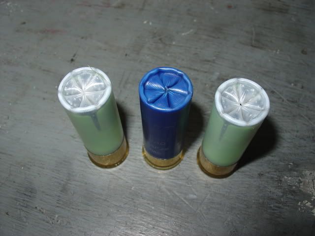

Crimping new pre-primed skived hulls on a MEC is easy, fun, and no preparation is needed. Just take your pick on the 8-pt starter, or the 6-pt starter. I sorta lean towards the 6-pt starter, but done probably as many 8-pt. I don't have a Hornaday, but I just can't imagine it being any different.

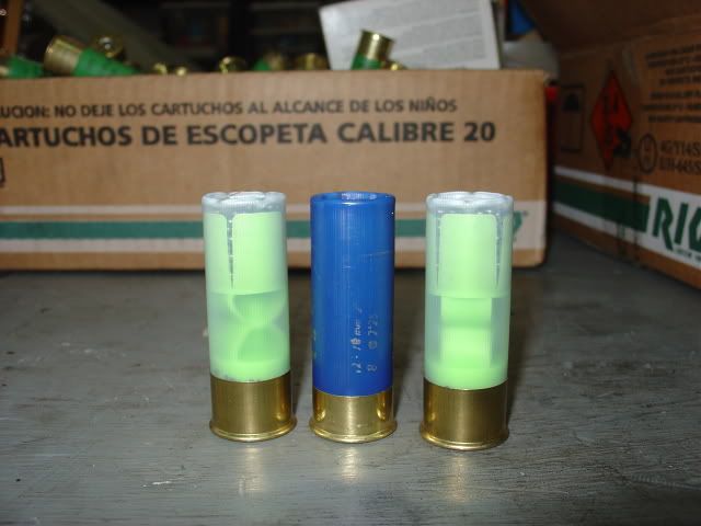

If the cost is on your side, then give her a whirle. I got into loading those Fiocchi and Cheddite multihulls because I got a bunch of them at an estate sale. The pre-primed Fiocchi's seems a tad bit better than the pre-primed Cheddites, but they are both very close to each other, and both would use the same recipes.
For 1-oz, the best wad on the planet is the Gualandi GU-1225 for which Ballistic Products Inc. sells them as the "Spitfire" wad. They used to be affordable, but I'm told the price has gone thru the roof. A more affordable wad would be the Claybuster CB2100-12 (12S0 clone), and their newest CB6100-12 Winchester-style wad with a powder cup designed for Euro hulls. I'd stay away from the Downrange DRF0/3 as they have undersized powder cups, and they won't seal correctly in straight-wall hulls.

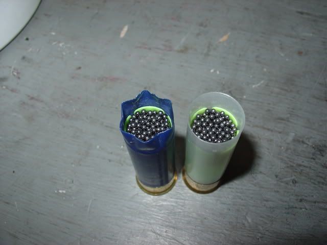

1-oz of shot in the Claybuster CB6100-12 in those hulls when compared to a Rio hull:
I load 20 grains of clays in 1-oz, which is a little hot, but I also load them for a Benelli Cordoba which needs a little extra moxie to cycle the Inertia-driven action.

Thanks for your input, and thanks especially for the pictures. I can do 6 point crimp, I have the starters, and 6 pointers have never bothered me.

Nothing like new crisp clean 6-point crimps and a bag of zero-fired pre-primed hulls!
Much like you, I too was fretting over how to put the initial crimp on them babies. But to my total amazement, - I just ran one thru my MEC 9000 with it's measly little plastic crimp starter cup, and Badda-BING they came out nice.
Just give a holler if you'd like to try some Gualandi GU-1225's, the CB2100-12, or the CB6100-12 wads, - I got some here that I can send you as samples if you are interested. Just send a PM.
