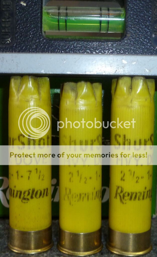

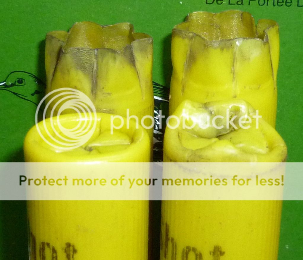

D L Marcum wrote:
THe Gun Clubs and the Shur-Shots use the same cases, which are the Rem.SP case, and is one piece.
Beware of the Shur-Shots, they aren't always exactly the same as the Gun Clubs, and there are some of them floating around out there that are quite a bit longer than other hulls :
And they very quite a bit among themselves :
Failure to identify, and sort/weed out the long ones will result in nasty wad tear-thru's at the shot-drop station, and some nasty hulls should they make it thru without a wad tear-thru. As shown, the short ones crimp fine.
Since there's no easy way to identify the longer Shur-shots, I don't even mess with them anynore, I don't pick them up, and throw out any that I accidentally pick up. Gunclubs and STS's, yes, but Shur-shots get the big: No Way Jose.

Cerberus,
Those Shur-Shot hulls come with both 6 and 8 fold crimps. The longer ones are primarily in the 6 fold crimps and seldom in the 8 folds.
Therefore it is prudent to pick up all Rem. hulls with the 8 fold crimp. I load them all the time without a hitch, and intermixed with Gun Clubs.
The 6 fold hulls will have the longer hulls intermixed within the same batches. However, about 2/3 of them are not over length. When these hulls are plentiful, it is worthwhile to cull out the long ones and use the rest. Sometimes these are the only GOOD hulls available as pick up hulls.
You can also save the long ones until you get a large batch of them. Say 500 or more. Then you can adjust the press for these hulls and load them very satisfactorily.
For some people, throwing away good quality hulls is really not the best program. Batching them according to length works fine.
DLM
