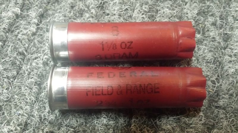

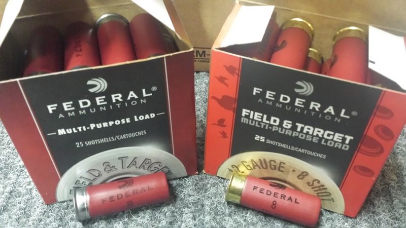

Not sure if your post is intended to sound snarky, but in either case, here's a view of a couple of the ones that are currently "out in the the wild".
In this picture, you'll see both of the "current" ones, though the ones on the left are now being replaced with newer ones shown on the right.
The ones on right are the "Rio" hulls, and as I mentioned, trying to put a standard 209 primer will result in a mess. If you've found a way around it, great! For others, trust me, or try it for yourself and make a mess.
In this picture, you'll see two "flavors" of the labeling that goes on with similar hulls, (both came in similarly labeled multi-packs...) some hulls are labeled as "Field and Range" and others with just the Federal name, "dram equivalent", shot size and weight. By the way, you can happily dry your "tears", because BOTH of the above hulls ABSOLUTELY have paper basewads, so... um, I am not sure what you are "laughing and crying" about.
The Rio hull pictured on the right in the other photo (with the brass/copper washed steel base) DO indeed have a plastic basewad - and WILL NOT take a standard sized primer as is.
