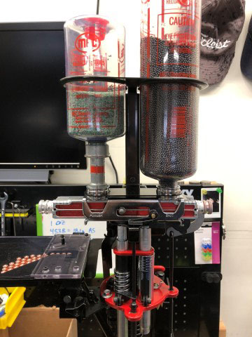

The 9000E is a great fit for my use case. I could set it for my standard load and not worry about how easy/hard it is to adjust, it’s powered to crank out my standard load, it’s portable and doesn’t require mounting to a bench so I can bring it to my friend’s house or my summer house as needed. And best of all I get the press and automate unit for LESS than just the hydraulic unit for the Spolar. So I ordered the 9000E from Gamaliel right before Christmas. I also ordered some accessories which I’ll share my thoughts on later in this post.
Initial Set Up
The instructions were confusing at first. I received a generic 9000GN manual as well as a generic Automate manual. There were steps that did not make sense – for example, the first step in the automate manual involved removal of the handle which I didn’t have. Buried in the paperwork (along side catalogs, price lists, hodgdon powder guides, etc) was a single sheet of paper that were really the instructions. Do steps 1-3 in this manual, skip 4-6, then go over to the other manual and do steps 5-8, etc. Minor nit but this sheet of paper should be better marked in my opinion.
Before I mounted the press to the automate unit, I took the opportunity to install Republican’s excellent MokeMate unit. I opted to go for the “inline connector” version, in case I need to revert back to stock for warranty work. The installation was easy thanks to the excellent videos he has made available on you tube.
Here you can see the foot pedal down below that operates the press.

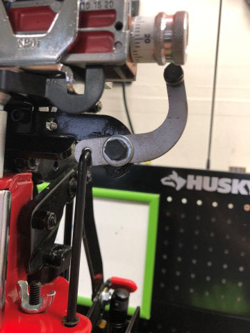

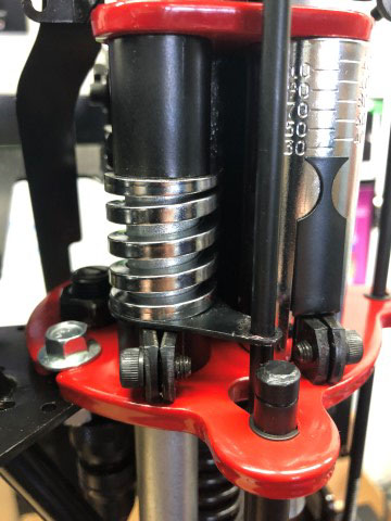

The second and more frustrating issue was that the charge bar lock was not operating consistently. In many cases it would not unlock, even with a shell in station #2. I did adjust the power drop tube per Curly’s instructions to measure how much compression was put onto the lower primer spring which operates the trip rod bracket). No amount of adjustment would allow the trip rod to operate consistently. I even tried greasing the rod/contact points to perhaps remove some friction. Didn’t work.
After a LOT of frustration (not to mention spilled powder and shot), I took it apart and realized that the trip rod was bent. Not sure if I caused this or it came this way from the factory. Ironically this is one of the few pieces on the press that is hardened steel (I think). I ordered a new rod from MEC and since then the charge bar lock is operating as designed.
Now that the charge bar lock was operating, I ran into a third issue. Occasionally the press would not drop shot, even when the bar was unlocked. It turned out that the Charge Bar Actuator was binding.
As you can see I have the adjustable charge bar installed from Multiscale. It needs a replacement actuator to operate, which is installed on my machine. (the silver L shaped piece above). The strange thing is that the Hex screw actually screws into the base (behind the L shaped piece). So as the press operates the screw itself is tightening up. Eventually it gets so tight at the actuator binds and the charge bar doesn’t complete its stroke. For now I just stuck a washer there, it seems to be working – maybe 300 shells loaded and it has not tightened up yet. If that doesn’t work I’ll probably use one of the extra nylon nuts that were included in the press and just not tighten it all the way.

    2) I’m not a fan of the bottles. They seem flimsy, prone to breaking at the neck, and are harder to refill.

Reinforced Bottle Bracket
Worthless in my opinion, a waste of money. The holder is too tight for the powder bottle, which prevents you from easily removing it. And it is too loose on the shot bottle, so doesn’t provide support at all. I ended up wrapping some electrical tape around the shot bottle just so that it would contact the bracket. I might just remove the whole bracket.

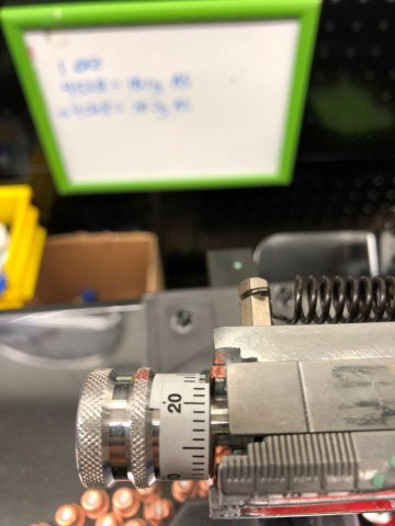

Adjustable Charge Bar
I ended up buying all of the bushings for my Spolar just because I’d rather have them around when I need them. There are many times I thought why can’t there be an adjustable powder drop system for the spolar? Adjustable powder drops are pretty much standard for metallic reloaders.
Multiscale makes an adjustable shot and powder bar for the MEC. Reviews are mixed on the internet. Some folks say that it works great, others say that it is consistent. I took a chance and ordered the adjustable bar. The unit itself is not that impressive to look at. Looks roughly machined, and the worst is the haphazardly applied scale stickers on the adjustment knobs. The unit comes with three inserts that must be applied – two plastic ones (for steel shot and hunting loads), and one zinc one for lead target loads. On the zinc insert the instructions say that if the fit is not good then please file the insert until it fits. Not the most reassuring sign of quality construction.
However, the unit itself is providing very consistent powder drops, especially when used with the metal baffle that it comes with. I think you have to follow the instructions carefully – the metal baffle still needs a brass washer and rubber bushing (unlike the plastic baffle which is designed to ride on the charge bar directly). Secondly, to make adjustments to the bar you have to first turn it clockwise PAST the desired setting and then reverse direction to tighten it to the desired setting. After following these directions I am able to get very consistent powder drops, with the majority spot on. If I’m off it is usually only by .1 grain.

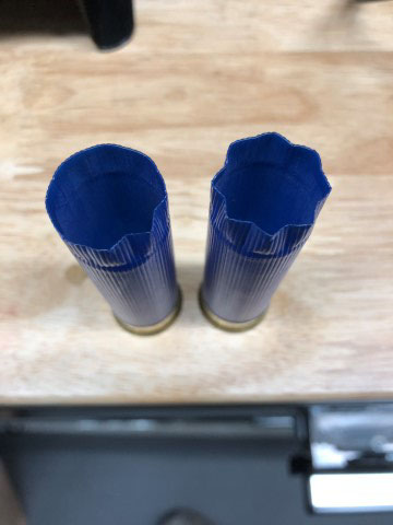

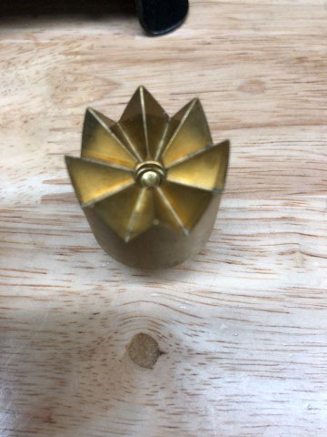

BPI Super Crown Crimp Starter
I’m loading a lot of new, unfired Rio hulls. The basic crimp starter from MEC does an OK job of making the initial folds, but they are not sharp. The issue shows up upon once-firing and attempting to load the hull again. Because the initial folds were not sharp, there is no fold memory and the hull looks like the hull on the left. When attempting to reload the left hull it will occasionally result in an ugly crimp. The hull on the right was pre-crimped with the BPI Super Crown.
The BPI Super Crown is a heavy, and sharp brass crimp starter. It does a MUCH better job of making the initial folds in new hulls.
Notice how much sharper the edges are on the right compared to the rounded folds on the left. With the BPI super crown the hulls retain their crimp memory after firing resulting in perfect second loads. Kinda pricey, but I’m happy with the results.

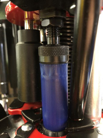

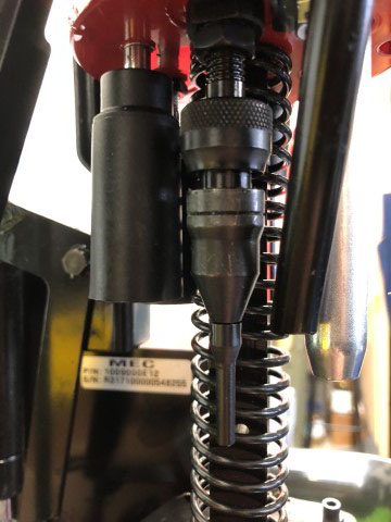

Creative Reloading Solutions Ultimate Primer Punch
Thanks to a post on this board I learned about the Ultimate Primer Punch from Creative Reloading Solutions. The punch itself is VERY nicely made, a quality tool. You can tell a lot of thought was put into this punch. The punch has a couple of features that I like very much:
    1) Easily removable tip. The punch comes with two tips: a standard primer punch out tip, and a primer hole reconditioning tip. It can also be run without a tip which is useful for me when I load new pre-primed hulls.
    2) An adjustable mouth flaring segment. You can easily spin this up or down to adjust the amount of flare on the hull mouth. In the pic below you can see that I’m just giving the hull mouth just a tiny amount of flare.
Is flare even needed? For me I say yes. Before I started using the new punch I got a couple of crashed wads and more concerning cocked wads when loading new hulls. I don’t know if there is something different with new hulls that causes issues. With the tiny amount of flare these issues have been eliminated.

mtgrs737 wrote:
Glad I could be of help, If you install the lock/jam nut on the back side of the bracket that the pivot bolt for the "L" shaped pusher arm for the powder/shot bar you can remove the flat washer. Good luck and enjoy your 9000E.
Actually the nut is there on the back side of the bracket. What's happening is that each activation of the pusher arm is tightening the screw/nut slightly. After many activations it gets so tight that the L pusher arm binds against frame blocking the charge bar from completing it's cycle.
The washer made no difference, I have since removed it. Right now I just have the nut on fairly loose. I haven't loaded enough to see if it will jam again. If I tighten the nut finger tight then in about 20 shells or less it will tighten up completely and bind.
any suggestions would be most welcomed.
thanks!
 Post subject: Re: Some thoughts on the 9000E and add-on accessories
PostPosted: Mon Jan 01, 2018 8:30 pm
Posts: 21494
beetle wrote:
thanks!
This is a trial and error situation.
Tighten the pivot bolt down until it starts to bind the actuator arm. Loosen the actuator bolt 1/4 turn and hold it in that position while tightening the jam nut on the back. Check the actuator arm to see if it has any bind.
If no bind, leave everything alone.
If binding, put a wrench on the hex of pivot bolt, use a wrench to loosen jam nut behind the bracket.
Loosen the pivot bolt about 1/8 turn, hold the hex of the actuator bolt with a wrench while you tighten that jam nut on the back of the bracket. Repeat as required. No more adjustment will be required until you replace the actuator lever. Then you will have to repeat the adjustment again in the same manner.
PostPosted: Mon Jan 01, 2018 9:01 pm
Joined: Sun Jul 15, 2012 10:26 pm
Posts: 103
thanks curly, I've made the adjustments as you recommend. I think it's going to work. I've run the machine several times, and unlike before the it doesn't seem like the screw/nut is self-tightening. Will test it the next time I load a bunch of shells.
I'll stand by my original assessment -- one of the best things about the MEC is the wealth of knowledge available :)
Thanks again and Happy New Year!
