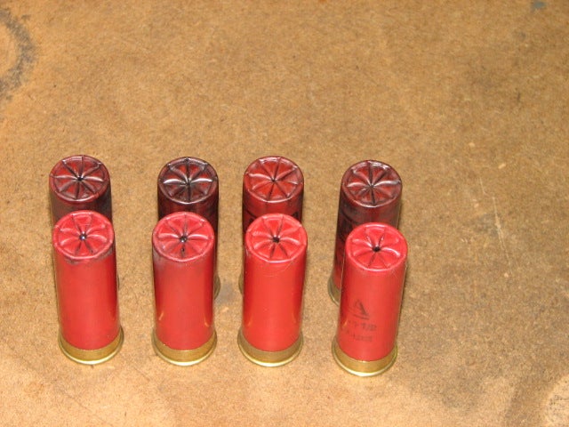

Easy, and it due to Win using spherical powder for the 12 gauge loads, came up with the perfect pressure powder amount they had with the standard win wads, and just shorten the hull to get a perfect crimp. So the 12 gauge HS hull, are shorter than the CF and STS hull. Hence if you have the 12 gauge machine set up for CF and STS hull, but swap to HS hulls, your going to get a center hole in the crimp, until you adjust the pre-crimp, the sizer, and the taper crimper down to resolve the HS shorter hull problem.
CF hulls in the back ground, HS hull in foreground, and the machine is still set up to load the longer hulls (CF and STS hulls).
Note, slinging the cat to see if it will stick to the wall king of thing in regards to why the HS hull are shorter than the CF and STS hull lenghts that were the standard for decades. It may be that the new machinery was set up to cut the hull shorter to start with, but really believe that is was the HS hulls that have slightly more volume than the CF hull of the same length, and why the hulls where shortened in the first place (to get ideal crimps with the standard win wads, without the shot rattling too much). This way same standard wads cold be used for both the older CF and new HS hulls.
