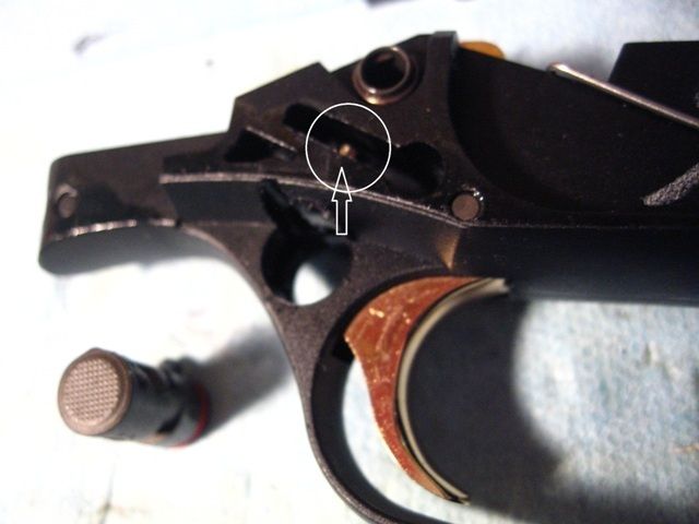

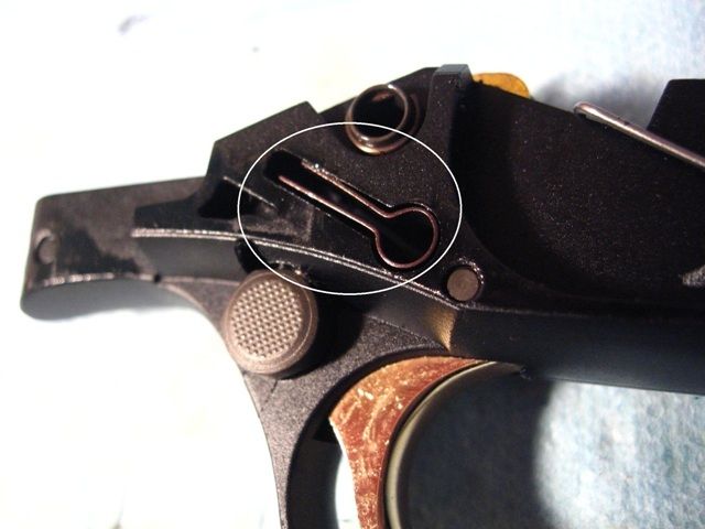

During the initial cleaning I converted the safety to LH, no problem. Then I shot the gun with the turkey choke at 16 yards. All targets shot showed the same thing; High and Left.
