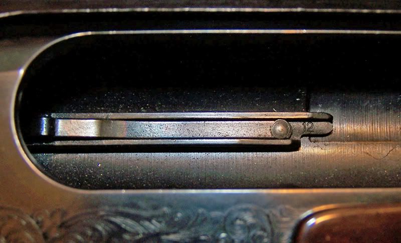

I really like the 870 and want to learn all I can about it. With that in mind, I want to be sure we're all talking about the same part. Is this it?(the thing inside the receiver with the 12 on it)

Yes that is it. The ejector broke right where the 12 is. Rastoff, thanks for posting the picture i should have thought of that...
Doug, Sorry about the squared off wild goose chase. I was confused about what the gunsmith was telling me. Am i safe to assume that it just needs a regular 870 ejector and i should be back in business? Would it be the first one in your previous post?
