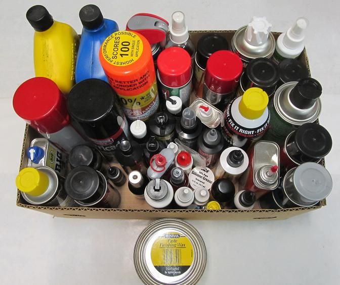

Now to the incredible offer I spoke of earlier. Here is the box containing all the products evaluated. I will send all of them to you so that you may conduct a test or evaluation of your own and I will do so under 3 conditions.
1. You generate a set of criteria and methods by which you will evaluate each product that demonstrates real world “actual” conditions that are not “contrived” and that treats all products with equity and you publish in advance that info for review to this community.
2. You video and photograph the design of experiments and publish your findings to this community on par with what I provided.
3. You send me a security deposit in the amount of $512 (US dollars) that I will hold and return to you upon receipt of the products back to my address to cover what I spend securing the products.
I can think of no better way to gather additional data on these 46 products than to have another evaluation done by yet another reviewer using different methodology and criteria that better represents real world applications.
We can exchange mailing addresses via PM
