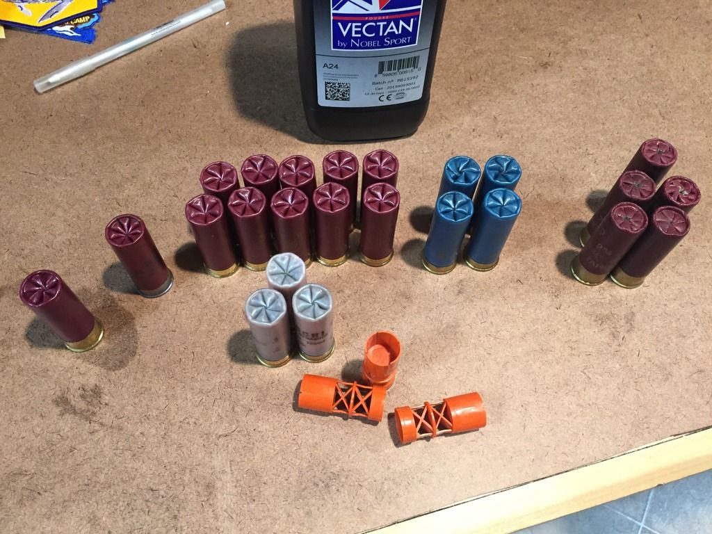

Well, received my order from Grafs. What a great deal that 10 bottles and free Hazmat! Loaded up a variety of straight walled hulls, 19 gr A24, NS 209, DRXXL Orange, 3/4 oz #8.

The above all shot rather nicely. Alas, I'm not equipped with any chrono gear....
