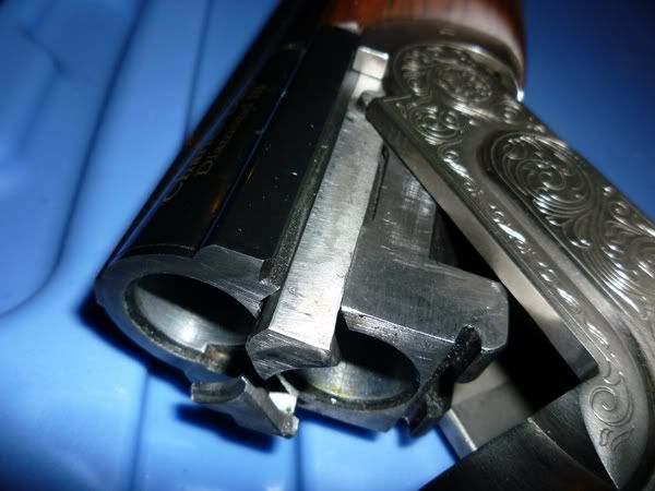

Here are close ups of one side and the underside of the receiver. Engraving is very clean and crisp, and the silver finish is very nice. The NRA badge is very tasteful as well and not overly large. Note the dark smudges are oil; I did not clean this gun prior to taking these pics.

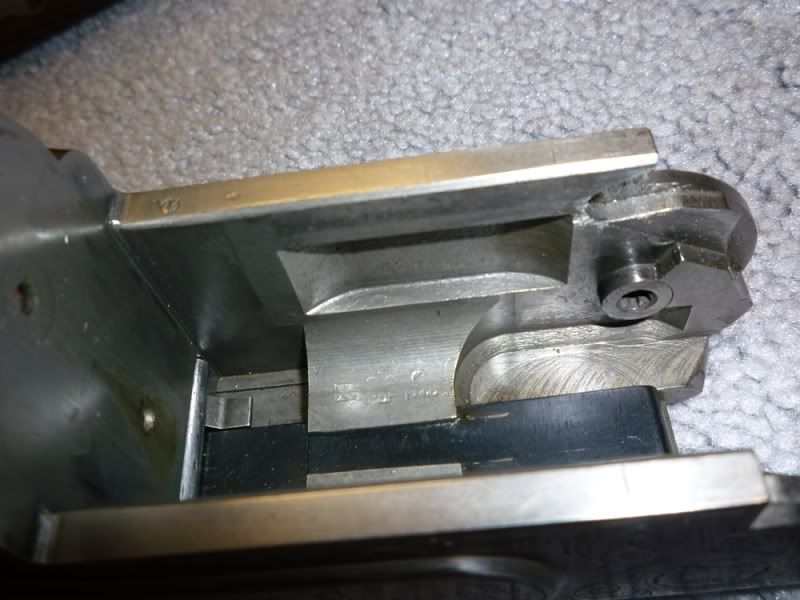

Here’s the inside of the receiver. There are some tooling marks as you can see, but nothing major in my mind. But, thought I’d show the inside of the receiver.

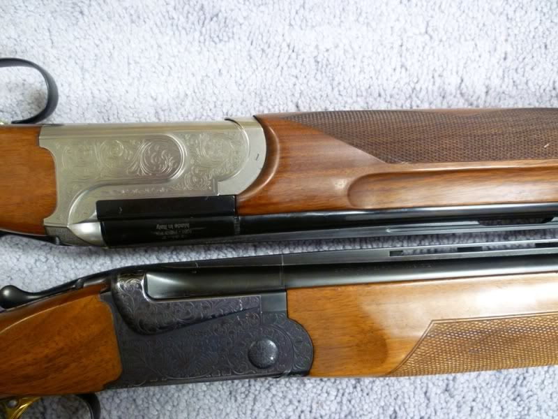

Here’s the gun assembled, next to its new neighbor (an older SKB 500). Note that the CD’s wood is darker and more red in tone. I was happy to see that. The CD, in my mind, has nicer wood than the SKB in terms of color and grain. There’s a couple pics here of the two side by side.

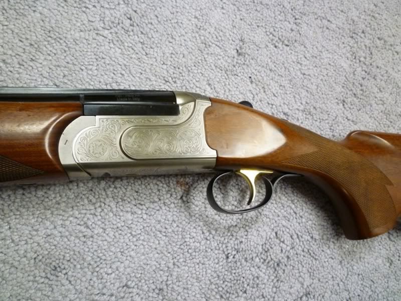

Here’s some close ups of the wood on the CD. The checkering is very sharp, very clean, and perfectly executed. In fact, I’m sure this is laser checkering as there are not tell-tale slight imperfections as often seen on hand checkering. In short, I’m very happy with the checkering on this gun. The buttstock wood is ever so slightly lighter in tone than the forearm. Not sure if you can tell by the pics, and it’s subtle, but it’s there. It doesn’t bug me a ton, but it is something I noticed.
Here’s a couple pics of either side of the receiver. Note that the wood is slightly “proud” of the receiver on both sides, and it’s slightly more proud on the right (or starboard) side of the gun. Not much, but again it’s there. It doesn’t bug me and many people may not notice if they weren’t specifically looking for it. Fit to metal is in general well executed. It’s not a perfect match, but it’s about what I’ve seen on other o/u guns such as Brownings, Franchis, etc. that I’ve seen in stores lately. Essentially, it’s what you’d expect from a standard grade firearm. I will say that I was somewhat concerned that the Charles Daly name on the barrel would be somewhat garish and amateur looking, but it’s not. It’s a subtle gray/gold tone and it’s not as outlandish as I had feared it could have been. In terms of metal fit, barrel to receiver fit is very tight. It takes some force to completely close the gun, but it’s not difficult by any means. It’s also tight in opening, but not overly so and can easily be opened keeping the hands on the grip and forearm without having to change grip for leverage. The forearm is a tight fit on the barrel and requires a slight “bump” with the palm of the hand to fully lock into place, but it doesn’t pose any problems removing or installing. Not shown in the pics is that the midrib is not solid under the forearm, but this is not a big deal as you never see it and likely adds some weight savings.

I also wanted to see how this gun compared to my SKB. Initially, I can tell you it feels heavier and more muzzle-weighted than the SKB. It also feels slightly taller in the action and the drop feels different. So, I took some measurements to be sure. The drop on the SKB stock is 1 5/8” at comb, 2 3/4” at heel. The CD measured 1 3/8” at comb, 2 1/4” at heel. Please note there were some imperfect variables involved here, but the fact is the CD has a higher stock in relation to the sight plane and it feels that way as well. On the SKB, I’m looking down the barrel. On the CD, I’m looking somewhat over the barrel.
In terms of weight, I did not weigh these guns myself. But, specs on the CD show it coming in at 8 lbs, 1 oz. Specs on the SKB show it coming in at 7 lbs, 12 oz . So I’ll believe that because the SKB does feel marginally lighter.
The action on the SKB felt shorter, and my measurements shot it being 2.428 inches in height. The action on the CD measured at 2.558 inches. Again, measurement justified feel.
With balance, the SKB balances right on the hinge. Smack dab. The CD with choke tubes installed balanced approximately 5/8” in front of the hinge. However, with the tubes removed, balance shifted to right under, or ever every so slightly, in front of the hinge. It’s important to note that my SKB has Briley Thinwall chokes installed as an aftermarket mod and the CD has the typical factory “bulge” at the end of the barrels and standard thick chokes, which would explain the difference in balance point. To me, the CD felt more like a Citori in terms of balance (the 28” Citoris with choke tubes that I’ve picked up have all felt somewhat muzzle weighted).
So, in conclusion, the CD in my mind is nicely finished with nice wood, checkering, and appears to lock up tight. Bluing, engraving, and overall finish are well executed. It feels heavier than my SKB and balances somewhat differently, but that may not be a bad thing if I’m going to be busting clays for any length of time. I’ll be interested to see how the differences in drop with the stock changes POI vs the SKB, if at all. The gun has some flaws in terms of fit/finish as I’ve outlined above, but I can live with all of these and not be bothered at all by any of them as long as it turns out to be a good shooter. And, the photos I’ve posted are accurate representations of what I’ve outlined, so you can see whether issues like this are a “big deal” in your mind or not. Finally, I’d like to note that observations were made in my basement after the kiddies went to bed using whatever was available (for example, the balance test was conducted balancing the gun on the edge of a Thomas the Tank Engine play table… which is about ½” in width). As another note, I had an opportunity on a business trip recently to look at a couple Classic Doubles shotguns that were also made by Marochhi a few years back, and this gun was almost identical to the Classic Doubles Model 90 I looked at except the Classic Doubles gun had a schnabel forearm.

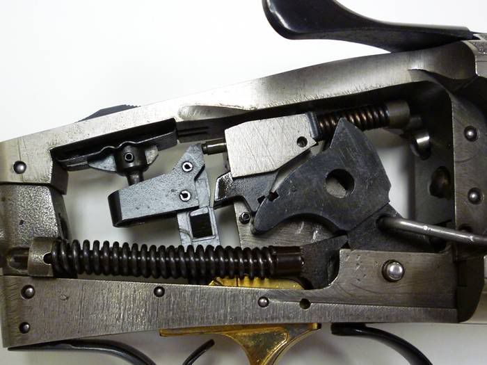

Here are pics of the inside of the forearm and the ejectors.
As a side note, I have a couple old 1993 and 1994 Winchester catalogs that show the Winchester 1001 shotgun. The receiver, including every piece of engraving, trigger, etc. and checkering on wood is 100% identical to the Charles Daly Diamond III. The only small differences I can see are some markings on the barrel which makes sense since the problem with the 1001 was the barrels. It's safe to say that since both the CD and the 1001 were made by Marocchi that these are the same shotguns.

Thanks for the pics , very nice. Looks to be built very well. Nice wide ejectors, thats good. NOW before you open and shut that gun one more time get some grease on the front end iron where it is rubbing on the receiver and those hinge pins. I can all ready see marks on the front end iron. You don;t want to gall the metal!!! Also put a few drops of oil on the top lever where it goes into the receiver, and a little on the ejector channels. Also put a dab of grease on the end of the cocking bar, thats the one coming out of the center of the front end iron. It pushes on that flat bar in the bottom of the receiver. Metal to metal has to have LUBE Enjoy

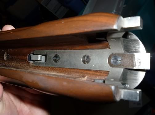

BTW, also, here’s some pics of the internals of my CD Diamond III. I took the stock off to lube up the internals and, of course, followed Dave’s advice on greasing and lubing other parts.
Again, my CD seems to switch barrels appropriately and eject as required.
