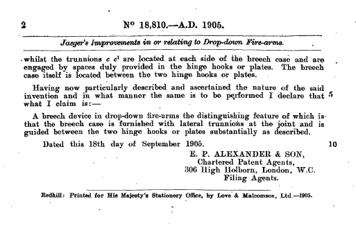

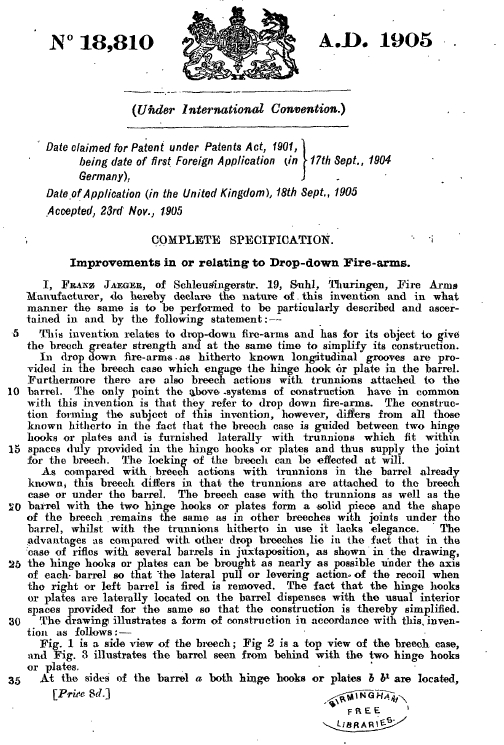

First, the special barrel lugs are an invention of German gun smith and gun factory owner Franz Jäger, Suhl who had two patents on this special arrangement. Shown hereinafter is the British patent No. 18,810 of 1905:

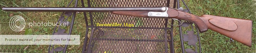

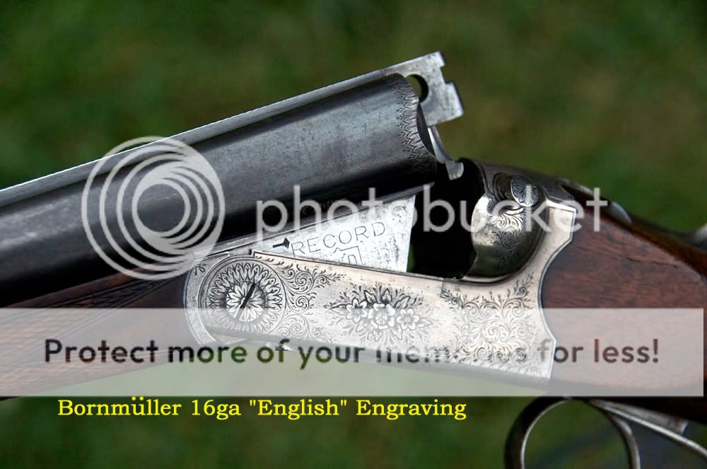

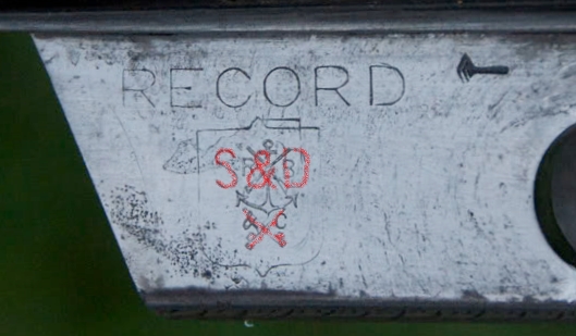

The question now (still) is: who made rlvanden’s shotgun? The trademark of his is quiet different from S&D’s trademark. But after taking a loooooong and close look on it, it seems to me, there are two trademarks present: S&D’s trademark “S & D with crossed barrels” which was over stamped with “R B & C plus anchor and crossed rifles”.
Maybe the brand of R. Bornmüller & Co., Suhl? :wink:
Unfortunately, I wasn’t able to find a registered trademark by Bornmüller, nor any other ad or publication by Bornmüller.

Gentlemen,
I felt free to take rlvanden's image of the trademark and emphasized the S & D and the crossed barrels of the original trademark by S &D:
Regards

Sauerfan is correct. It is the mark of Guillaume Scholberg & Delheid. They were located at Rue Morinval, 24 in Liege. They had purchased the business from Joris & Co. They were only around for about 8 years. They registered this trademark in 1906. Guillaume Scholberg was part of a large gun making family in Liege. Before this he was business by himself. He first opened his doors in 1880. He registered at least 10 patents that we know of. The Scholberg family had been around since at least 1860. The Paul Scholberg (maybe his son) was the last of the family in the gun business. His firm continued until 1948 at the same address.

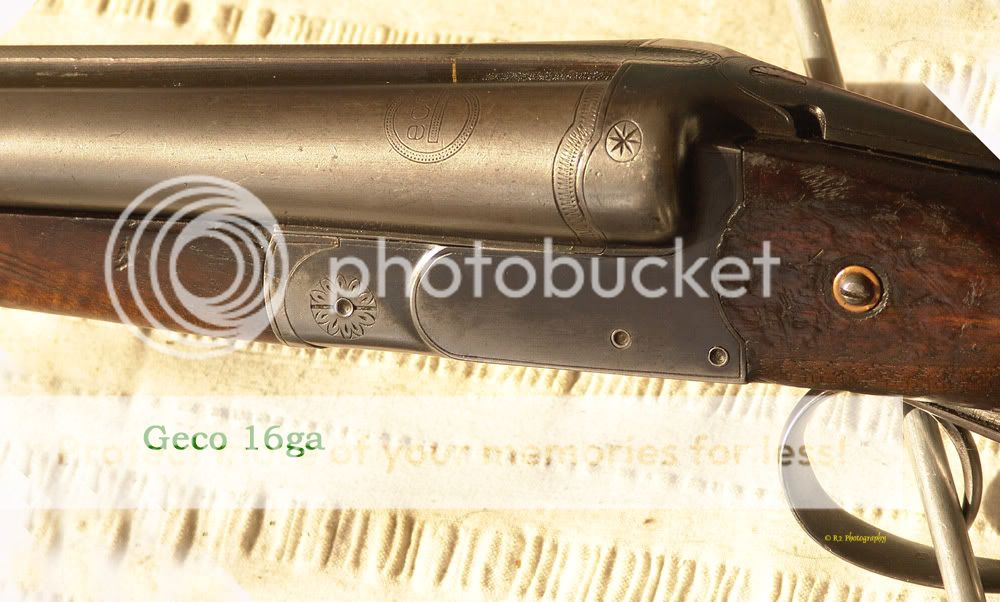

I had the good fortune to acquire the above from rivanden recently. Lovely handling at an ounce over 6#'s, great lockup, and IMO an excellent quality gun.
The receiver bears more than a passing resemblance to my Gecos, my surmise is that S&D may well have bought it from FN and machined it for the proprietary lockup.
The German nitro proofs may well be the result of its having had the chamber lengthened to 70mm, no sign of a repair mark, but definitely already the long chamber when I got it 2 weeks ago. Bore is good, though there is a bit of light pitting ahead of the chamber, not enough for me to worry about, and it's clearly been refinished and had the checkering repointed at some stage of its career. 100 rounds at the trap range without a hitch, though with a new operator and 3/4oz loads of 8 1/2's, I didn't do very well. Have yet to get SxS's down. Chokes are per barrel markings, .025" and .040", when I did manage to get on the birds, they dusted. I'll probably open them right up to around .008"/ .015".
