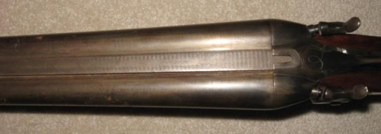

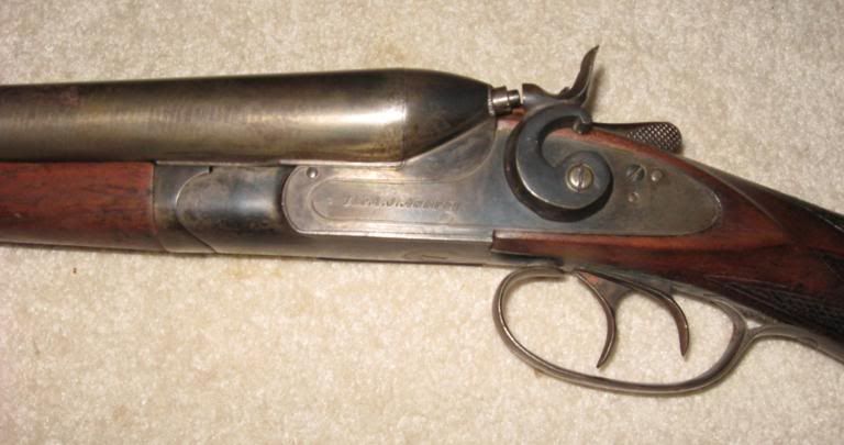

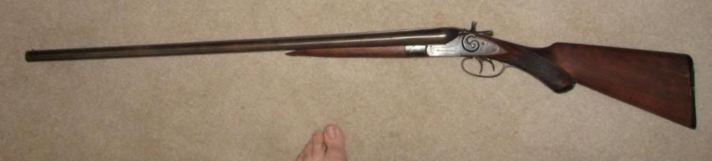

My grandfather gave me his A.J. Aubrey 12g SxS in about 1964: he bought it new in about 1908 (year to be determined), and it was, when I got it, a rusty mess since he'd kept it in the garage. There were hornet nests in the chambers.
I was 14, and hence not exactly a gunsmith, but I took it apart, ground/polished off the rust as best I could, sanded the stock, and patched and refinished the butt plate. I was proud of the result, though I never dared fire it.
Last year, I retrieved it from my parents' home and was astonished: I'd actually done a rather good job on the rebrowning and stock refinishing. The chief defect was in the inexpertly patched and painted butt plate. So now I start over. The plan:
1) Do nothing to the stock. I'm more than satisfied with the job I did 40+ years ago, and I don't want to further alter the 100+ year old wood.
2) Have a gunsmith check the tightness of the action and -- advice here please! -- the Damascus barrel: is it true that internal corrosion is an issue and, if so, is it also true that this can be detected (though not fixed)?
3) If the above inspection proves that it's OK, I'll touch up or refinish the metal.

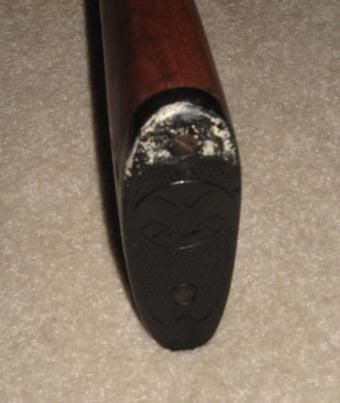

4) And here comes the big one: I won't discard the original butt plate and grip end, but would like to find reproductions that do not reflect the wear of the originals. Does anyone know of a source for these? Or, alternately, is anyone here willing to take a cast?
Details of my Aubrey:
Model: T30
SN: 21xx
12g, 2 3/4", external hammers
The whole enchilada:
A closeup of the action:
Patent inscriptions, etc:
Nasty patches: epoxy and black spray paint:
I thank any and all of you who have more information and suggestions!

What does it say on the barrel rib? You seem to imply something about a patent. Does it say "Applied for"?
According to the serial number you gave, this was a very early gun, 1905-1906. It is a model 82. This was the entry level hammer gun with twist barrels and line engraving that they were selling for $12.59. The barrels should be 30" or 32". If untouched, they are most likely choked full & full.
There are no reproduction buttplates available. Occasionally I see originals for sale on eBay or gunbroker. The last one I saw sell on eBay for $28.00 plus change. Go figure.
There is almost no collector interest in the low grade Meriden hammer guns. They usually sell for $200 to $500. Using a grinder on it has brought down the value. The high grade hammer guns (model 97) are rarely seen. They go for $1,000+ depending on condition.

Thanks for the quick reply! As for the patent info, the inscription reads: "Laminated Steel Mfgd by the Meriden Firearms Co. Meriden CT U.S.A. Pat'd Jy 9 1907". This refers to patent number 859,477:
