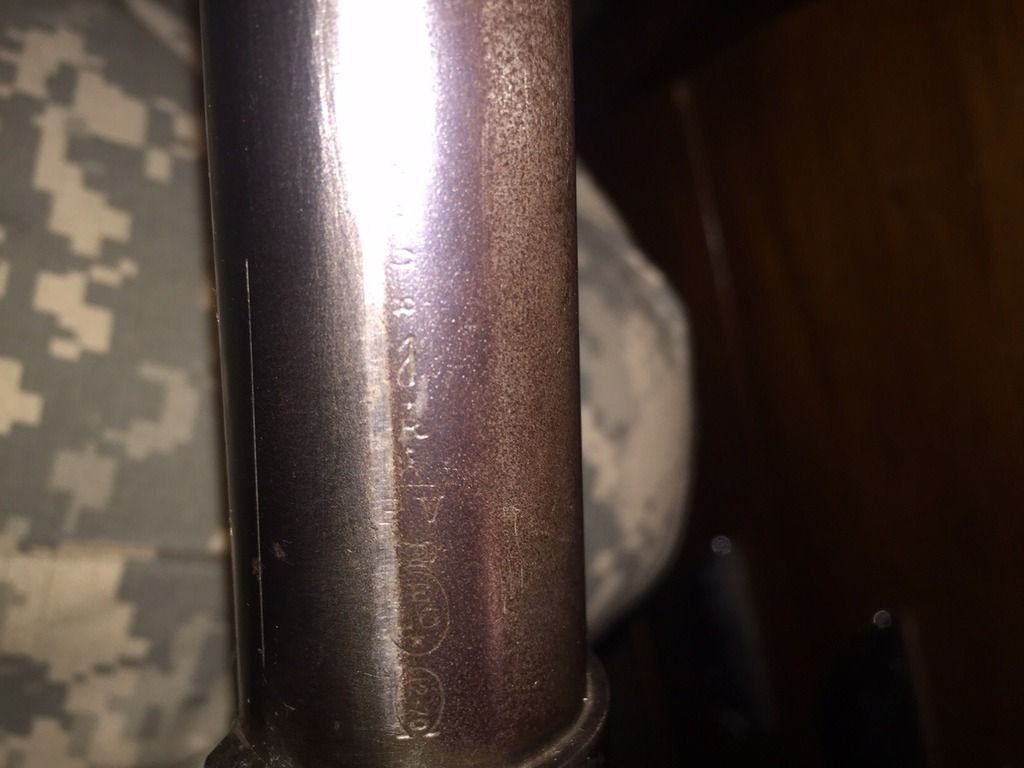

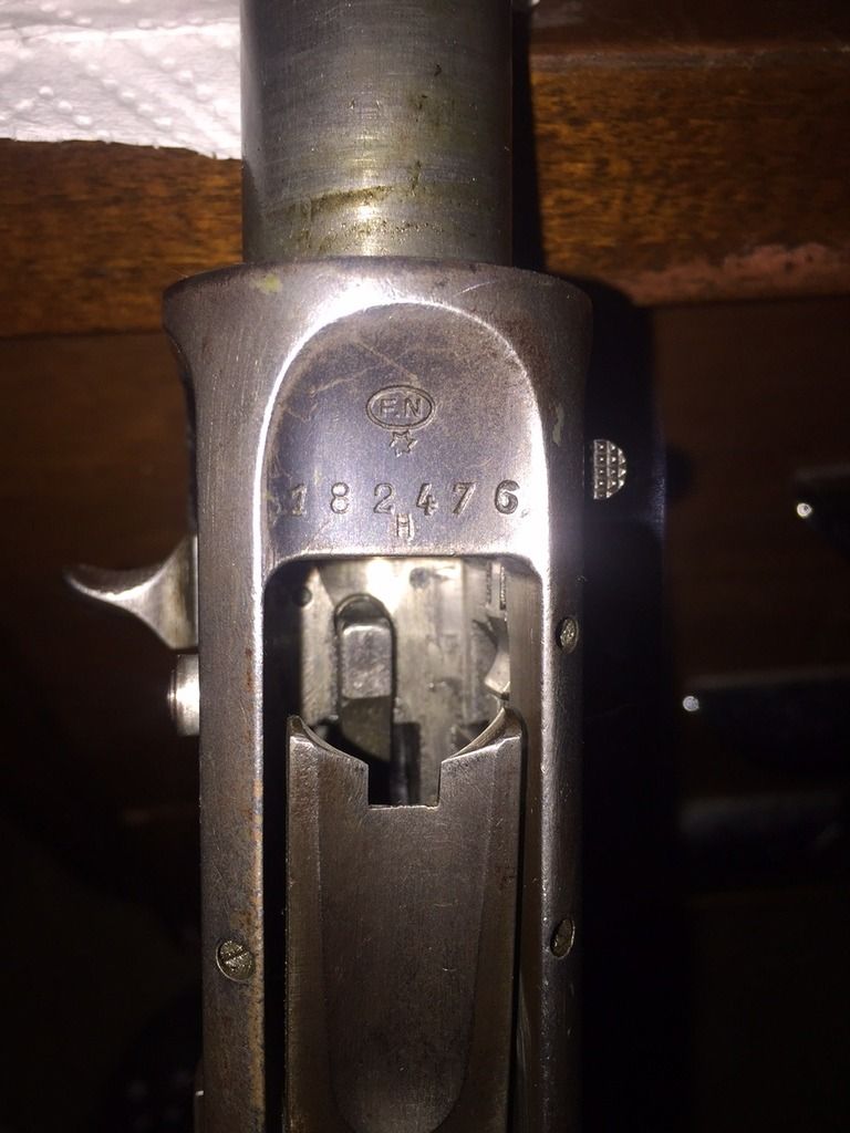

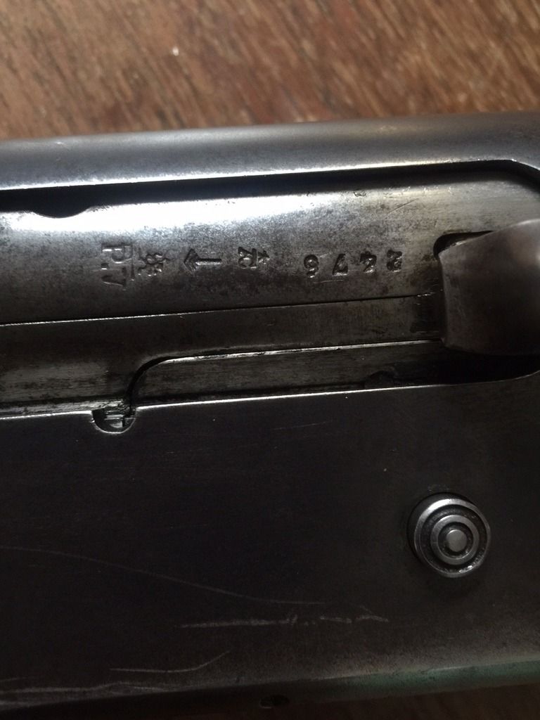

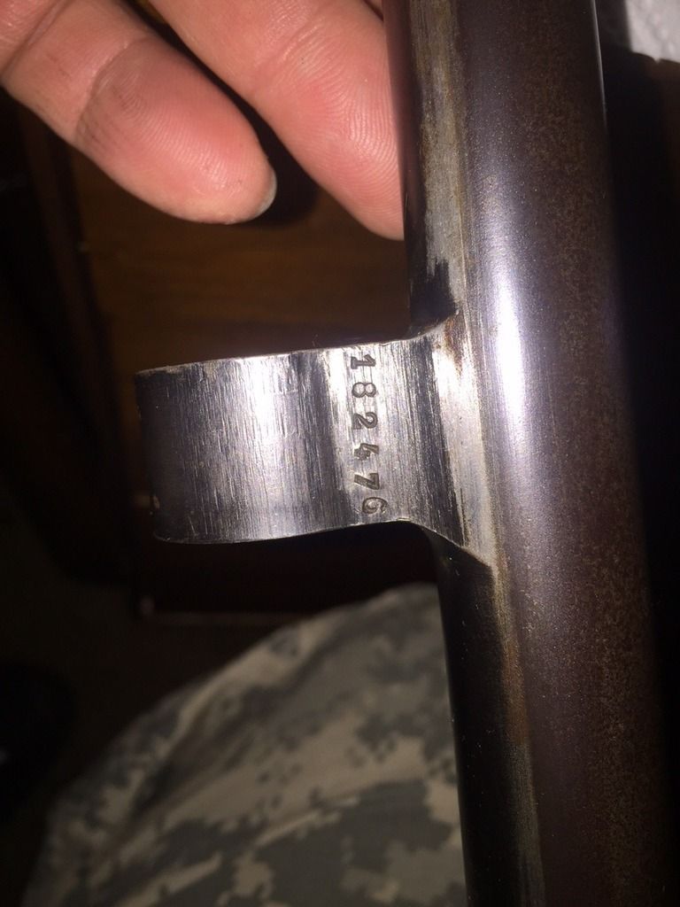

Hey Guys, I have some oddities of my (presumed) 1936 FN. I'm guessing it's a barrel replacement, since it is state side, but it still has Belgian proofs. Any additional information would be appreciated! It's clearly in terrible condition, but I'd like to learn more about it.
SN 192***
http://imgur.com/X4ed3Pq
http://imgur.com/H9J9TVw
Original Butt pad
http://imgur.com/trbTwRD
Original Forearm
http://imgur.com/Ua8JvSs
Here is where it gets weird:
Barrel Proofs
http://imgur.com/Alaqnlh
** - Special Steel 12 Gauge Shells 2 3/4"
http://imgur.com/DB2s0o6
More Barrel Proofs
http://imgur.com/m8E84z2
http://imgur.com/hrW69o8
Barrel SN (Presumably)
http://imgur.com/70jRc9W
Proofs where I expected the SN
http://imgur.com/ZJzukYx
 Post subject: Re: Timeline for the Browning Auto 5 1903 – 1940
PostPosted: Thu Mar 16, 2017 7:30 am
Posts: 2078
No mystery, you've got a 1936 receiver with a Light Twelve barrel made between 1959-1963. The number on the barrel is not the serial number, they quit doing that in 1953. But back when they did stamp the number on the barrel it appeared on the ring.
