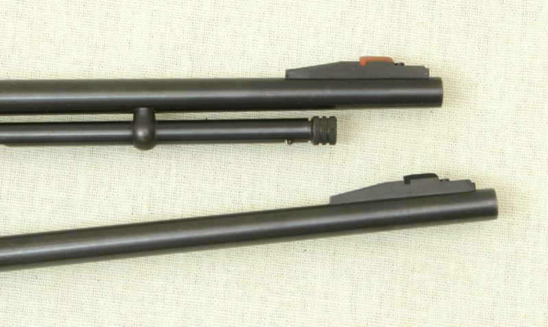

Ithaca made 3 models of an autoloading .22 caliber rifle. the X5-T (tubular), the X5-C (clip) and the replacement for these 2, the X15. The X15 was a clip fed gun.
Top gun is the X5-T (usually stocked in walnut). Bottom gun is the X-15. I have a X5-C someplace but not within easy reach. As has been mentioned, the tubular models can be problematical (The one shown hasn't failed to feed - yet) and was dropped when the X-15 was introduced. All models had the Deerslayer style front sight.
Clips were offered in 7 shot and 10 shot sizes.
