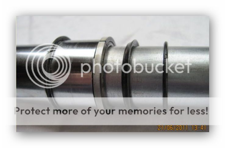

First off remove forend and barrel then remove piston sleeve (or action sleeve) – For those with the old gas seal the picture show’s the correct way to assemble – the cupped side goes towards the forend nut.

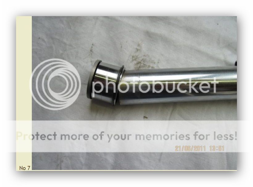

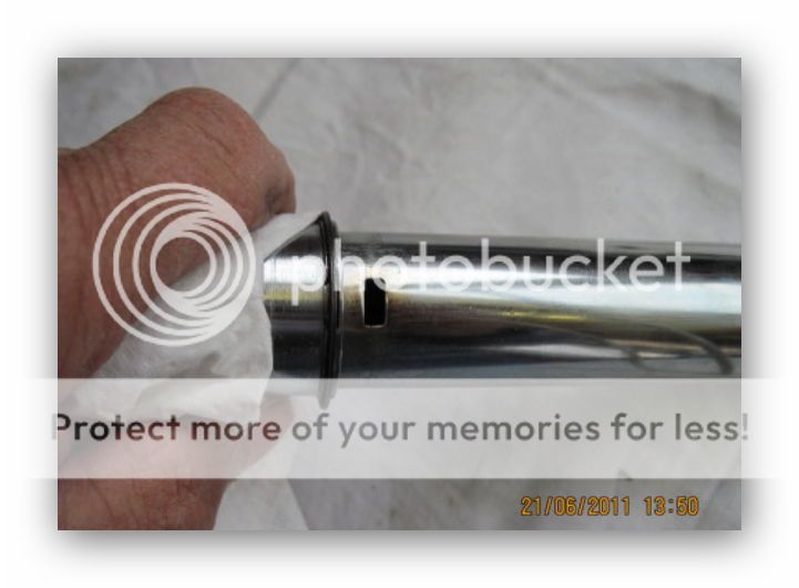

To remove the piston head use a piece of cloth or paper towel and hold the piston head – with other hand hold the Action sleeve and twist head either clockwise or anticlockwise and you will feel retaining clip rise out of it’s notch – then just twist slightly and pull head off Action sleeve – remove inner ring and clean everything –

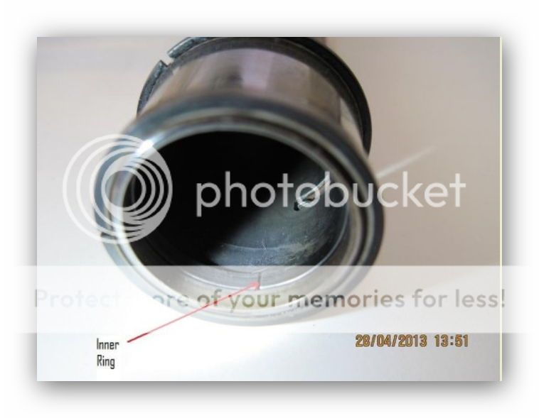

Further to pictures above which show Gas seal and rubber ring on mag tube - There is also the outer ring on piston head - What can't be seen is inner ring inside piston head so these next two pictures will show ring in and out of piston head.
Inner ring fitted.
pictures mislaid at moment
no inner ring
Pictures mislaid at moment
The function of inner ring is to form a gas tight seal between piston head and mag tube - This is achieved when gas from shell starts to push piston head and sleeve rearward and as soon as piston head start's to move it squeezes the inner ring onto mag tube - As you can see from picture it is a split ring and the mating face in piston head is chamfered to compress inner ring.
To assemble fit inner ring and outer if you have removed it and holding piston head towards vertical to keep inner ring in place put sleeve into head as shown – you will see the tag on circlip so place action sleeve into head as shown making sure it goes under tag then push and line two up so they will just slide together – twist till circlip clips home

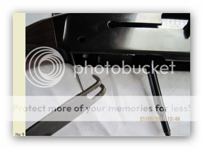

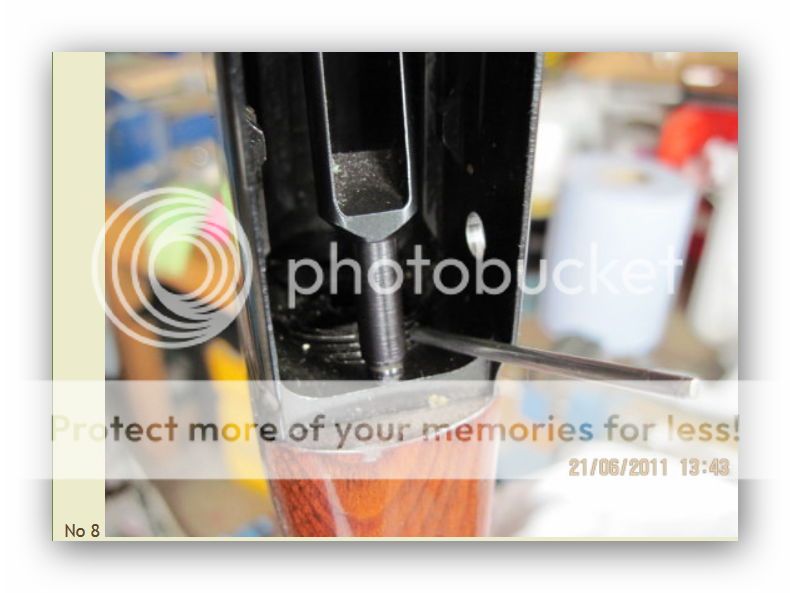

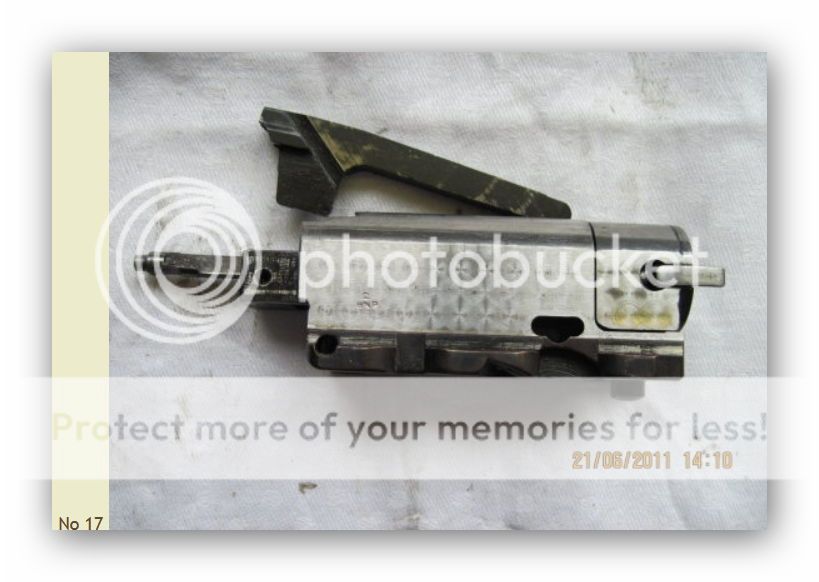

Now remove trigger pin by just pushing out with suitable punch and pull trigger down and back slightly – Now remove bolt – as you will see by the pictures I have drilled a small hole through the threads of rebound tube so I can insert a 1/8th rod to hold the follower down which makes things so much easier to remove bolt – also in picture was a tool I made when I had my first X1 – just put gun on bench pointing up then with one hand pull bolt down ½” and using a small screwdriver or similar hold follower down then with bolt handle lift bolt up as far as it will go and tip gun so bolt link swings forward through cutout in thread of follower tube – remove bolt handle

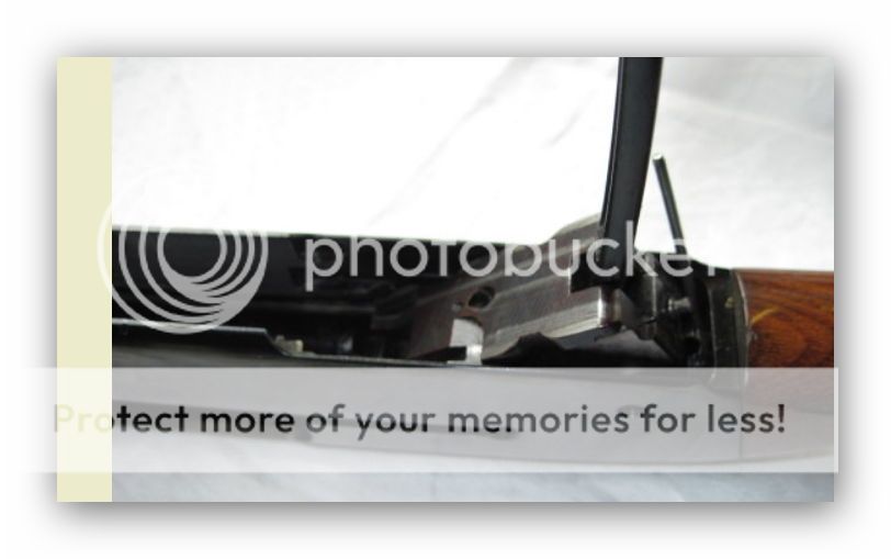

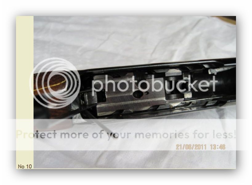

Now with fingers pull link bar back so bolt lines up with notches in slider rails in receiver then lift link up and bolt will lift out of receiver

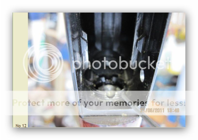

Now if you look in back of receiver you should see the bolt buffer behind the thread on rebound tube – to replace use screwdriver to prize out of it’s housing – clean any dirt out then put blob of Vaseline on knob on new buffer and put in place – I use a 12” socket extension bar through front of receiver – place on buffer and give bar a sharp tap with rubber mallet or hammer. - if you wish you can remove the stock to make sure no bit's of the old buffer remain at back of locating hole - but you shouldn't have any trouble putting buffer in if you do not remove stock.
Sorry about this pic but as you can see the buffer is behind thread of rebound tube.

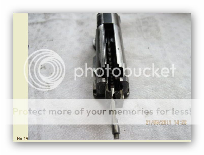

Renewing firing pin and spring.
You will need a very good punch for this job and you will need to support end of bolt at pin end.
With said punch remove pin as shown.
With thumb and finger press in firing pin slightly and lift up on bolt lock. –
When bolt lock is removed gently release firing pin then remove – pull bolt head out of body and remove spring. Clean all parts and very lightly oil then reassemble – Slide bolt head into bolt body-- next job is to pre insert fixing pin into hole just enough to hold it in position. When you have put firing pin and spring in make sure it is in as shown on picture – long slot in pin on right hand side.

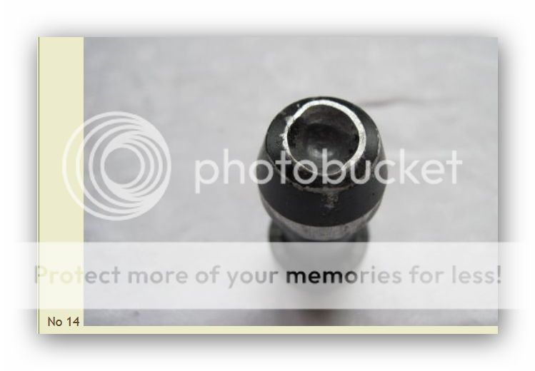

More info on Bolt
These are a few pictures from one of my bolt locks - As you see at top end of picture there is a bit of bolt sticking up like a mountain - That should be twice as long but a bit to left of mountain has broken off - It is in fact a rib or lip and it's purpose is to keep bolt lock in place when bolt is assembled - In next pic is firing pin - That short cutout is there that lip on bolt lock drop's through when you assemble it - The third picture is showing bolt lock upside down with firing pin held in possition it will be in when you drop in bolt lock - as you assemble bolt that lip will move back along firing pin in that long slot on pin's side and lip will be underneath pin (in this picture you can see how much of lip has broken off)- you can see slide marks on pin - That then is what holds bolt lock into bolt.
So check that everytime you take bolt apart because as you can see if the remaining bit of that lip breaks of then lock can come out as nothing is holding it in place - Now whether it will jamb gun up or not I don't know (yet).
Edit
I have lost two of the pictures completely - So to recap - when you check bolt lock make sure the little lip on the bottom that fit's under firing pin has not broken off - mine had lost half of it's length and it's only about 3/16th long anyway

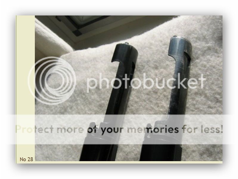

This is a picture of the barrel tangs from each end of number range - the one on right is earlier and left the later - both barrels are interchangable with all my guns but as some people know some barrels have to be fitted to some receivers.

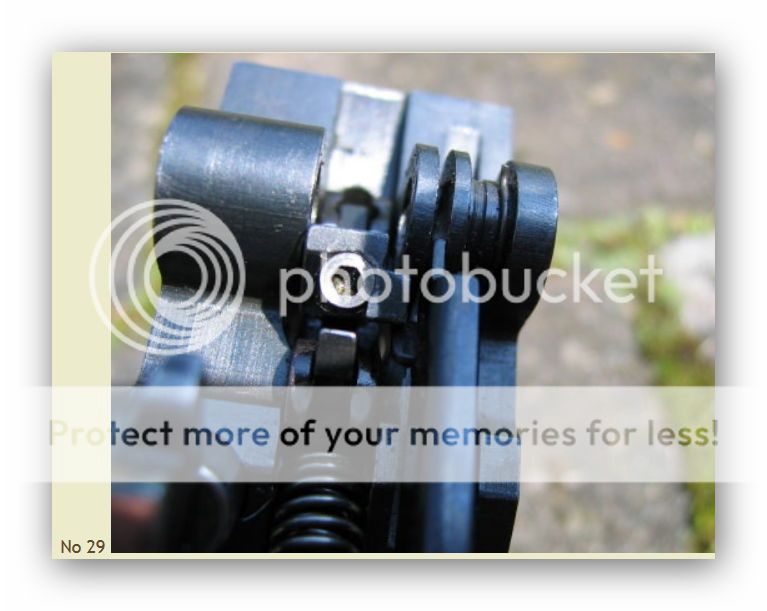

Replacing hammer spring
If I recall the Stage one trigger has two springs - They can be replaced with the single spring now available.
This is easy once you have done it a few times - I would recommend practicing with a old spring with a few coils cut off just to get hang of it.

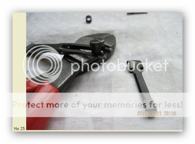

With hammer in fired possition hold trigger group in one hand with lifter in your stomach - it helps to have a padded rag on your stomach.
With other hand take a small electricians screwdriver or similar and insert it in coil of spring close to end of spring - (pic 1)
Then with thumb over top of spring to catch it pull back with screwdriver then start to lift it up - if you have pulled back far enough the wedge end will have come out of it groove and you should be able to lift spring assembly up -- (Pic 2) -

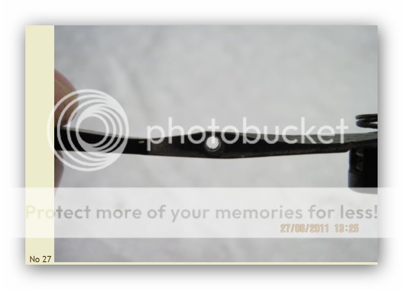

You will see from other two pictures that the rod holding spring is in two halves and one with wedge end fit's over one fixed to hammer - Just change spring then assemble in reverse order -
The tricky bit is now -you have to put screwdriver back in coil and pull back and at same time making sure one rod has gone into wedge rod.-- push spring down untill it's located in it's groove. :shock: :shock: .
I had a bit of trauma doing this one - The hammer got stuck and if I had any hair it would have been a hair pulling moment - But as usual it was simple - I found pin for lifter had fell out :oops: :oops:
