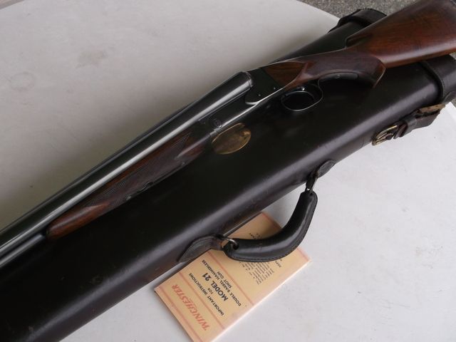

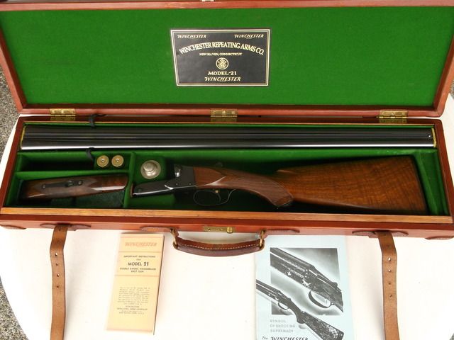

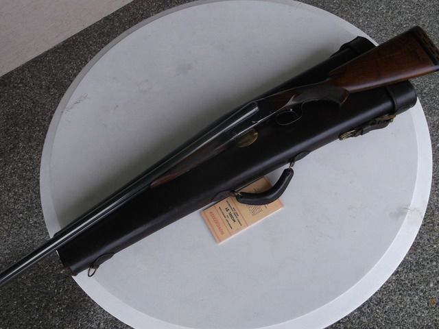

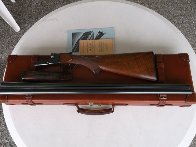

I only own two Model 21's. . Both are pre-war guns and still good for a couple more life times of shooting modern shotshells.
This one from around 1937 . .
Around 1935 . . a factory 3" chambered 21 before they were marked "Duck"

Those are real eye candy!

Wraco, convince me more by sending me the 3" gun..[MONKEY FACE]
Nice custom you have got. What is the barrel length on both?

Is the trunk case an original Winchester case?
 Post subject: Re: winchester model 21
PostPosted: Sun Dec 18, 2016 3:31 pm
Joined: Sun Jan 14, 2007 10:41 pm
Posts: 1086
Location: Vancouver Island
To the best of my knowledge the trunk case is a Winchester 21 case. . The Model 21 that now resides there came to me with the other case, the leg-o-mutton one.
The trunk case I obtained, a good 20 some years ago or more, with an early L.C. Smith F/W Ideal Grade inside. . The trunk case was the reason I bought the outfit and eventually sold the L.C. Smith to a WTB ad.
The M21 fits the case like a glove but not likely of 1937 vintage. . The 3" M21 inherited the leg-o-mutton case and everything is good.
