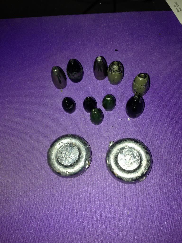

I recommend using lead and/or tungsten fishing weights. The following pictures shows the 12 ounces I stuffed into my Ethos using a combination of lead (circular weights) and tungsten (cylindrical weights) fishing weights.

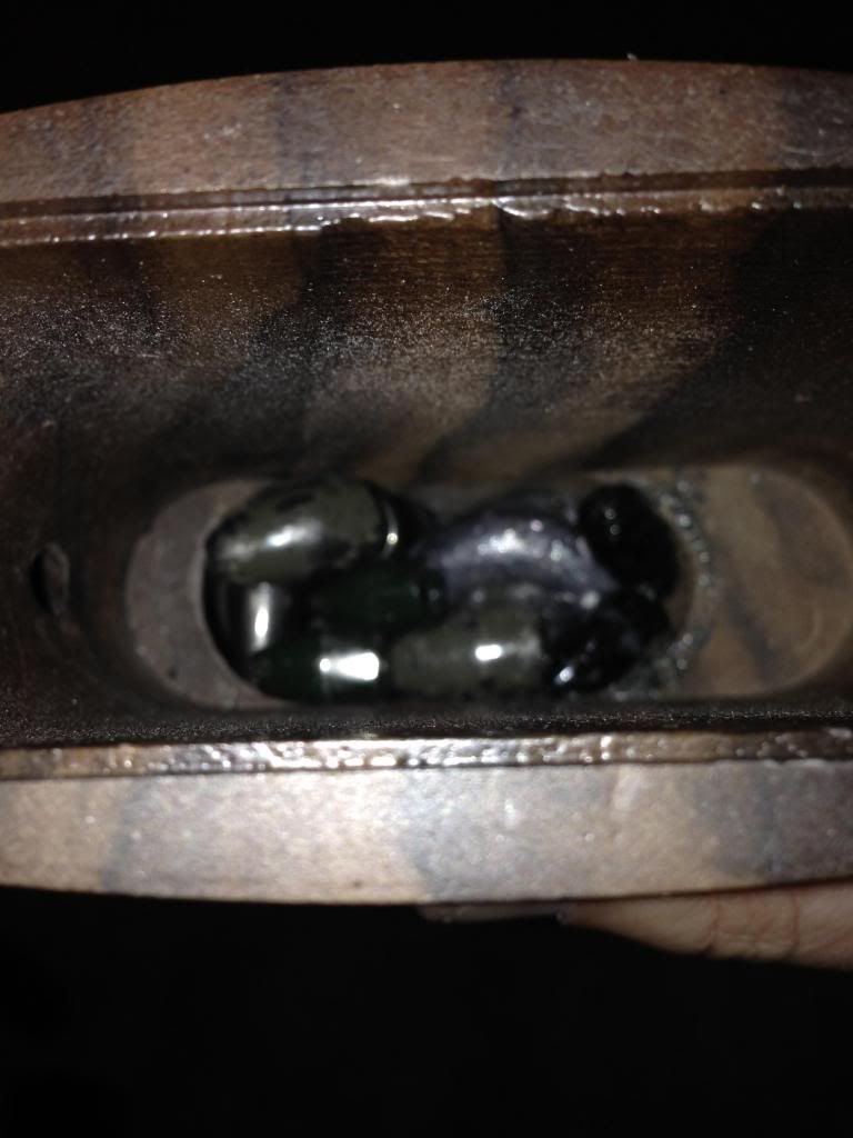

And here's what they look like stuffed into the stock.
To complete the stock filling process, find an old sock and cut off just the "toe" portion. This will act as a buffer between the progressive comfort system and the weights. It will keep the weights from sliding around while shooting.

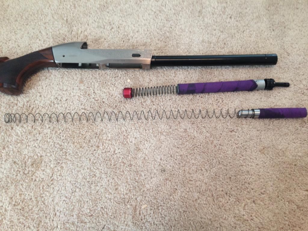

Now comes the magazine. The Midway weight only weighs 9 oz. and that's just not enough. In order to get 24 oz. in the magazine tube, you need to purchase a steel bar, 7/8" in diameter at least 9 inches long. I just ordered a 12" long, low carbon steel rod from McMaster-Carr. It was cheap and delivered promptly for a grand total of $9.35. Here's the exact rod I ordered: http://www.mcmaster.com/#9120k39/=tfc2im . Cutting this rod was very easy. I just used a hack saw and cut it to 9" long. This rod will weight right at 1.5 lbs. and will give you the total 2.5 lbs. necessary to get the Ethos up to a 9 lb. gun.
The bad part about adding this rod is that your magazine will no longer be able to hold more than a single shell in it. Therefore, you've only got two shots; however, that's not usually a problem for sporting clays.

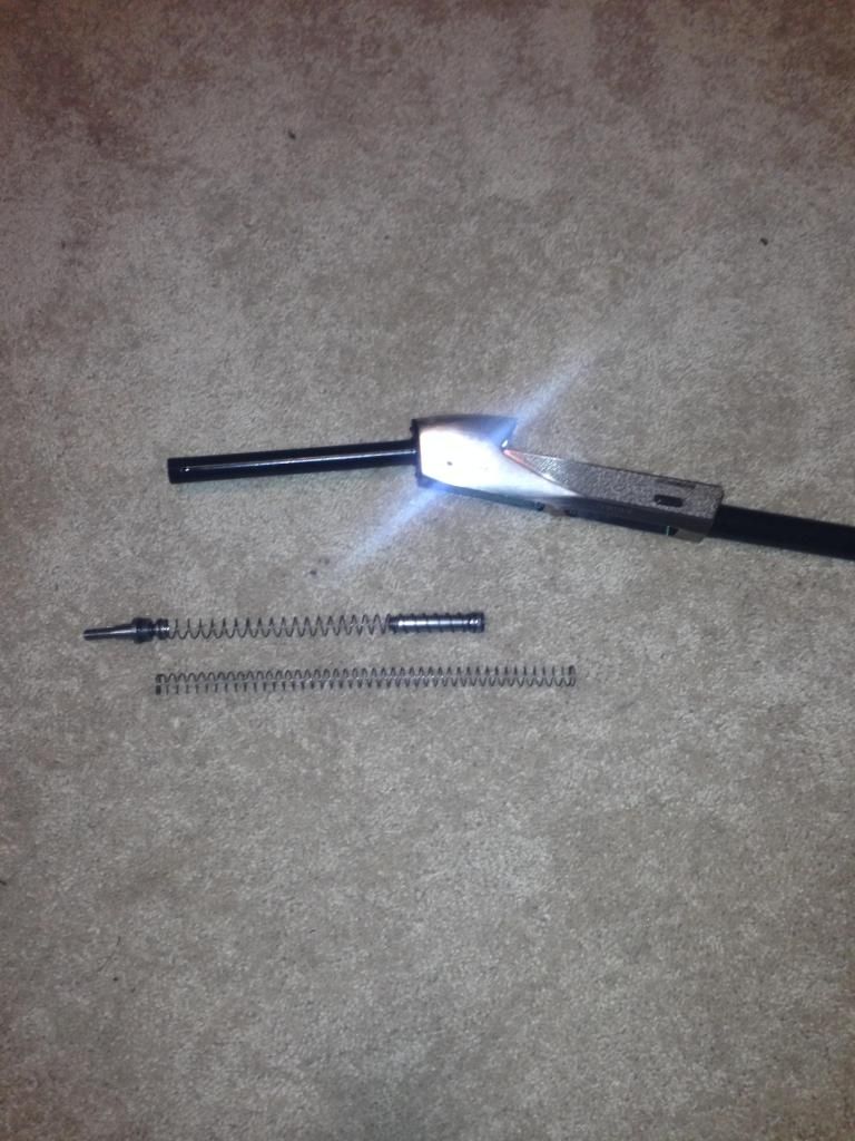

The other issue with adding this steel rod into the magazine is that the stock tube spring won't suffice anymore. You must replace the spring with an adequate alternative or cut the original spring by a large amount. I chose to find an alternative spring. So after some measuring and calculating, I found a replacement spring again at McMaster-Carr; however, you will have to cut this spring for use. The spring I ordered can be found here: http://www.mcmaster.com/#9637k31/=tfc60j . For less than $12, you can get 5 of these springs. I recommend getting a box of 5 springs so you can experiment with the length necessary to operate the Ethos.
I cut the spring using my Dremel and the metal cutting wheel. It was very easy to do. The unstretched length of spring that worked for me was ~4.25". So if you can image the magazine tube going from the section closest to the trigger and moving towards the barrel, the parts go: red stopper, cut spring, 9" long steel tube, threaded cap.
The following photo shows the various weight additions possible inside the magazine tube. On top of the photo is (obviously) the Ethos with the magazine tube exposed. Directly underneath the magazine tube is the setup for the heaviest weight (modified spring and steel rod from McMaster-Carr). At the bottom of the photo is the stock magazine spring with the Midway weight. Hopefully this clears up the process for this alteration.
Now your Ethos weighs 9 lbs. At this weight, the reliability of the inertia action depended on the shell. 1 oz. 1290 fps Winchester AA's cycled no problems. Also, 1 oz. 1290 fps Estate's cycled just fine. However, 1-1/8 oz. 1200 fps Federals would not cycle. I'm not sure what the deal is with Federals, but these shells would not cycle even though they should be more powerful than the AA's and Estate's. Anyways, what I had learned was that at 9 lbs. the action was getting shaky and wouldn't cycle 1 oz. 1200 fps at all. So I needed further modification.
The last and final modification necessary to make a 9+ lb. Ethos cycle "light" loads was to modify the recoil spring. Oddly enough, the "weak" Wolff spring is still stiffer than the stock recoil spring that comes in the Ethos (no wonder they advertise 7/8 oz. cycling capabilities). So what I did was order the "weak" Wolff recoil spring from here: http://www.brownells.com/shotgun-parts/ ... 42249.aspx .
After getting this spring, you guessed it, I had to cut it. So out came the Dremel again, and I cut the Wolff spring down to ~9.25" and installed it into my recoil tube.
The following photo shows the modifications done to the recoil spring. The top is (obviously) the Ethos with the recoil tube exposed. Directly underneath the recoil tube is the modified Wolff spring that I installed. At the bottom is the stock recoil spring that came with the Ethos.
Finally, after all this, I now have a 9~ lb. Ethos that cycles "light" loads with zero problems and is one of the softest shooting guns I've ever handled.
