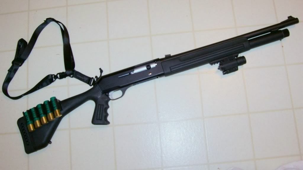

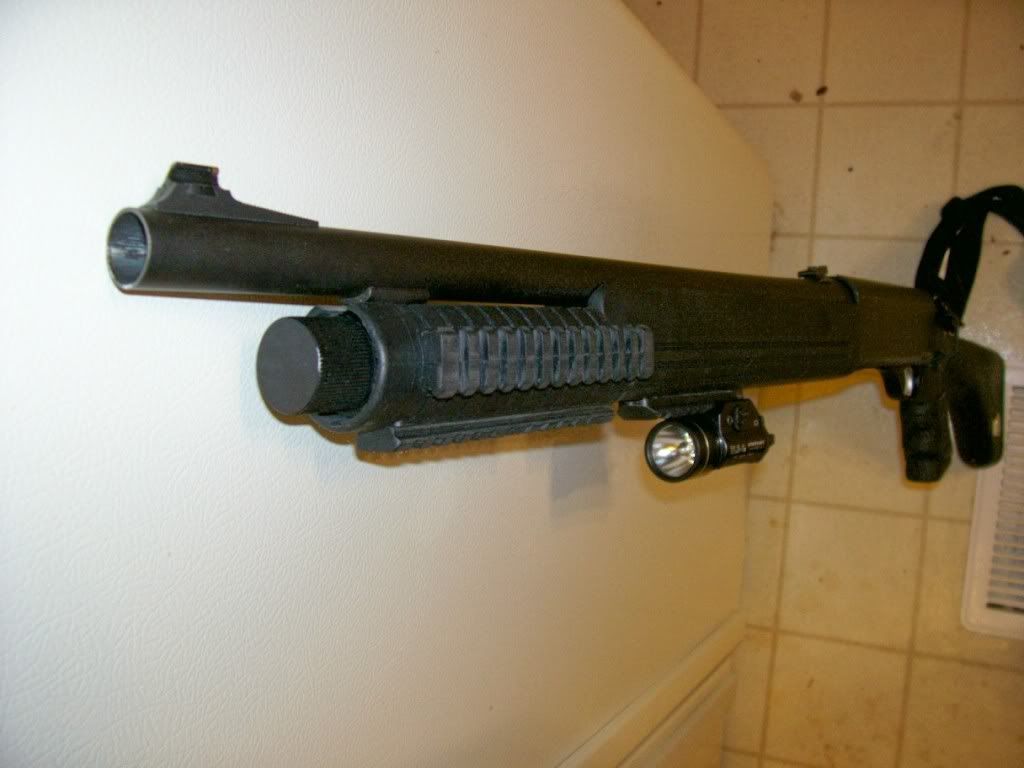

BioHazard wrote:
Is it just me, or is you light going to illuminate the back of your sling?
"Everyone thinks, when he takes up his pen, that whatever comes into his head is worth saying and printing, and quite as incontrovertible as that twice two make four." - Clausewitz
 Post subject: Re: Beretta 1200FP ?
PostPosted: Tue Aug 23, 2011 9:34 am
Joined: Thu Mar 17, 2011 3:31 am
Posts: 244
Location: Carolina
The short answer is.....yes.

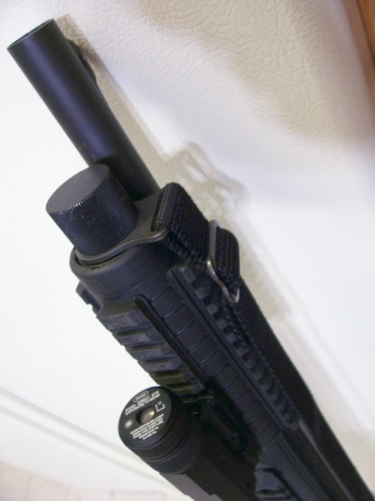

but only when it's dangling! :D

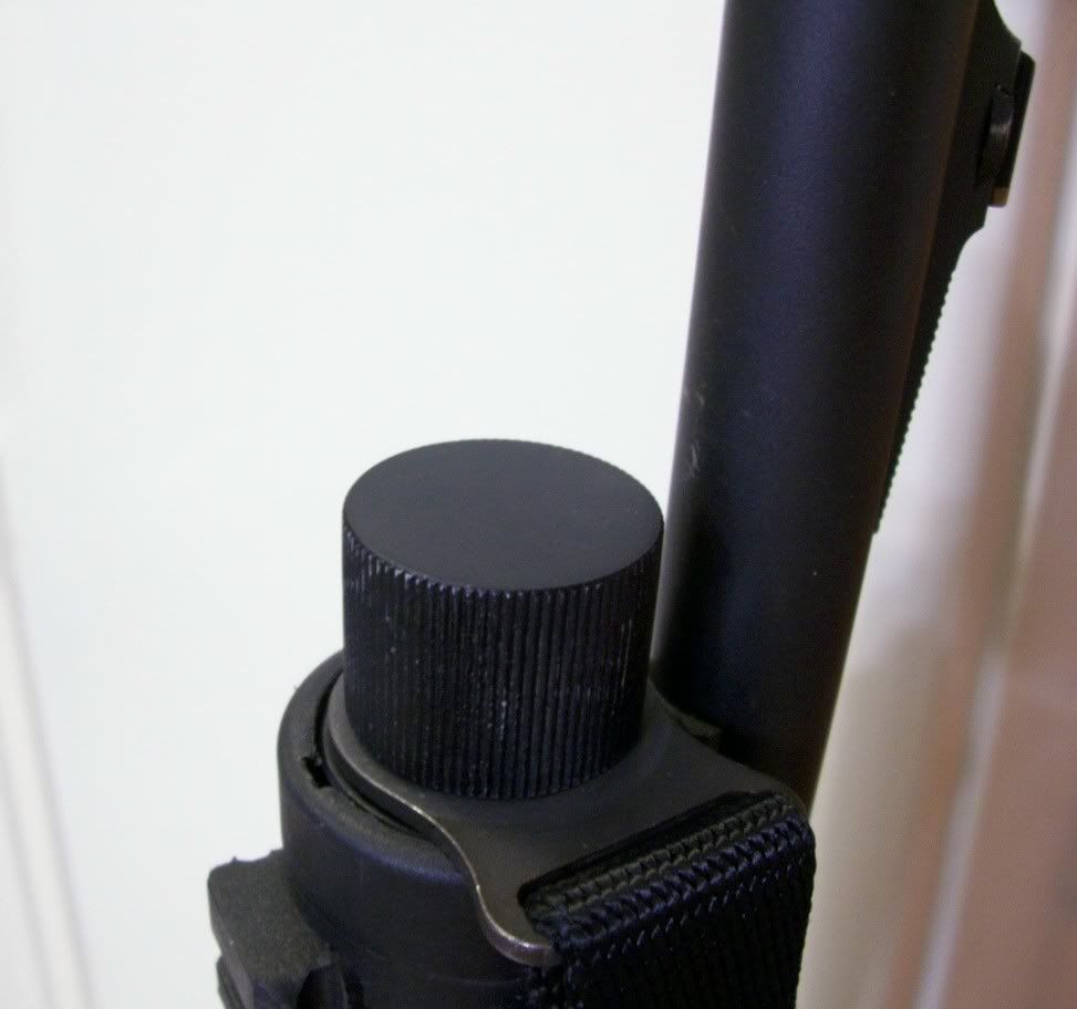

That particular shotgun now has a single point sling.....
I removed the muzzle sling swivel.

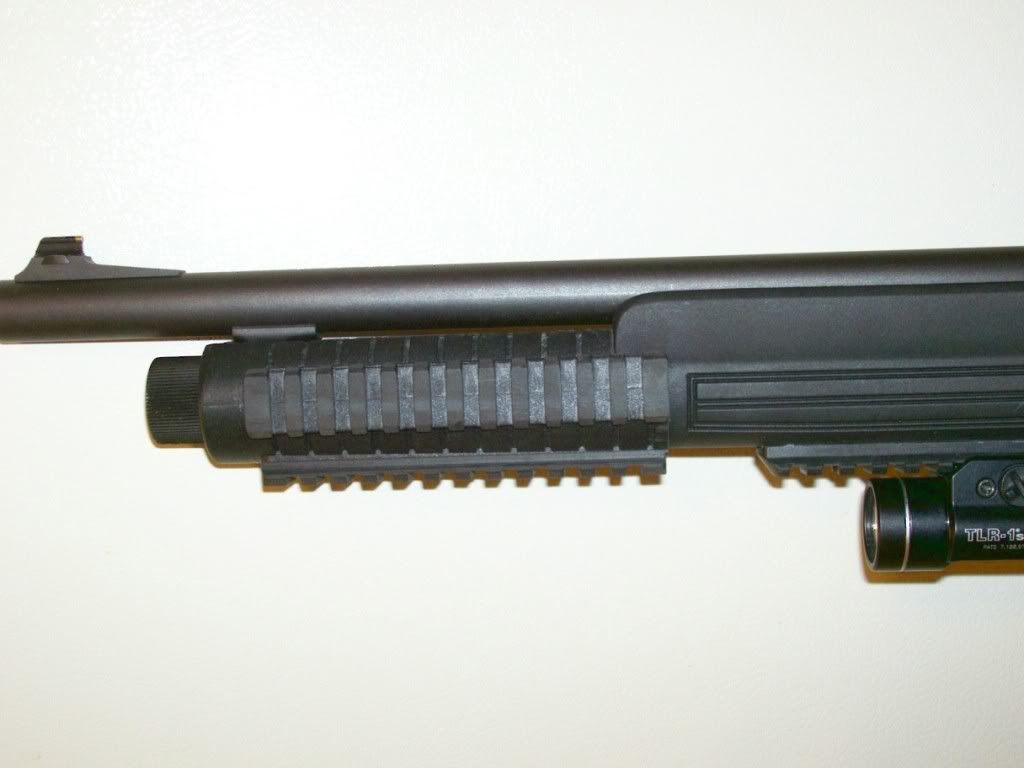

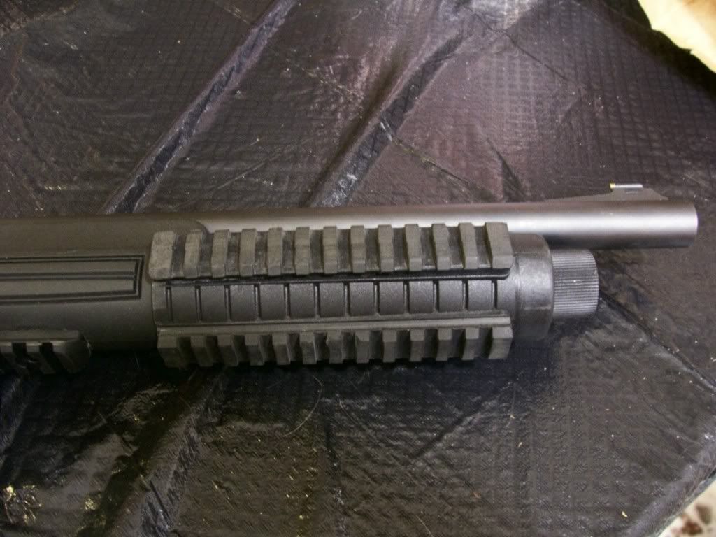

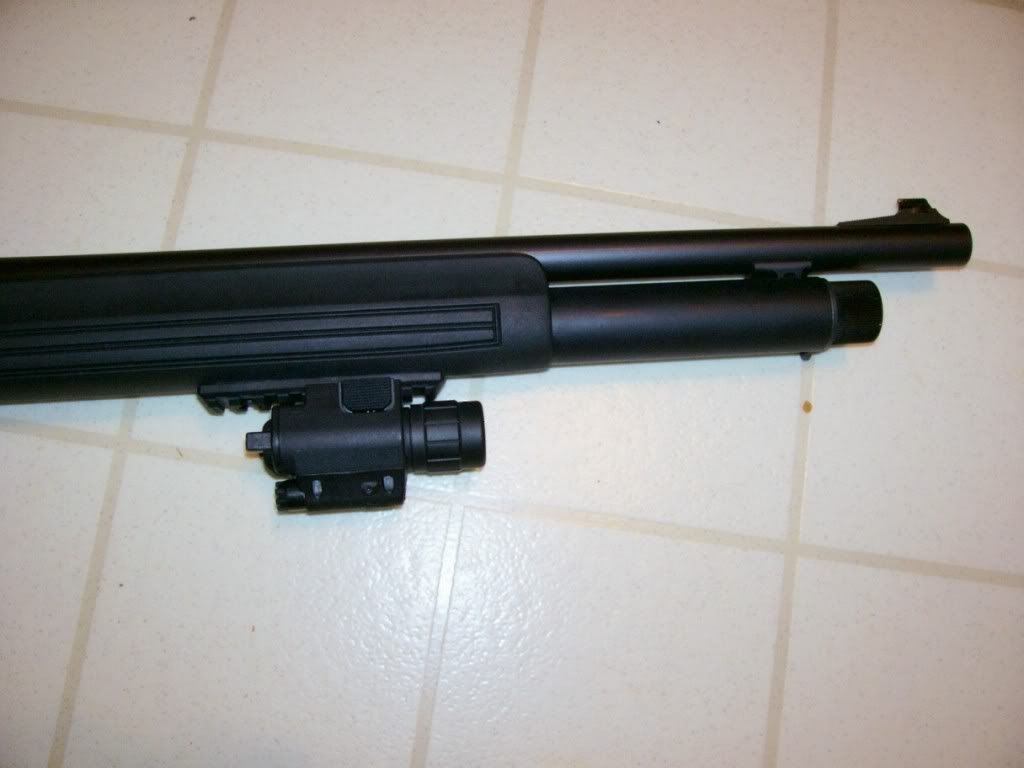

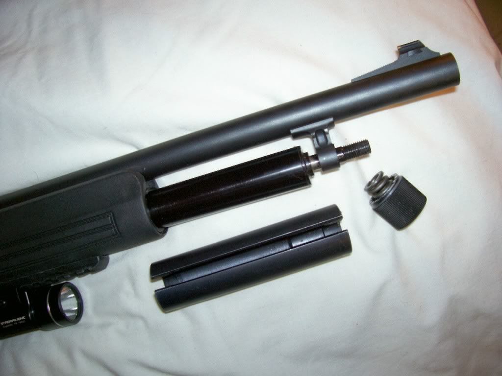

After purchasing 2 Beretta 1201FP police trade-ins, one of my goals was to figure out a dependable way to mount a light and accessories.
My first thought was to use the magazine tube shroud which also acts as the barrel and forend retainer and drill and tap it for rail segments.
Later I decided to add some Magpul rail segments directly mounted on the synthetic forend (and these work well), but some owners might not want to "deface" the forend by drilling and gluing rails to it.
I continued to look for an easy way to make a tactical rail that was stable and solid, but still easily detachable. The idea of drilling and tapping 6 tiny holes in the thin walled shroud tube had prevented me from tackling this job, since I wasn't sure there was enough aluminum there to thread!
Then, a few days ago, while in a local gunshop, I found an interesting piece in the "used accessory bin".
It is a synthetic molded forend with three rails that was orignally used to replace the forend on a pump shotgun, I think either a Mossberg 500 or Remington 870...I'm not sure which.
I picked it up for $15 and brought it home. The hole through the forend was undersized so I used an adjustable reamer to open it up from 1.105" to 1.28", the same diameter as the 1201's mag tube shroud. I've not yet trimmed the rail for best aesthetic fit, but it does look like it might make a good accessory rail that would mount near the muzzle, provide a very solid attachment and be easily detachable.
Magazine shroud in place
Magazine tube shroud removed
The rail will be permanently attached to a new Beretta barrel shroud, so it can be swapped in or removed in seconds and it is very lightweight.
The downside is....it's warthog ugly! :)
With the rails, it's slightly wider than the Beretta forend and reminds me of an under-barrel grenade launcher. I will trim it's length and contour the profile where it meets the forend for a better fit.
It is ugly, but there is a hidden beauty in Function often missed by the eye only seeking Form?
I'll post more pics when I get it fitted......I still have another spare shroud and someday (when I have a too much time on my hands), I may still attempt drilling and tapping one.

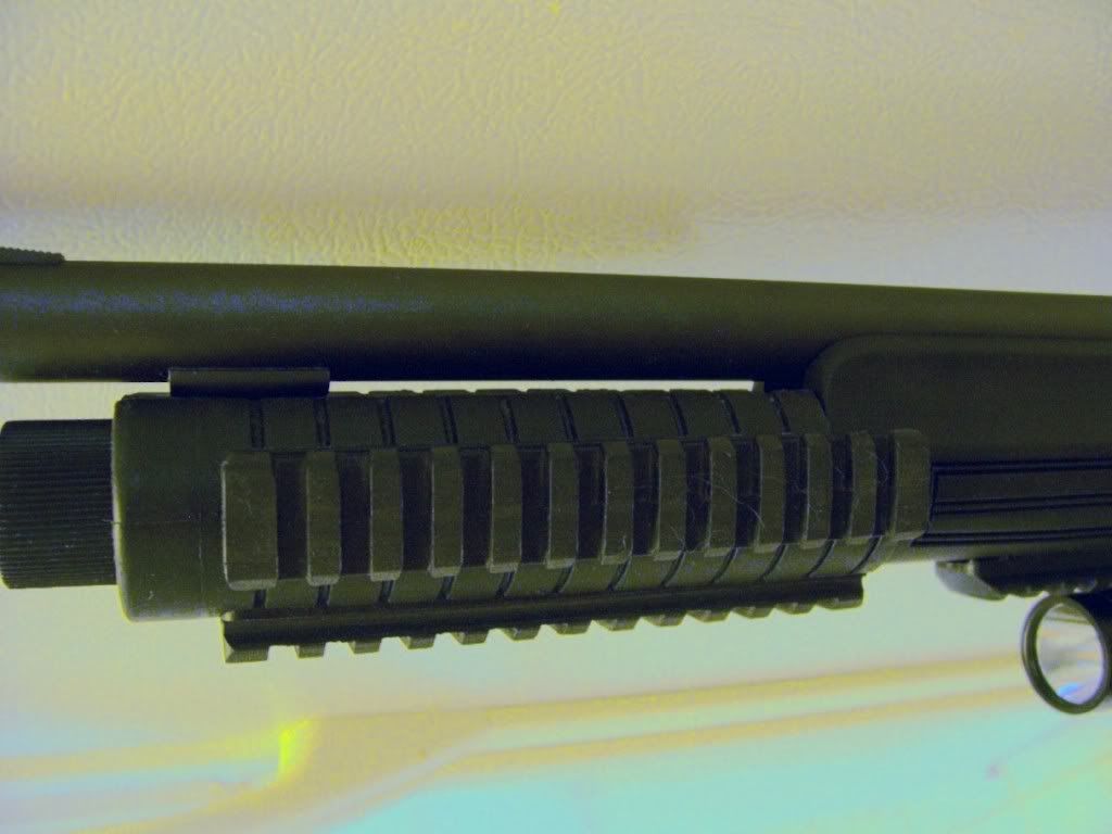

PostPosted: Thu Nov 03, 2011 1:37 pm
Posts: 244
Location: Carolina
I'm using my wife's gun to fit this, since her's doesn't have a muzzle sling loop.
once it's cut to length it will clear the sling loop position.
After fitting the rear to the forend....
just for the test version, I wanted to leave the rails as long as possible but it has to allow access to the barrel retaining nut (knob) at the front.
I undercut the rails to allow them to fit over the forend....
I still have to cut the front end flush with the mag shroud.
If you were to use 3 to 5 slot rail sections, which is probably more practical and enough for most lights and lasers, then one forend of this type, reamed and trimmed to length, could make 3-4 accessory rails for 1200/1201 shotguns. This would be much less work. No inletting or undercutting required....just ream it to size then cut off as many slots as you need.
There are also several aluminum versions of the rail type forends for pumps that might be worth checking for measurements.

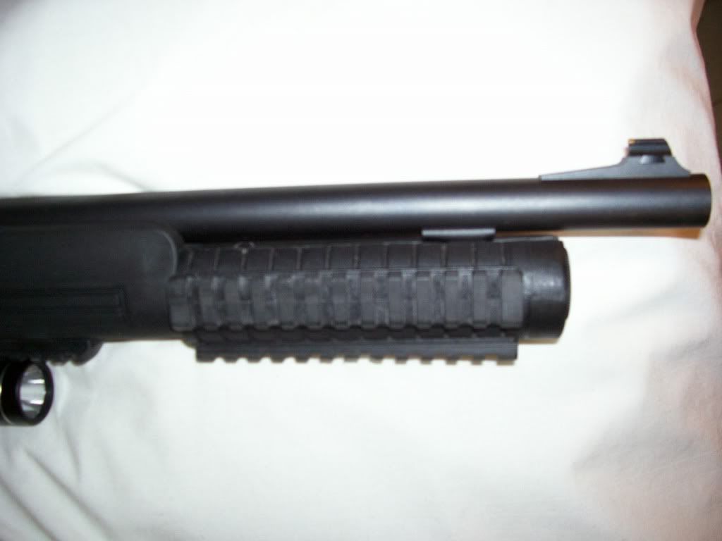

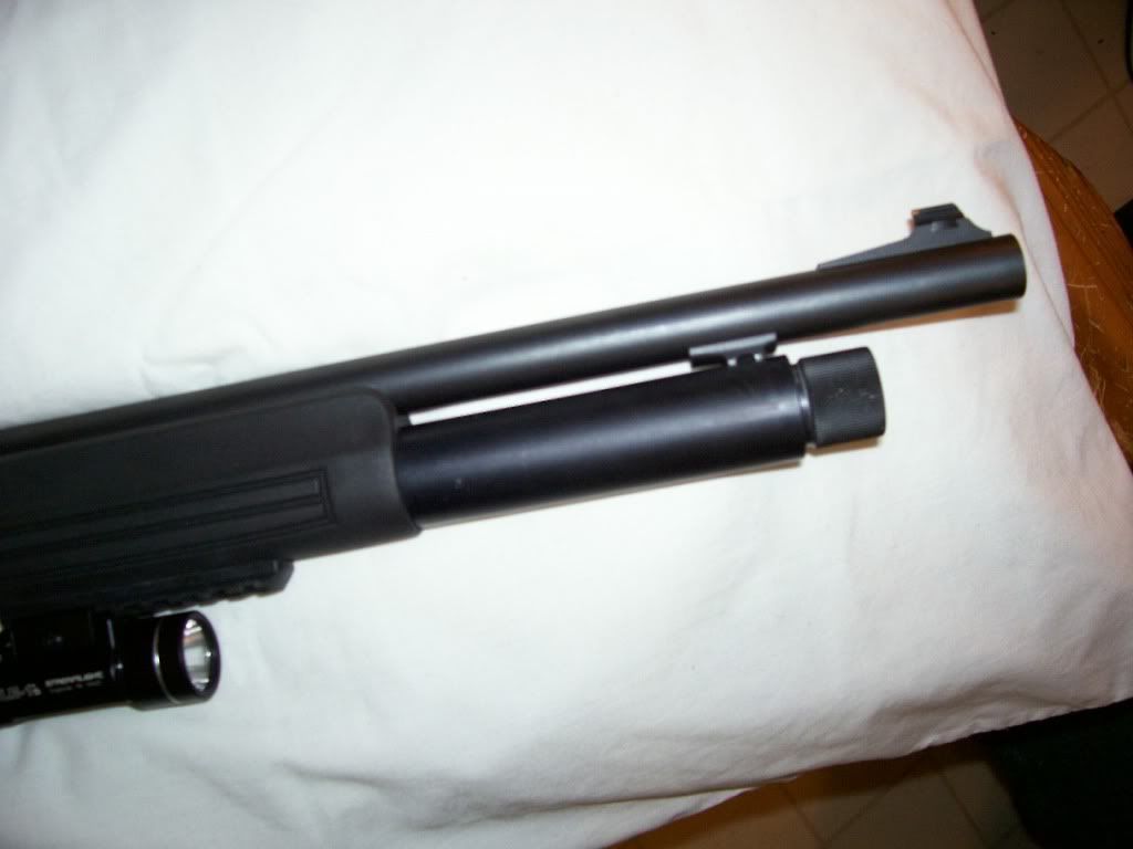

PostPosted: Thu Nov 10, 2011 1:08 am
Posts: 244
Location: Carolina

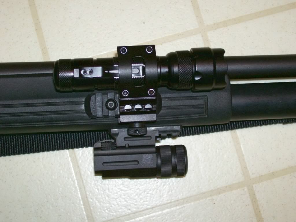

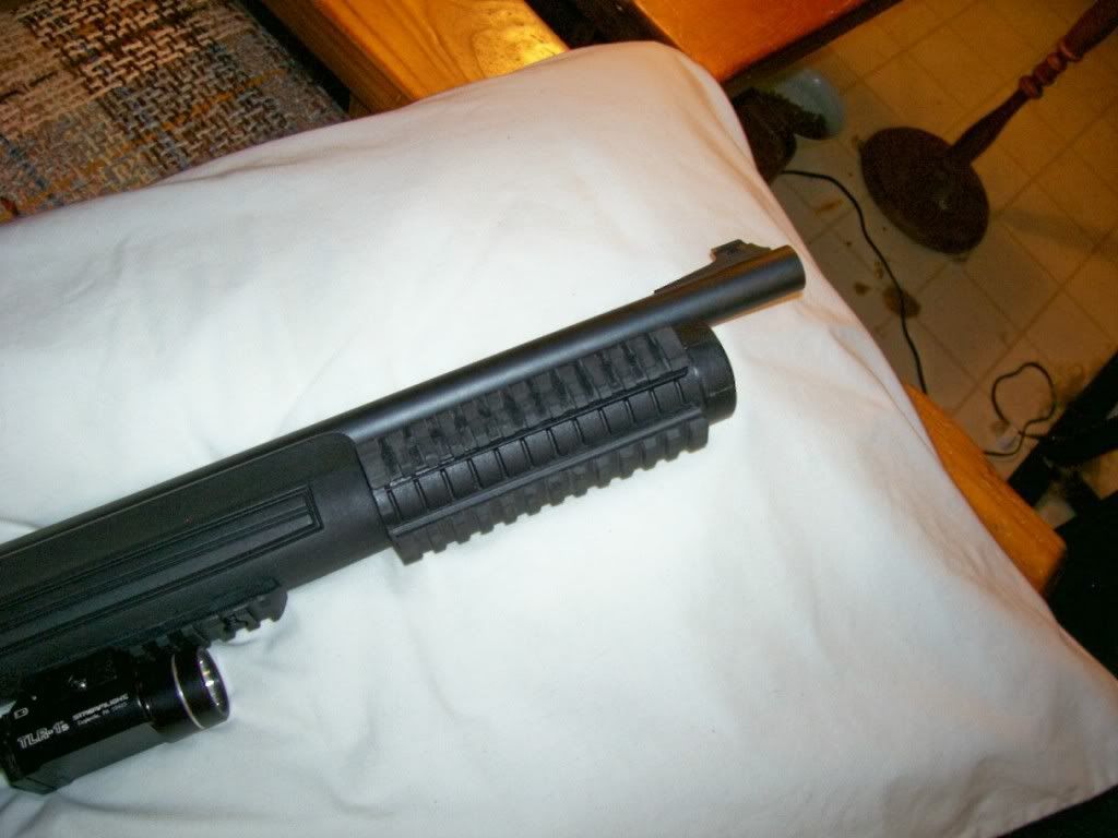

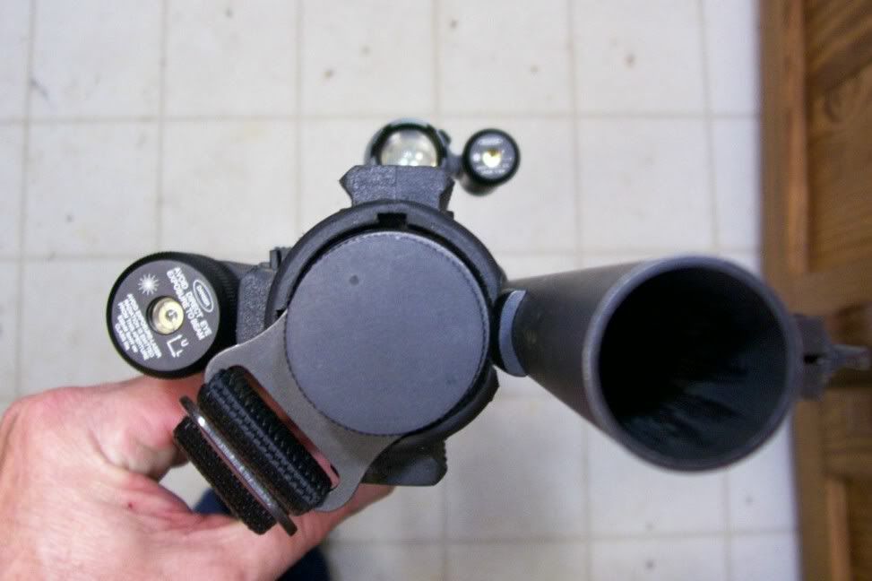

one last follow-up on the DIY rail for 1200FP/1201FP owners.....
after fitting it, I moved it from my wife's gun to the ugly 1201.
What I discovered when I slipped it on was the muzzle sling loop retained it so well, I didn't even need to secure it to the mag tube shroud.
Since I had cut the top slot narrower than the slot in the shroud, the barrel lug locked it in place radially and the sling loop locked it in place axially.
For those considering trying this, the easiest way is to cut the tri-rail forend to the second slot so it will just butt up to the Beretta's forend.
Since I was going to the range today to zero a Docter 6x42 Zf scope I picked up for my HK SL-7, I carried the Beretta along and gave the tri-rail a test shooting slugs at 100 yards (from a rest)....
with a laser!
The ugly Beretta surprised everyone there (inlcuding me!) when it fired a 5 shot group that measured under 6" using Fiocchi Aero slugs and a $60 NCStar laser...@ 100 yards, shot from the hip!!
Pardon the little holes, but not only do I print my own targets but I start with small holes and work my way up to big holes to save trips to the backstop.
With the laser 3" under the barrel and adjusted to 3" under the point of impact at 50yards, I thought I was going to hit too high, but it didn't.
I "aimed" the laser on the bottom edge of the target and the first slug hit 1" below the target on the cardboard backer.
I say I aimed, but really I just pointed the shotgun like a flashlight.....
I don't think there is any way I could do as well at 100 yards with the gun's small rifle sights and my ancient eyes.
When the spotter started calling hits on the paper, the other shooters didn't believe it until we walked down to the target.
If you haven't tried it, 100 yard LaserSlugs are a blast! :)

Rob, one of my friends recently bought a used 1201FP at a gunshow and on his gun, the locking pin on the magazine tube cover or sleeve had been sheared off by someone tightening the barrel retaining knob too tight. I sold him one of the new ones and used the other one on my wife's gun so now I have one slightly scratched takeoff and I still want to try brazing or soldering some metal rails on it when I get time.
You might not be interested in this, but I have found an alternative piece that I think will make a direct replacement for the OEM shroud with some work.....maybe major work.
Um, maybe too much work? :D
I don't know yet.
That's an Ergo cast aluminum Tri Rail forend for either a Remington or Mossberg pump. One version has the full length slot in the top and one is a solid tube. It's about 1.5" longer and ~1/32" wider I.D. than the original shroud or sleeve on our guns but with some trimming and a cap washer on one end, I think I can make a tactical replacement for the magazine shroud.
The rails and tube are one piece.
Anyway I have one of these that I picked up on eBay and I've already started modifiying it to fit the 1201. Another cold weather winter project. If it works, I'll post a picture.
Who knows.....there may be a market for something like this if Beretta is no longer selling the magazine tube cover for the 1200FP/1201FP?
