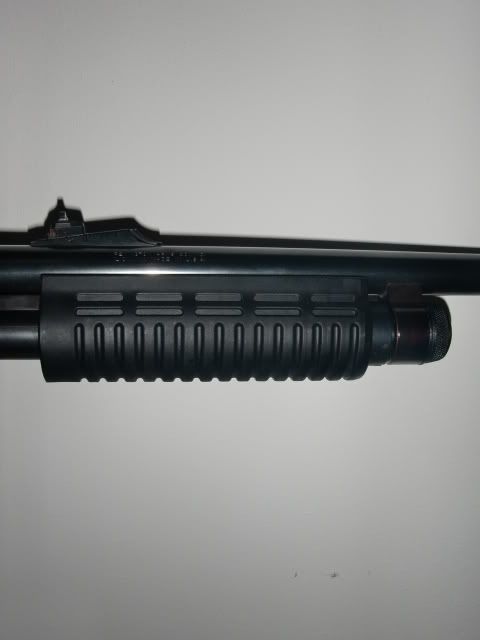

Fore end installed:

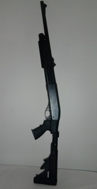

Butt stock installed:

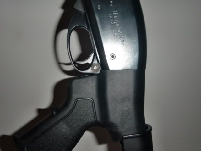

Before:
After:
Everything fits tight, no fore end issues.

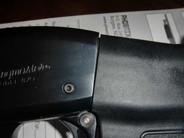

Here's what happens if you do not remove the plate inside the receiver (doh!)
Done right:
The over all butt stock is tight, the included recoil pad is super soft to about 50% compression, and the included shell holder is soft plastic and really only gets ridged once fully stocked. That will soon be replaced with an aluminum one.

Everything fits tight, no fore end issues. I do have one minor detail to address, but I believe I can tool it a bit to fit better.. and that is where the butt stock meets the receiver:
I believe I can shave a little material off the butt stock insert and make this flush.
did you remove the steel plate from between the reciever and stock?

Ya know.. I didn't.. I even looked at it.. HA! .. lets give that a shot. brb
 Post subject: Re: Kicklite Recoil Reduction Stock
PostPosted: Wed Aug 04, 2010 5:45 pm
Joined: Mon Dec 28, 2009 8:51 am
Posts: 15
Location: Cutler Bay, Fl.
That was it Banshee.. ha ha .. thanks.. wasn't even thinking about it. (updated my original post)
