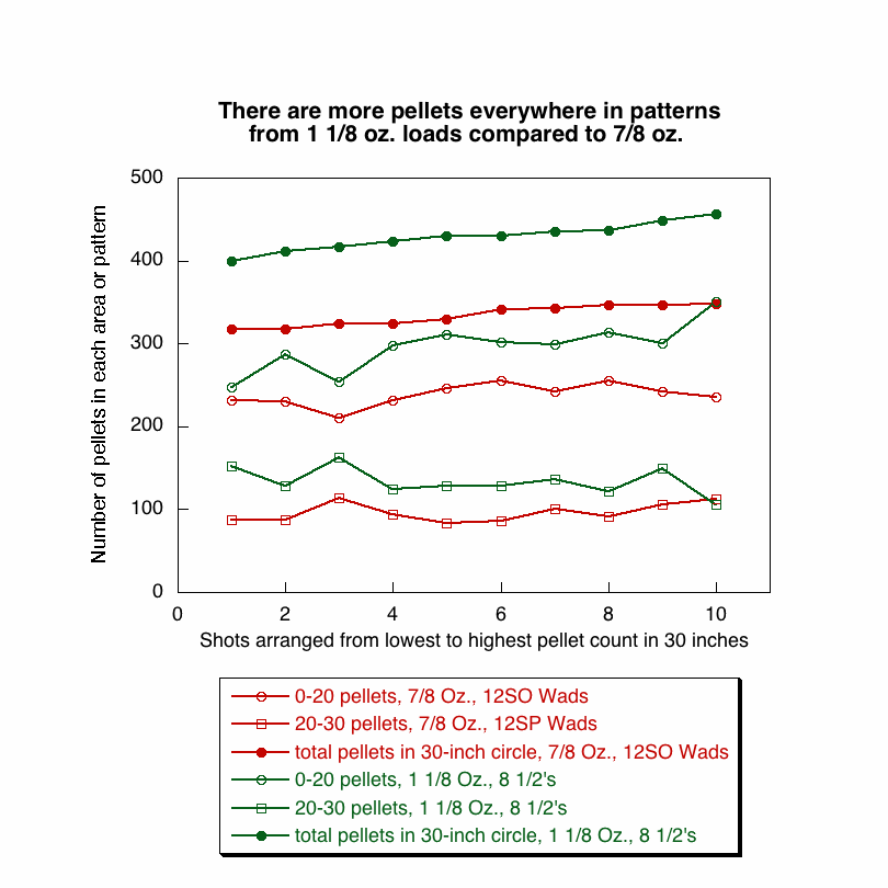

bdog58 wrote:
Who uses 7/8's loads out of their 12? Aside from the obvious difference of 1/8-1/4 of pellets, hows it working? Differences?
From Neil Winston.
http://randywakeman.com/

RandyWakeman wrote:
From Neil Winston.
Nice data Randy. It really suggests some value for the 1 1/8, 1145 fps loads or perhaps a compromise at 1 oz, 1180 fps. Why sacrifice likelihood of making a hit when you don’t have to? That is what I mean by controlling recoil by many factors contributing a little instead of trying to get there by pushing one factor past its sensible boundary. Heavier gun, perhaps a gas semi-auto if that suits you, good recoil pad or mechanical system, etc. and you shouldn’t have to go down to 7/8. As for the lower cost of 7/8, as is said before, that largely disappears in factory-made shells.
Robert
