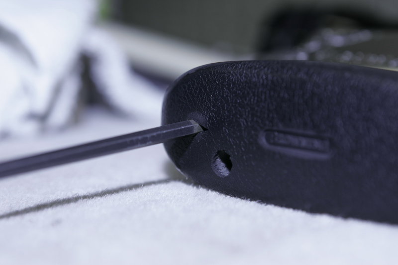

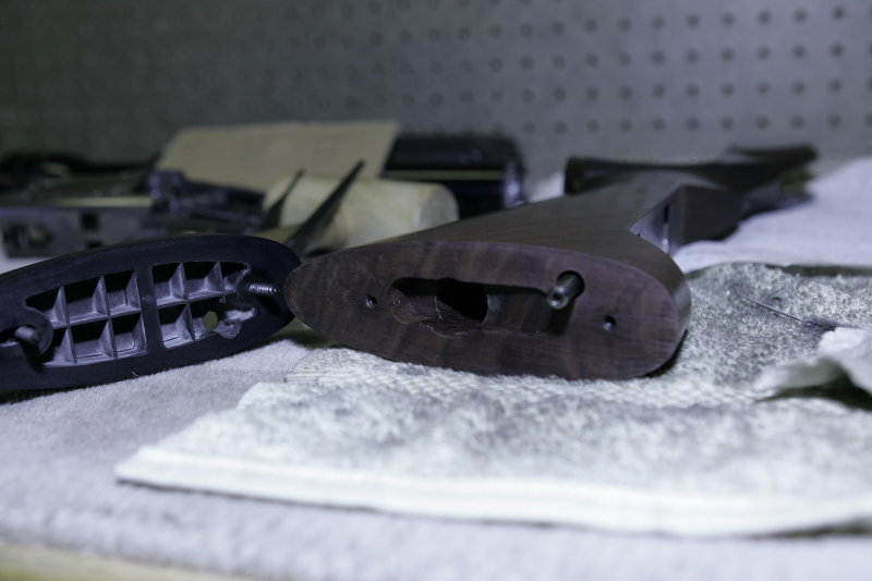

2 Remove recoil pad. Note that holes for the pad screws are hidden in slits. Put Armorall on a phillips screwdriver and the pad so the screwdriver does not mar or stick to the rubber:

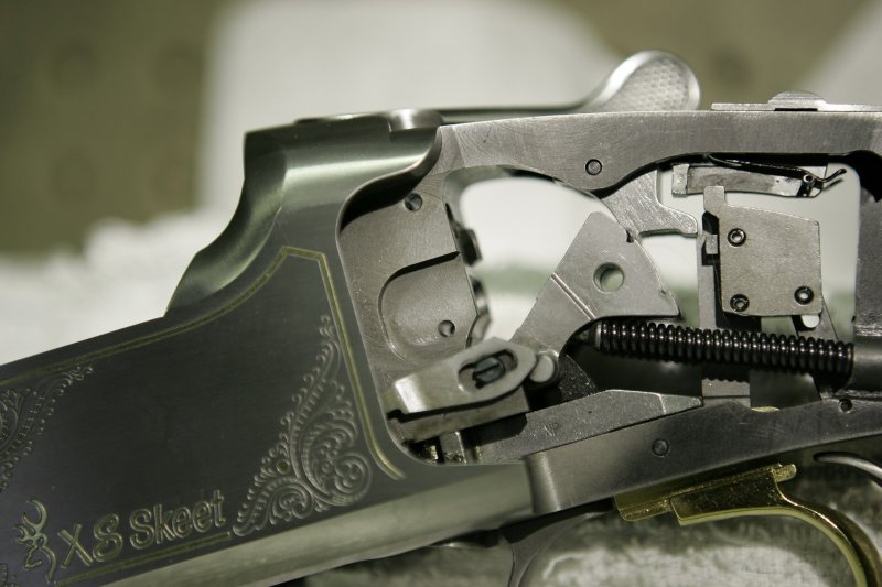

3 Remove stock from receiver. After you get the recoil pad off there is a big bolt recessed in a big hole in the stock. Loosen the bolt with the proper tool. My Citori came with a big allen wrench. Some bolts use a big screwdriver or socket wrench:

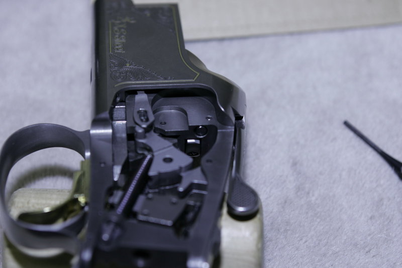

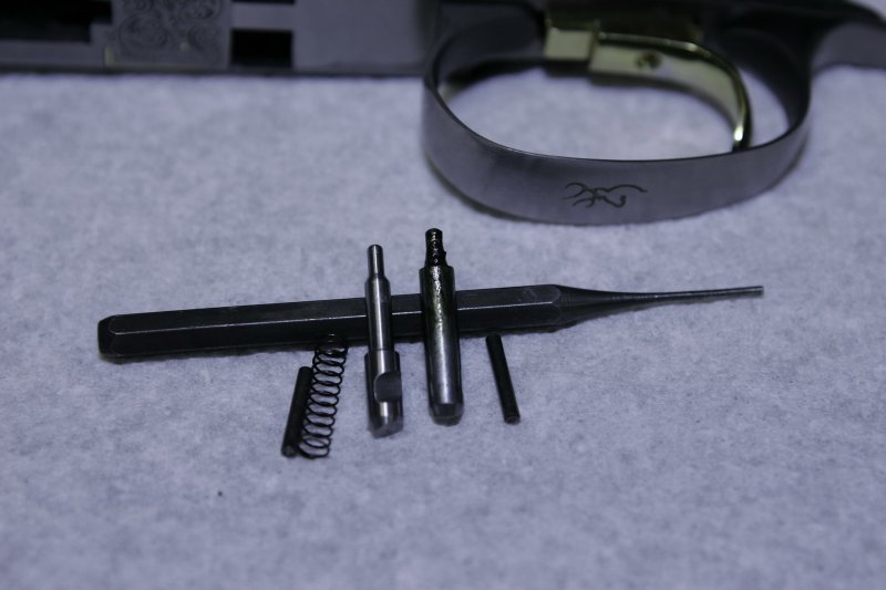

4 Tap out the upper and lower firing pin retainer pins with a small punch and hammer. The upper pin is driven out from the right side of the receiver and the lower pin is driven out from the left side as viewed from the rear. The below image of the left side of the receiver shows the pin holes empty. If you look at the original image on pBase you will see that the upper pin hole has a chamfer. The chamfer side is the side that the pin is inserted from. The pins tap out easily so don't hit them hard or you might ding them up:

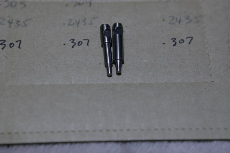

5 Clean and examine the firing pins and retainer pins for damage. Here are some images of the pins, clean and dirty:
I cleaned the firing pins and retainer pins like this:
Just chuck the parts in a drill and polish with the ScotchBrite pad. Instantly clean and polished.
6 Then clean out the firing pin cavities. I used a Qtip with bore cleaner to swab out the bulk of the gunk. They were both filthy, especially the lower cavity. Then I used compressed air to blow out any residue.
When you have the cavities clean, insert the firing pins and make sure they go all the way in and out very smoothly with zero binding. If I tapped the tip of the pins from the receiver side with my finger they would pop all the way out of the cavity.
7 Examine the pins for wear and damage, especially the tip of the firing pins that contact the primers. Mine were still perfect. The top pin protrudes .049" from the face of the receiver and the bottom pin protrudes .067". The retainer pins are identical for the top and bottom pin, by the way.
8 Reinstall the firing pins and tap in the retainer pins. I coated the firing pins lightly with gun oil. Don't forget the return spring for the lower firing pin and make sure the spring is perfectly clean. Tap the pins in with a bigger punch from the opposite side that you removed them. The pins are inserted from the side with the chamfer. Note that the firing pins have a u-shaped recess on the shaft which must be oriented properly so the retainer pin will go in.
