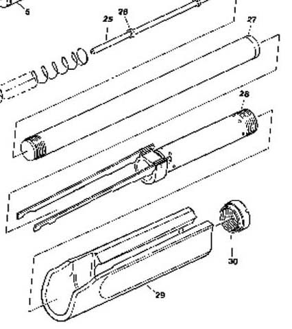

wfb18 - The photos attached to your post show exactly what my 500 looks like. The wooden forend is the same stained hardwood with the grooves cut in it. What I meant when I posted "mag tube" is the magazine tube (#27 on the diagram). That is the part that has the two external collars positioned midway on the tube (about 3" apart). A short flat spring is wound around the tube (about 1 1/2 turns) and is attached to the rearward collar (towards the threaded end of the magazine tube that screws into the receiver). The two collars provide the bearing surface that the slide action tube (#28 on the diagram) rides on when the action is worked. A constriction at the rear of the slide action tube contacts the spring as the action is closed and keeps the forend assembly from rattling when the action is locked (ingenious, yes?). This was the reason I couldn't get the assembly off when the bolt was removed - it simply would not travel beyond the spring and rear collar on the magazine tube.
I watched another Youtube video about maintaining the M 500 that was a preview of a gunsmithing course, and mention was made that this spring might be encountered on older Mossbergs and New Havens, and that the magazine tube would have to be removed in order to remove the slide assembly (as I discovered), so evidently this isn't unusual. Thanks.
