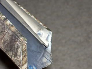

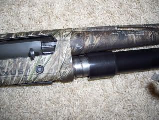

Here's that little plastic spacer I am talking about. Without actually measuring it I'd say its roughly 1/4 inch long, 3/16ths wide, and 1/16th thick
And here you can see a small spot worn thru the camo on the chamber area where it presses up againced the barrel.
When I wedge something between the forearm and barrel on the other side all of that forearm play disappears so I'm thinking that simply adding in an improvised plastic spacer with crazy glue or a tiny screw would remedy the problem.

The picture shown is exactly what I have on my 2 week old maxus. And yes, I concur with the statement that the same type of space on the other side would stop this minor movement of the forearm. I too plan on adding a spacer pad on the other side using Gorilla Super Glue and I'm sure it will not only stay, but completly stop all movement. I think in the furture, Browning will be doing the same, can not get a answer from them as to why they haven't done this already... Still standing by to stand by....

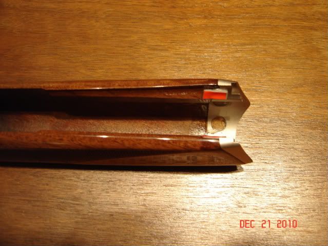

I have placed 2 pads (1 on each side of the forearm) at the approximate location of the factory pad shown above. My pads are more rearward than the factory pad and about 1/4" down from the top edge. The pads are made from the double sided mounting tape I mentioned above and are double thickness.
There is no movement in the forearm now. However, the test will be over time and with removals and installation of the forearm for cleaning.

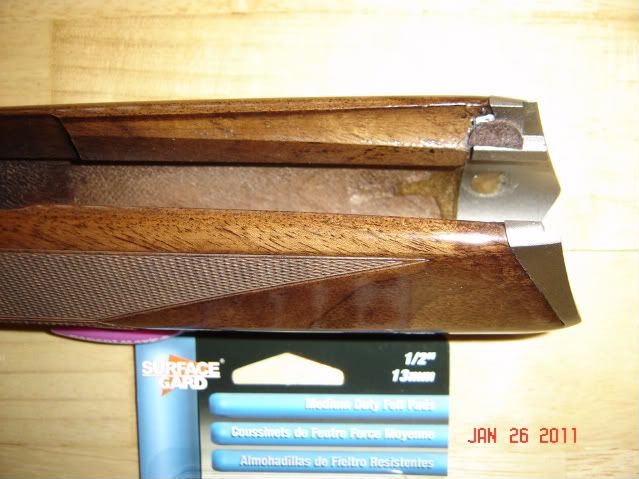

Here is a better fix from PCMS.
PCMS,
Here is the helpful picture of the forearm fix that you sent me.
I had to use my old Sony Cyber-shot camera to reduce its size below 1M (I didn't know how to use the other software on my machine to reduce it but my old camera had that capability....an old dog did a new trick!!).
I have also included the text of your email so that we can buy the rubber bumper and install it on our guns. Thanks a bunch; it's stuff like this that makes this website priceless!!
I am off to Home Depot to get the bumpers to make the fix.
My use of 3M Double Sided mounting tape is slowly deteriorating.
Text from PCMS:
The bumper is a rubber "Surface Guard" dome style. The base circumfrance is labled on the package as 10mm. Bought at home Depot. ALL I did was take the Exacto Knife in the picture and ' shave' a slice off the to to reduce thickness....got it right first time! ( But the pack of bumper guards contains a bunch, no need to worry about running out )
I then used the same knife to cut the now ' shaved bumper' in half.
I then simply took on half and stuck it to the bottom of the reciever. (BTW, i did clean the reciever spot really, really well with a cotton ball and some automotive degreaser first). The bumper stuck on with its own adhesive and hasn't moved since.
It's awesome Rick, the problem is completely fixed.
Let me know if you need any more pictures or info. Feel free to please insert this picture to the thread.

Vinly bumpers 3/8" x 10mm and
Felt pads 1/2" x 13mm.
Thanks to PCMS for finding the above!! These lead to a number of solutions.
I used the felt pads instead to allow for expansion and contraction of the wood forearm. The felt pads provided zero movement of the forearm. I cut one pad into two. Each half is placed at the upper rear corners of the metal trim piece on the rear of the forearm. Clean those areas with isopropyl alcohol first. The forearm is now snug, and, when removing, you have to push lightly forward with your thumb against the metal rear trim on the forearm. It slides on easily and locks in place easily.
Here are some pictures:
