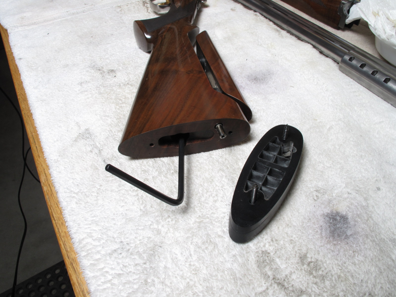

2) Remove recoil pad from stock
Put some ArmorAll on the pad slits and the screwdriver tip for easy insertion. My gun uses Philips screws.

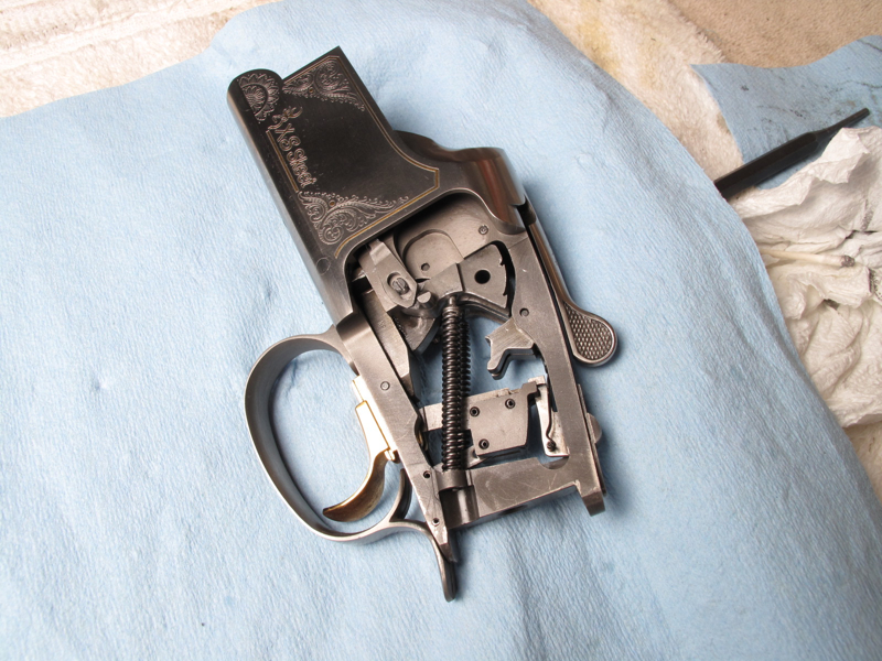

3) Remove stock from receiver; hammers should be in fired position.
My gun came with a big Allen wrench to remove the stock bolt. After you unscrew the bolt (it does not actually come out of my stock) tap/bump the receiver with your hand from several directions until it starts to come off then carefully pull it straight out of the stock.

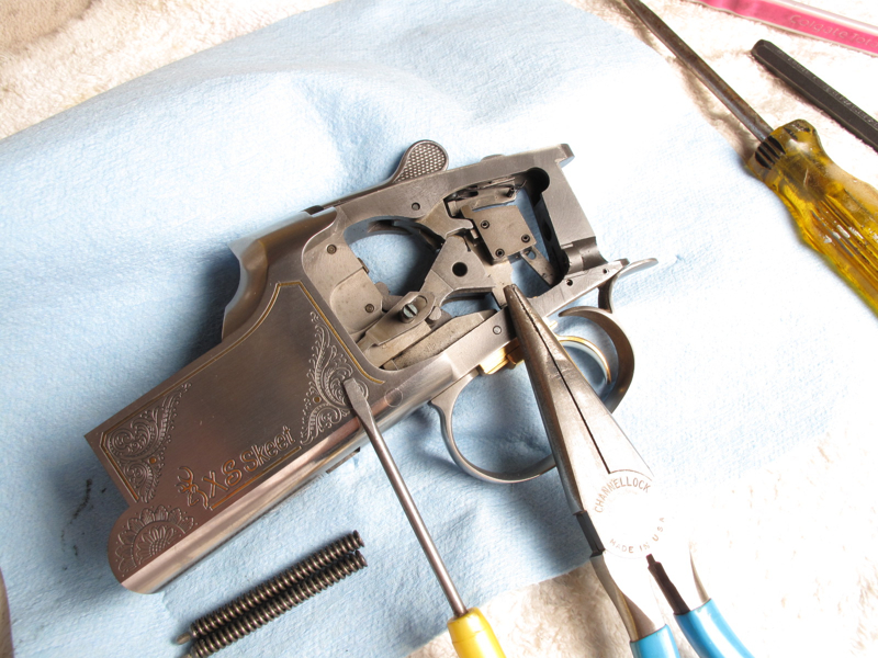

4) Remove hammer springs and spring guides
Use needle-nose pliers or file a slot in an old screwdriver like I did and pry the tip of the spring guide out of the recess in the hammer. The guide and spring come out pretty easy, the guide might zoom out from spring tension if the tool slips so be careful.
The spring guides should not need replacement as long as they are not bent or beat up. Examine the tip that fits into the recess on the hammers, these tips should be rounded and smooth, the shaft should also be smooth and straight. I polish the guides with ScotchBrite pads or fine silicone carbide paper.

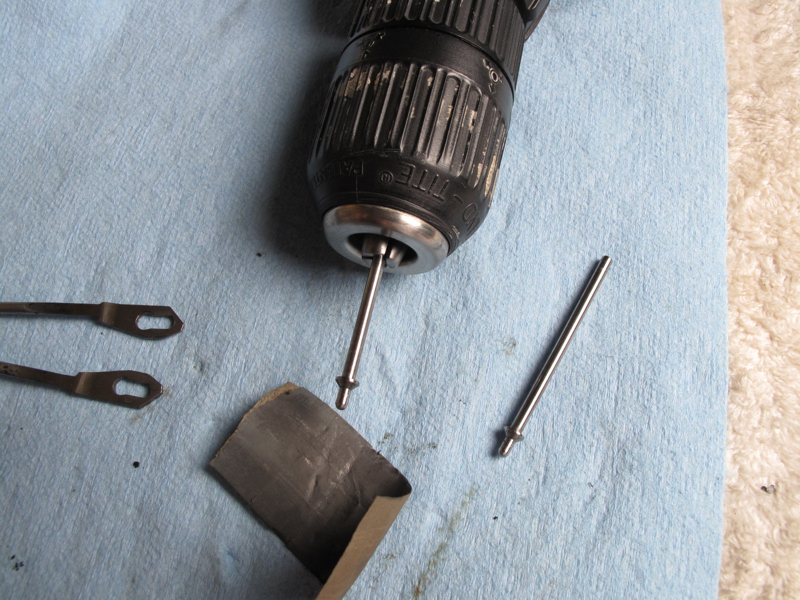

7) Remove firing pin retainer pins
These pins should tap out easily with a punch and small hammer. The top pin must be tapped out from the right side of the receiver and the bottom pin tapped out from the left side. You will see a chamfer on one side of the pin holes in the receiver. The pins get inserted into the side with the chamfer and tapped out from the reverse side. You will see that the pins have knurling on one end. The knurling holds the pin in the hole. When replacing the pins, insert the end of the pin with no knurling first. These pins are cheap, replace them every time they are removed.
8) Remove firing pins and lower firing pin spring
The firing pins might fall out after you remove the retainer pins, but I always have to push mine out with a toothpick from the front becase they are always filthy with gunk from firing and cleaning. By the way I buy packs of wood toothpicks and barbecue skewers at Walmart in various sizes, they are super handy for gun cleaning and parts removal, etc.

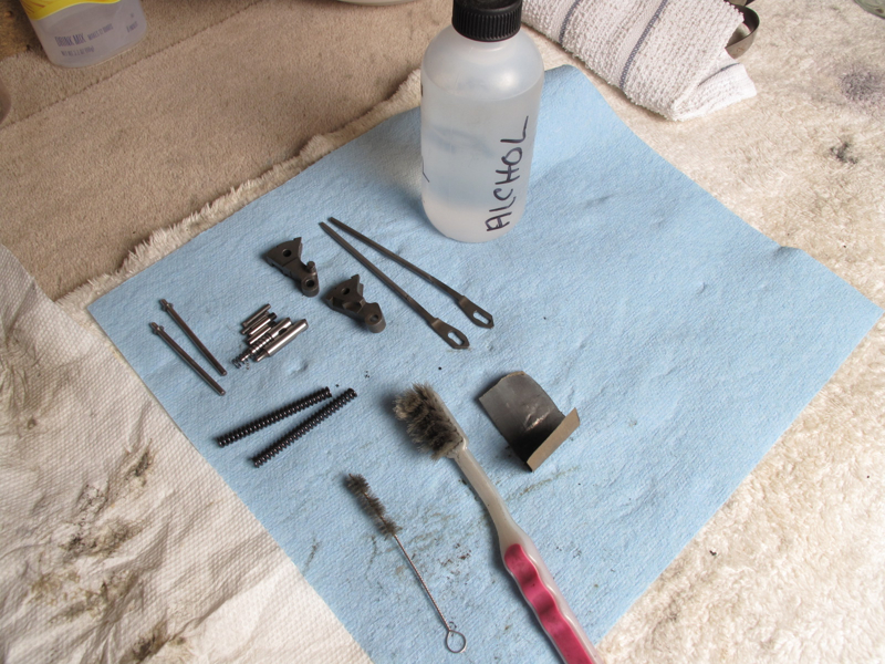

10) Clean parts to be reused
Thoroughly clean and, if necessary, polish/smooth any parts to be reused (probably just the hammers, hammer spring guides and trip rods)
This shows the old and new parts for comparison:

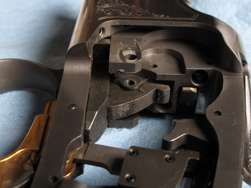

11) Clean receiver
I clean my receiver by squirting it with a lot of drugstore alcohol, cleaning out all holes with alcohol soaked Q-Tips or a little electric razor cleaning brush, scrubbing everything with a toothbrush and then blowing all the remaining gunk out with a blower attachment on an air compressor.
