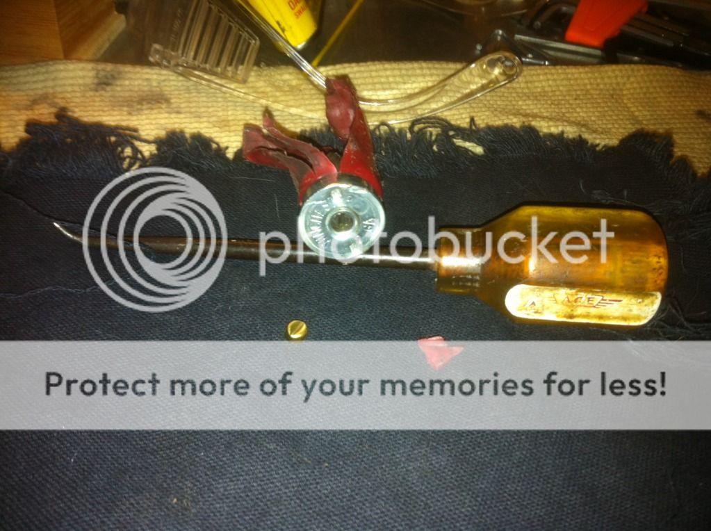

This malfunction occurred in my Model 37 Featherlight 12 Ga., early 1960’s Mfr., in perfect condition (or was). Ammunition was new (Remington 2 3/4 target loads). While doing some clay shooting, a shell in the magazine discharged upon slide retraction following a normal firing of the chambered shell. Fortunately the live shell ahead of the errant shell in the magazine did not discharge as well, or there might have been some serious damage. Upon the discharge of the shell in the magazine, it recoiled into the carrier, piercing the shell head, and the primer blew out of the shell, thus releasing additional pressure to prevent rupture of the hull. I recovered the primer with a metal detector and found that it had an indentation which is a perfect match for the rim of a 12 Ga. shell. This suggests that, upon slide retraction, the rim of the ejected shell from the chamber somehow struck the primer of the shell in the magazine causing that shell to discharge. Human error regarding gun handling and loading can be ruled out here. I have never seen this happen before nor heard of it happening. If anyone has had a similar experience or some pertinent information to share, I’d be interested to know of it.
Photo link=http://img109.imageshack.us/img109/4853/model37041.jpg
Primer photo (Note the primer separated from the battery cup)=http://img594.imageshack.us/img594/5329/iphone112712085.jpg

Thanks for the input. I've added a photo of the shell in the magazine. I think it is obvious that the shell dicharged before it was released from the magazine.

Could you please post a photo of the primer of the Kaboom shell.
This is extraordinary. Let's try scenario number three. Fired shell goes boom, slide racked, incorrect sequence for ejection of fired hull, fired hull is somehow stuck and brought back up to meet the head of the shell in the magazine.

I would like to see pictures of the shell outside of the magazine tube. Also a picture of the spent primer with the indent in it.
Showing a picture of a shell minus primer resting against the carrier forks tells us nothing.

The shell which discharged normally in the chamber was on the ground, having ejected from the receiver. The rim of this shell had a flattend dent about 3/8" long along the radius of the rim and 1/8" in width. This dent looks like it was caused by impact with a flat metal surface rather than the primer of another shell (just to confuse the issue more). None of the other shells fired that day have any such damage. The plastic hull of this shell is scorched just ahead of the metal base. No scorching at this location was noted on any of the other shells fired in the Ithaca that day (a total of 39 shells were fired leading up to this malfunction).
The live shell ahead of the discharged shell in the magazine was compressed from end to end and sooty, but, fortunately, was not discharged. I do not have that shell at the present time, but will be in possession of it soon. There was loose #8 shot in the magazine. The follower nose, made of metal in my gun, was dented. The magazine spring was distorted along several of its coils. It is obvious that the shell in question discharged in the magazine, but is set back about an inch or so into the receiver, having recoiled into the carrier rails, the latter piercing the head of the shell. This has locked up the action, and I will leave it like that for now while I look into the cause of this. There was no apparent damage to the other parts of the gun, however I can't rule that out until the gun is fully disassembled and examined.
I'll look into "I Love My Ithaca". I'm assuming that is another Ithaca forum?
Photo of primer (primer separated from the battery cup and the two were recovered separately with a metal detector)=
http://img594.imageshack.us/img594/5329 ... 712085.jpg

The "flat metal surface" that shell hit was the discharged kaboom in the magazine coming back and whacking it, is my guess.
That primer was split because it fired and the pressure drove it back against the rim of the fired shell, is my guess, too.
This just had to be caused by the ejecting shell somehow getting it's base over and hitting just exactly center on the primer.
