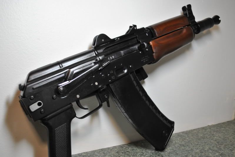

I did a Trust when I had my AK-74U (8") built. I used the WillMaker software to make the trust and just went to my bank to have them notarize it. It's a nice because it takes LEO out of the picture and I have heard they take forever to process the finger prints (FBI?). After two months and not hearing anything from the ATF, I called them just make sure sure everything was in order and got my Form 1 a week later. If you want to add a weapon you amend the trust and do your normal paper work, but you don't have to do the trust over again. Waiting time is up to 8 months now (non trust).
The engraving is on the side front of the receiver with the name of the of the Trust and address. Also when it was engraved the selector stops and the Bulgarian markings were added.
