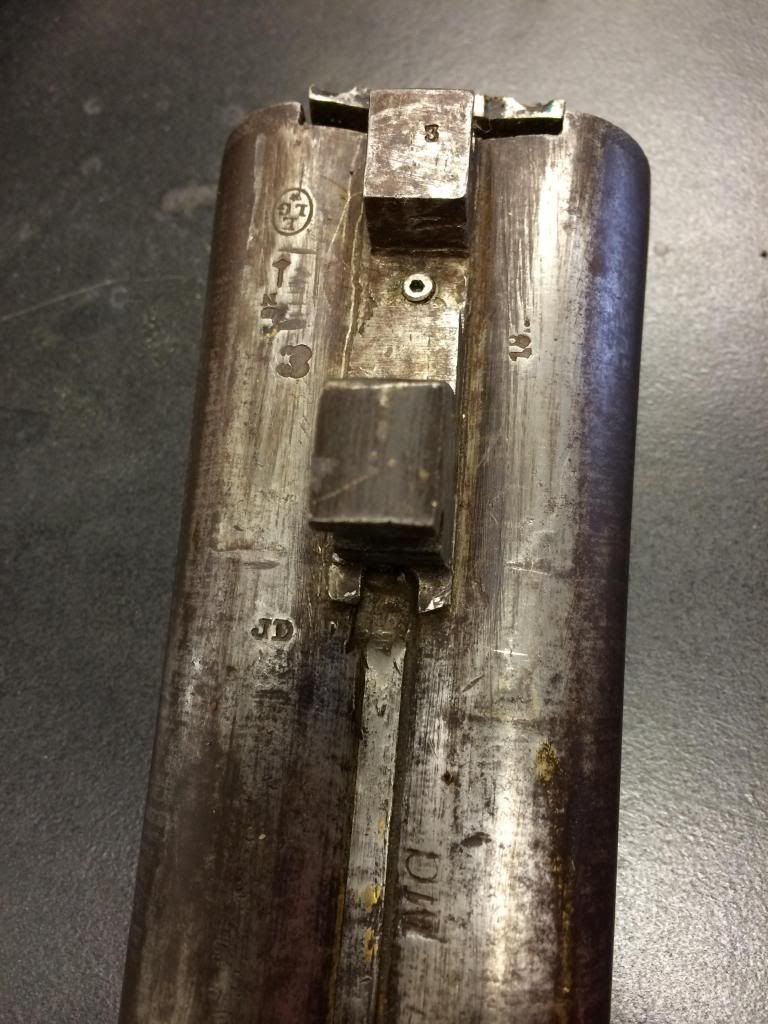

I have this one. I know VERY little on it. I am told it is an 1895 Crescent. Anyone know anything more for me? Thanks!!! {hs#
http://s300.photobucket.com/user/crarnd ... t=3&page=1

That's a lot of photographs that tell us nothing about the gun except that it appears to be a Crescent Firearms Company Hammer Double Model that was made from 1897 to 1927 in 12,16 or 20 gauges with 28,30 or 32 inch Armory Steel, Twist or Damascus barrels. We need to know all the markings found on the gun including the top of the barrels and the lock plates and the serial number. With that information, we can tell you what year the gun was
made an possibly who ,it was made for or sold it.

Crarndtii: Your shotgun was made in Belgium as evidenced by the Belgian proof marks, "E", "L", "G" and * in an oval on the barrels and the Perron (inspection) stamping on the frame watertable and barrels. The "N" surmounted by a star is the inspectors mark.
Since both the frame watertable and the barrels are stamped "JD" it can be suspected that the maker was Jean Duchateau,. I have been unable to find any information on this maker other than his makers mark was "JD".
The back action locks and side lever opening on your specimen would date it in the period 1877-1890+-. The barrels appear to be Twist or Laminated Steel which many experts consider not safe to use with modern ammunition.

JABC -- Just Another Belgian Clunker.
The North American market was flooded with cheap shotguns from Belgium from the 1870s to WW-I.
Back in 1889 the magazine Forest and Stream was doing a series of pattern and penetration tests of various shotguns available to the American shooting public in each issue. For the September 26 issue they decided to take a break from the Greener, Scott, L.C. Smith, Winchester Model 1887, Colt, Remington, etc., and test H & D Folsom's cheapest doubles. Here is a brief quote of what they had to say --
“...but the mean grade gun of no name. "W. Richards," that nonentity in the gun trade, was stamped on the plate, but they were really only those cheap bits of ordnance which come through our custom houses, pay a duty of 40 per cent., and yet may be placed on the counters of the gun shop at $5 a piece. The Forest and Stream has already in past times expressed its opinion about these pestiferous products of the penurious population clustered on Belgian soil.”

'JD' turns up a lot, and in that location is likely the barrel maker; Jean Delcour-Dupont, Joseph Delcour or Jules Delheid. All were members of Syndicat des Fabricants de Canons de Fusil de la Vesdre.
http://docs.google.com/a/damascusknowle ... Xntqw/edit

Drew: Would the barrel makers mark, "JD" also be stamped on the frame watertable?

No, not if 'JD' was only the tube supplier

two old dogs is correct of course. He has a sharper eye than I do (and is most likely younger and better looking). I just didn't want to go through all those photographs looking for what I should have. Between about 1880 to 1914 when World War One, The Great War or The War to End All Wars (your choice), cut off exports from Europe in General and Belgium in particular thousands of inexpensive shotguns were imported into the United States. These guns were designed and made using the technology and metallurgy of the times and for the ammunition in use backl then which was a 2 1/2 inch shotshell loaded with black powder and lead shot. They were not designed for longer, 2 9/16 or 2 3/4 inch shotshells loaded with smokeless powder and certainly not modern 3 inch or magnum shells loaded with high pressure smokeless powder, steel shot or solid slugs. These old guns should not be fired with any ammunition due to the risk.
