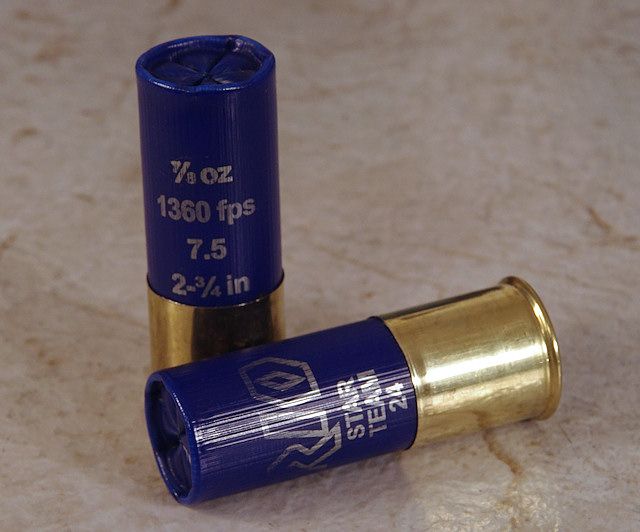

Here are some interesting hulls I found last week. Definitely the highest brass I have seen so far. The reloaded like regular Rios.

they are T5.
I'm seeing those too, all boxed as Star Team, higher velocity. What inthe sam hill did you use to size that tall base. I am not loading them, just playing with them, but had to put them in my super 77 sizer, then remove the lift rod and put them in again to get the last 1/16" at the top. Wouldn't get it all on the first stroke.
I do pick up all those high base hulls, but segregate them all, store them up until I got a decent batch, and load nothing but buckshot in them. That way a guy my age can still use the old case identifier as high brass meaning "high power" or some other special shell identification.
I don't follow UEE's logic of loading 7/8 ounce in such a wicked looking hull. Boraghi and others do the same thing.

About a year ago a friend gave me about 200 Remington hulls with a similar super high base... In attempting to load some to "check things out" I found that on my MEC 9000H once deprimed and sized I could not remove them from the sizer. Once I backed off the nut I could lift them out with no problem. I gave them to a friend that loaded with a 600jr, he had no issues..... Larry
I know guys with 600 Jr's who cuss hulls with lower bases than these or your Remington's, the ring sizer push rod hates them. They will use the MEC supersizer on some of the standard game hulls.
I know those shells well, and as factories, they are stellar performers (all the way out to at least 70 yards).
And yes, they reload just like regular Rio's.
Is the collet sizer on a 9000 any deeper than a Super 77? My supersizer will not reach all the way to the top of those high sides. Otherwise, yes, I do think they should load like the regular RIO's.

In a pinch, a Lee Load-All should re-size those no problem.
No, they use the exact same collet and part number, and it is even interchangeable between the SS77 and a 9000.
That is somewhat of a down-side to such tall brass, - no all of it will fit into the resizers. To date (not that I load a heck of a lot of those super tall brass Rio's), I've never had a problem cambering them in any of my Browning Citori's, or Benelli Cordoba.
If I was any better at posting pics, I'd put one up. I DO NOT load them for daily shooting, I only collect them for my buck or ball loading for easy I.D. should they get mixed with anything. After the first trip through the S77 normally, there is a distinct flare around the top 1/16" of the steel base, enough to catch a very dull fingernail. Can't see how that would fit into anything. Or mebee it would fit, but I'd never tried it yet, just visibly it looks to not fit wit that big edge.

Joined: Sun Jun 10, 2012 8:10 pm
Posts: 274
Location: Phoenix AZ
I resized mine in a MEC Sizemaster. I didn't pay close attention about the fit in the collet and if you look at the pictures, there seems to be a bit of a bulge at the upper area of the brass where the resizer didn't reach. Anyhow, they fit into my Citori chambers without problems and shot just fine.
I will take a closer look next time I'll find some of those.
