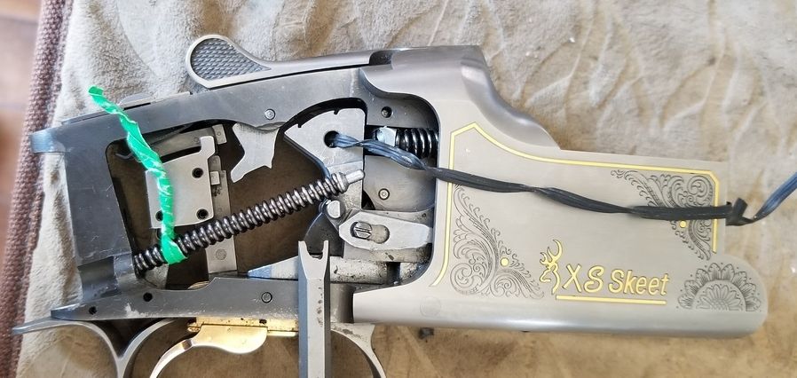

Your suggestion should be a good one, Ulysses, but for the problem I am having which is I cannot get the end of the hammer spring guide to slip into the receiver hole. Still, I will give it a go with picture hanging wire. This may work if it allows me, with the receiver clamped firmly in a vice, to get a good look at the guide pin so that I can position it into that blasted hole. Come to think of it, that might work just as well if I use the screwdriver tool I fashioned with a dremel; the trick being that I can stand behind the receiver and see what I am doing.
Yeah, this is one of those jobs where a firmly anchored vise comes in handy. This way you can use both hands.
If you can get the spring compressed enough, getting the front end of the guide rod into the hole on the back of the hammer should be very easy. Of course, this assumes you can see the hole. :)

Can I see the hole to get it in? Harkens back to my youth.
Anyhow, I figured out a way to get that main spring and main spring guide for the lower barrel lined up. (The left side was a cinch, but it is installed at a very different angle and not up against the thumb of its firing pin.)
For a good laugh at how I got it see the following picture and how I put to use a twisty tie from a package of tacos and a larger one that I picked up off the garage floor. I think it had been used to secure garden vines to a block wall. That one kept the firing pin compressed against the firing pin return spring and I used the other to pull the pin up into position as I looked through the hole from the butt end of the receiver. It looks ridiculous but it worked!
Now that I have my procedure down and my screwdriver tool formed I am ready to install the new parts due to arrive tomorrow. More fun.

I came across this video of using a spring compression tool made from channel locks. [youtube]https://www.youtube.com/watch?v=Yxaqt_Afmgs[/youtube]
If I worked on guns much, I might grind myself a pair out of some cheap Harbor Freight channel locks.
