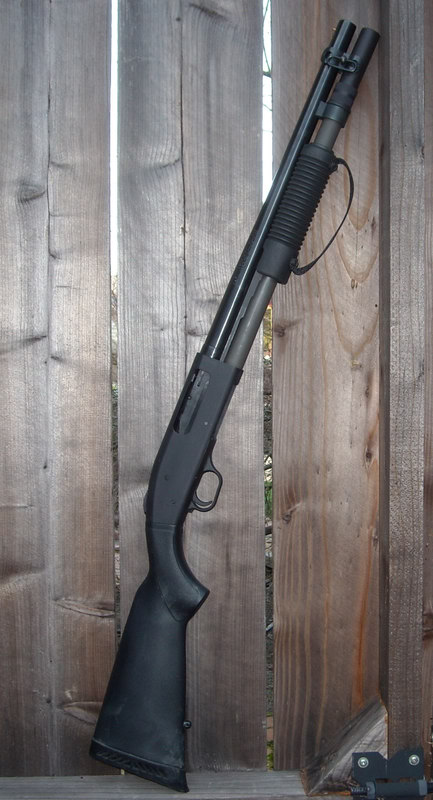

Here is my 835 with an 18.5" barrel:
Another pic with a new forend and mag extension:
 Post subject: Re: Mossberg 835 tactical barrels
PostPosted: Sun Apr 03, 2011 2:45 am
Posts: 2346
mic214, the first picture of your 835 looks just like one of my 835's, an all black one still with the sporting forend, but I have not yet replaced an overly long +4 extension with a +2 extension like yours. I now wish that I had thought of buying an 18.5" 590A1 barrel instead of the 835 security barrel, because I paid alot for Accu-Mag chokes, whereas I did not realize that the 18.5" 590A1 barrels can be ordered with Accu-Chokes for just $117. (Of course, the 20" 590A1 barrels will not work and I would not have shot 3.5" shells.) Again, nice pictures, sir. And welcome to the Basement, razor78016!

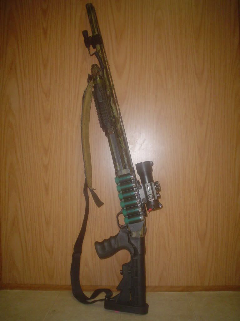

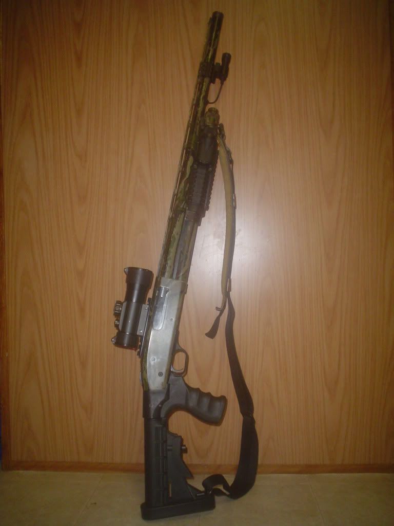

My tactical 835. Installed are a TruGlo Reddot 2X scope, pressure switch lazer, Insight tactical light, 6 shot saddle and an AR 590 Kit. The 590 butt fits out of the box but the foregrip had to be honed and the top shaved to fit. I also had to fabricate the piece in front of the grip to keep everything tight. I will be installing an 18.5 barrel with heatshield, mag extension and night vision. Why? Whynot. If I don't spend my money my Wife and Kids do. I love to modify guns and the mossberg is a rugged and easily modified gun.
