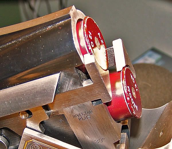

You could just remove the Ejector Springs. That works, but then the shell is only lifted a tiny amount and is difficult to remove from the chamber, especially if you're wearing gloves.
Here's an example. The top barrel has no ejector spring and the bottom has the 1911 spring. See how the top is only lifted a small amount?

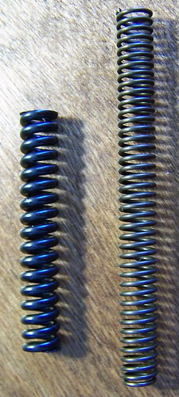

The easiest method is to replace the Ejector Spring. Fortunately for us the 1911 Firing Pin Return Spring is exactly the right size. I got two of them here:Brownells - 1911 Firing Pin Return Spring for about $10 including shipping.
Simply replace the stock Ejector Spring with the 1911 spring and it will lift the shell lightly enough to not eject it and still elevate it enough to easily lift out.
Here are two pics of both springs; installed and removed. Original on the left and the 1911 spring on the right:
As you can see the 1911 spring is longer but much less stout. You could cut a few coils off the 1911 spring, but you don't have to. To remove the stock spring just rotate the Ejector Hammer toward the spring. Hold on to the spring as it will come out with some force. If you just hold it between your finger and thumb, it won't hurt you and it won't go flying.
The beauty of this modification is that it is easily reversible. And, all this can be done at the range. The only tool you would need is a #2 Phillips to remove the Forearm Bracket from the Fore Stock. Remember that the stock spring is stout and while it can be put back in without any tools, it's not that easy and will require some force on your part. Still, if I can do it, you can too.
