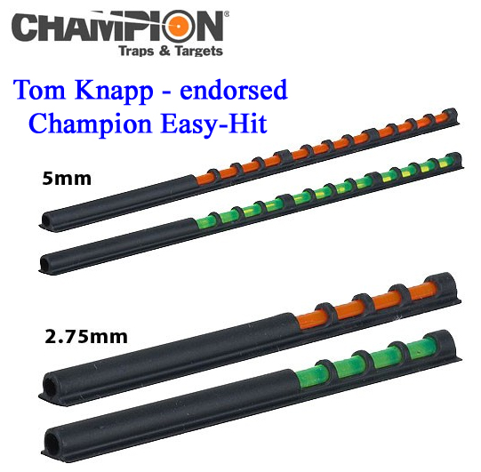

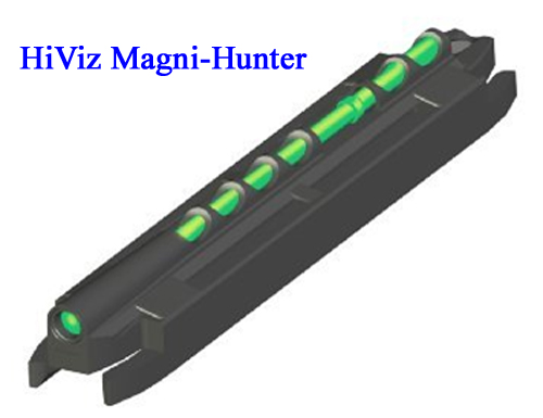

My 835 is still making progress on a mini-budget. Last year I added the 18.5" parkerized cylinder bore security barrel and had Accu-Mag choke threads installed so that I could continue using Accu-Mag ckokes. Briley's squeezed them in somehow and the bill was all right. But then I read here that I could have bought an 18.5" 590A1 barrel that is already choked for only $117 or so. Of course that 590A1 barrel is only chambered for 3" shells and it uses the Accu-Chokes used on 500's, and I have none of those, so I am back to being satisfied with sending my barrel to Briley's.
I am about to receive from Amazon one of the Tom Knapp-endorsed Champion Easy-Hit front sights, a Hi-Viz Magni-Hunter front sight, and a Hi-Viz Magni-Comp front sight. I am determined to deal with my dominant left eye, and all three of these recess the fiber optic back aways in a tube, so that only the eye looking directly down the barrel can see the dot. I am going to try each one out on the vent-rib barrel first, and then I may physically alter one of them for the plain barrel. These sights allow both eyes open shooting, a SD necessity. Later after I am better at shooting clays, I will install an XS Big Dot on the security barrel.
