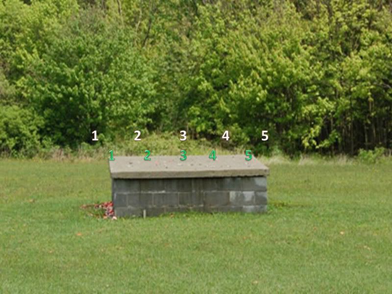

reluctant wrote:
Aside from bunker trap setups, I've only seen above ground trap houses...
Are you talking about Trap houses that look like this?
Half of this house is under ground. You just can't see it unless you go around to the front.

Posts: 227
Location: NJ
Yup, Rastoff, that's exactly what I'm used to seeing. I don't know how big a trap machine is, so I just assumed that it was above ground. I guess I am used to seeing them below ground after all. Thanks for the correction!

We have 2 trap houses like that one but we used pressure treated plywood instead of blocks, stands up to frost better. We have a drainage problem and have to run a 100 foot ditch to drain the house. Looking for a cheaper practice trap setup. I am thinking a weather proof box that just tips backwards to uncover the trap. The box would protect the trap from a low shot.
