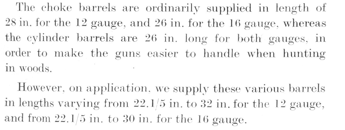

Gentlemen,
For those who are interested: here are the barrel dimensions as mentioned in FN’s 1909 manual for the A-5:
BTW: there are also mentioned two different stock lengths, i. e. 14 2/5” and 14 4/5” (from trigger to the middle of the butt plate).
