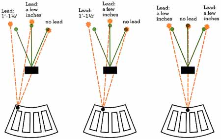

Here are some good pics that should help:
Sight Picture
When a 24 inch lead is called for, your sight picture would be two gun muzzles ahead of the target.
These leads are based on shooting from the 16yard line.
Col 4:6

Thanks for all the great information. I printed out the PDF, segment above....and have a question. Why is the lead from station 1 on leftmost angle smaller than the lead from station 5 at the rightmost angle shot - when seemingly same angles and distances? Does it have something to do with gun being on right side (with rightie)? Looks like a foot different lead...
Outstanding question! I wish I had the answer for you. I just posted the pics without really looking at them. I'm not sure I use different leads when shooting. Hmmm...
Col 4:6

when i was looking at this I the only thing i can figurae is it is right hand bias. the hold points on are also very different from station 1 to 2. not really sure why could just be that one side it is easier to swing to the target or the target is easier to see. so it doesn't get out as far. :?:
These leads and diagrams go back to the 1969 Remington book "Trapshooting" authored by D.Lee Braun which have been reprinted countless times by other publications since then.
In pages 109 and 117 the author explains at length the reason for the added lead on the right angle targets in stations 4 and 5 and the camera-gun rig photos in the book bear witness that he is correct.

Looking at the diagrams, if the targets are set to ATA specifications at 17° right and left of center line, the hard angle targets are straightaways from about 3 feet inside of posts one and five. This means that you have to stay inside the target path when shooting those presentations from posts one and five. The first diagram shows a shot path outside the target path, a guaranteed miss. Further, you darn well better have some right side lead on that same presentation from post two.

The only reason I can think of for giving the hard rights from 5 more lead than the hard lefts from 1 is that the shooter is slowing his swing on the hard right.
Geometrically they should be the same, even accounting for a gun mounted on the left or right side of the shooter.
