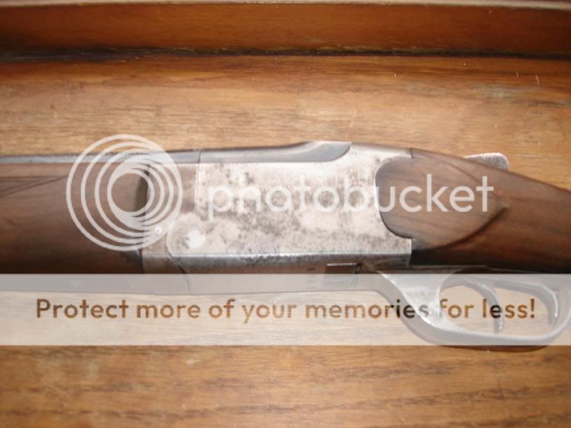

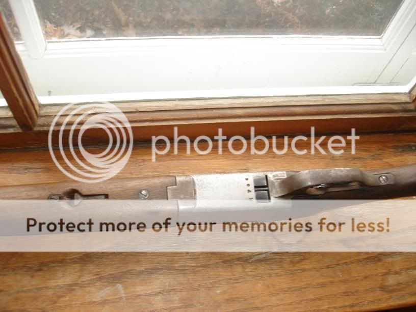

New to Shotgun World although have used the resources on this site before. I have a question about a Marlin model 90 that I inherited a few years ago. Originally I looked this gun up in a gun value book and estimated the value around $100. So I figured I'll use it as a project gun since I would like to get into restoration\gunsmithing. This morning I did some more digging and found out that it is most likley a pre 1947 since it has the seperated barrels. Some of these guns in a little better condition are going for $350-$500. I dont want to kill the value so now I am questioning wheather or not I want to do a restoration on it since it would be my first project. I am a machinist by trade so no problem getting parts, I'll just make them. I would polish up the outside surfaces and also the guts (which are pretty rusted up) and possibly re-blue the barrel. My question is if I did the restoration would it kill the value so much that it wouldnt be worth it? I'm not planning on getting rid of it anytime soon, I kind of want to use it for my upland gun, just want it to look a little nicer. Here are some pics I took today.

Based on the "H" serial number, your gun was made in 1951. Actually, Model 90's made prior to 1949 had a solid web between the barrels. The description in The Blue book of Gun Values stating that guns prior to 1949 were open between the barrels is wrong. Marlin introduced the "lever-release" or "latch-type" forearm in 1951. Prior to 1951 the forearm attached to the barrels with a spring clip. 28" and 30" barrels were generally choked Mod/Full while 26" barrels were generaly choked IC/Mod.
The frame is made with a malleable iron alloy that turns a not so pleasing plum color with conventional blueing. Also, the barrel attachments may be soft soldered and may not withstand hot blueing. I don't have any specific experience with blueing, but I've been told that cold rust blueing gives the best results.
12 ga model 90's are generally worth less than the smaller gauges. .410's and combination Model 90's are very rare and are selling for over $1000 these days. 16 and 20 ga Model 90's are selling in the $400 to $700+ range. The value is based on condition, and some people are willing to pay more if all of the serial numbers match (In at least 4 places--on the bottom of the frame, on the side of the barrel assembly by the chambers, inside on the forearm iron and on the end of the butt stock)
If you are going to keep the gun as your upland gun, it is really up to you what you want to do with it. I have a number of Model 90's, and I consider all of them as "shooters," including some that have been refinished with one of the over-the-counter cold blueing products. They do look pretty good, but the finish is not very durable. I enjoy my Model 90's for the way they handle and shoot and have not been too concerned about their resale value. A refinished 16 ga. Model 90 with 26" barrels choked IC/Mod is my favorite upland gun.
