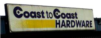

The Coast to Coast Master-Mag model CC660 is a 'house brand' Mossberg 500A 12 gauge and the CC880 is a Mossberg 500C 20 gauge. They were sold in the nearly defunct Coast to Coast hardware store chain in the United States (now part of True Value) from the late 1970's to early 1980's. The wood is probably less expensive birch rather than walnut. This might help you to date your gun. Beginning in 1970, the standard 12-gauge model featured double slide bars rather than the original single bar for added strength. In 1977 Mossberg phased out the external C-Lect dial-choke (which cannot shoot steel shot) in favor of the internal Accu-Choke system (which after 1987 can shoot steel shot). Good luck, candewman!

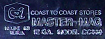

Ok, it is the CC880 only it is 12 gauge. This also has the double action bars and they are pinned, which I don't really care for. I have to look at it closely because the action bar is really loose. On the plus side, the barrel from the Mossberg 500 I have here swaps right in and the CC880 barrel fits the 500. I already ordered a new safety for it. The old one was something someone made out of a piece of wood! I'm bead blasting today so I'm going to start taking her apart and reworking what I got. Thanks.

ETA: Please disregard the following, candewman. I looked again at the engraving on the side of your Coast to Coast receiver and it plainly does say 12 gauge. The model number though is fuzzy in the photograph. Is it possible that it reads CC660, sir?

This deal with the Coast to Coast models CC660 and CC880 kept bugging me, and after some more re-checking, I have concluded that the model numbers are capricious, meaning that these model numbers do not correspond to the gauge size. The important engraving is the gauge, which in your case is plainly engraved "12 GA.", and the model number is for any practical purpose totally irrelevant. I found three Coast to Coast 12 gauge shotguns engraved CC660 and two .410's engraved CC660. I found four Coast to Coast 12 gauge shotguns engraved CC880 and four 20 gauge shotguns engraved CC880. I even found one Coast to Coast 20 gauge that was posted as being engraved CC860. Now that makes me think that engraved 6's and 8's could easily be misread, and that possibly every model number should be read as CC880. Who knows, who cares? The gauge engraving is the only relevant information, and I apologize for being skeptical that you have a 12 gauge Coast to Coast gun, candewman. I didn't want you to blow up a 20 gauge barrel that was obstructed with with a 12 gauge wad. :shock:

It's a legitimate concern, being 12 or 20 gauge, and a good thing to check on a mystery (to me) gun. The more I thought about it the more I wondered if my eyes weren't seeing things. The photo's (to me) aren't the best evidence of CC880 or CC660, so I'm going to look at it again today. I'm going to take comparison measurements as well like you suggested. Gun Parts Corp is no road map either. They don't list a CC880 or CC660 model.

It is definitely 12 gauge after comparing everything. It is also a CC880 as I re read the stamping to be sure my eyes didn't fool me. Here's a pic of the mag tube with what looks like a sheet metal thread. Is this normal? It doesn't hold it back any. I'll be completely stripping it down this weekend and checking all the internal parts and seeing what needs to be replaced. I am especially curious about the safety and since I'll be doing some machining on the receiver anyway, I might look to see if there is a better way to make the safety work near the trigger.
Also a pic of the barrel stamping

that barrell is identical to my 28in for my 500a
