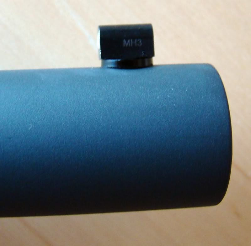

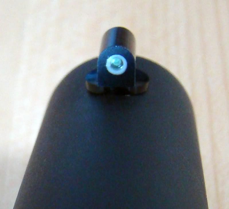

I received the marbles sight today, I removed the bead and tried the new sight, it is approx 1/4 turn from being tight. WHAT NOW?

Did you see the post from The Guinea earlier in this thread? He had the same problem, and solved it.

I've seen that and am in the process of doing almost the same. I was just seeing if there were any other suggestions. THANKS for the reply.

It works, I'll put blue lock tite on it tomorrow. Red is too permanent.

The Guinea wrote:
burch wrote:
Leaning towards the Tritium Bead.........that`ll work with my Mossburg 500A ?
I have a Meprolight night sight I mounted on my Mossberg 500A awhile back. I have a couple thousand rounds thru it since the install and it has not budged. When the sight was screwed in to a snug fit it was not centered. It would turn about 1/4 past center. So after a bit of searching at the local ACE hardware I found small, black neoprene washers. I had to sand the washer a bit until I achieved a nice snug fit. Once I got the fit, I backed it out, cleaned all the threads and then put in a dab of red locktite.
Meprolight part number for Mossberg is 34044. Its a 5-40 thread. Cost is between $25 and $30. It's very durable and very bright.

Recieved my Meprolight bead and like Guinea`s the dang thing is way off center. I guess i`ll be making a hardware visit for a neoprene washer. The folks at Meprolight need to read this post. :lol:

It's an issue with the Marbles bead as well.

It's not an issue. It would be just about impossible to index every bead and sight to "bottom out" at exactly the right point to line up with the receiver. Only recourse is to shim bead up as previously posted. Or to remove stock from there top of the barrel to let the bead turn a bit more.

Just for info sake, I had the same problem. I found the neoprene rubber washers hard to work with as they kept deforming as I would make the last turn to tighten the bead. This made it look untidy. (maybe the kind others used were harder?) In the end I found a fiber washer (home depot) which was much stiffer than the rubber ones and smaller as well. After a little sanding, this worked perfectly.

This is from Marbles. Shotgun bead installation, look at the bottom paragraph about chamfering the threaded hole. This may solve the mis-alignment issue.
http://www.marblearms.com/shotgunBeads_info.html

A tool company keeps sending me drill bit templets that's made of black plastic. I used a sanding bit in a drymel tool to make it thinner then I drilled a hole and cut out a rectangle piece. I used blue lock tight. It worked perfect.
