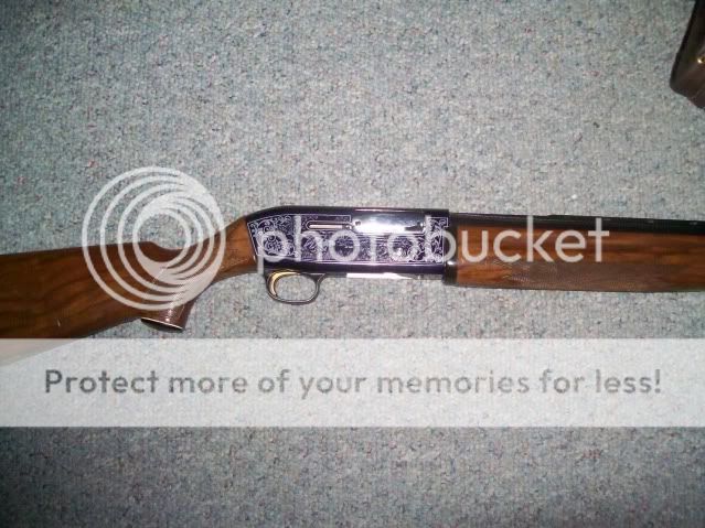

Wellcome to the very small club that appreciates these fun semi autos. I just wanted to post a short update on my original thread.
My daughters gun turned out really well. After the bbl was cut down to approx. 22 inches, but before I cut the stock, I took the gun out on the skeet range again. It function perfectly, and I was able to run a 25 strait. As I stated before, I have never owned a veg-o-matic , but this little gun is just fun to shoot. It's certainly a field gun with a narrow rib, lots of drop in the stock, and very light weight.
I did cut the stock down and it now has a 13" LOP over a 5/8" limbsaver pad. My daughter has yet to use it, because of being busy with Softball / All Stars Tournaments, but she has handled/shouldered it and is excited to use it.
After running the strait, my squad mates kidded that my daughter would never get the gun. They weren't too far off. I finished the gun for her, but I did buy an SKB model 1300 in 12 ga for me. The 1300 is almost the same as the XL 900. Same action, but has screw in choke tubes, a plain blued receiver, and some variance in the barrel where it meets the receiver. I got this for $ 200 off gunbroker. The first time I took it out, I ran another 25 strait. I bought this as a skeet doubles gun, but I may vary well shoot it in the 12 ga events as well. It function perfectly with my mild 1 oz, and even 7/8 oz reloads. I may add some weight to the stock and possibly have the stock cut for an adjustable comb, because of the large amount of drop .
