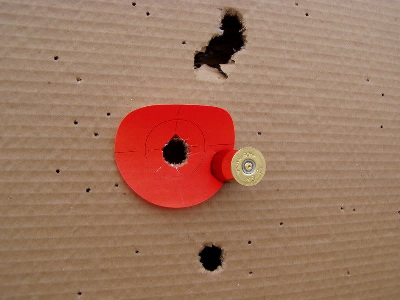

This group was shot with Benelli M2 Federal tru-ball slugs 60yds shooting of standard bird barrel IC choke , shooting setting down resting gun on my knees. Note ragged hole above bull. I adjusted my sight picture a little and got closer to the bull.
I would try a box of the tru-balls
