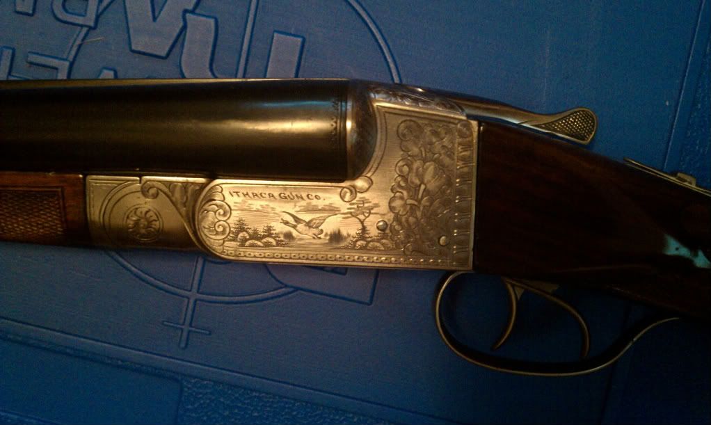

this shotgun has been handed down to me from my great grandfather. i checked the serial number online and it looks like it falls under the 1920 segment. i have posted this in other forums and i cant seem to find any solid info on it. any help you can give would be great. if there is anything specific that would help identify the gun, i can upload pictures.

When asking value, pics is the only way.

You apparrently have an Ithaca Flues Model Double, which model was made from 1908 to 1926, when the New Ithaca Double (NID) went into production.
Here's some shooting info (make "search" your friend):
viewtopic.php?t=4625&highlight=flues
FWIW - Value is determined by assessing the internal/external condition, percentage of remaining original finish, and the grade of quality it was made to (field grade, No.3, No.5, etc) - a lot of which can be determined only with multiple clear pics of both action sides, the stock(s), and a description of it's mechanical specs (bbl length, ejectors Y/N, etc) & watertable / bbl flats markings.

wow, thanks for the responses....i forgot i posted this on here and started my search again today and figured i would post this back up... i really dont want to shoot it, and im not planning on selling it due to the personal history it has.
do these crummy pictures help at all?
http://s1105.photobucket.com/albums/h34 ... thaca2.jpg
http://s1105.photobucket.com/albums/h34 ... ithaca.jpg

It's a one-of-a-kind underhammer . :mrgreen:
1) the pics can be rotated in photobucket for easier viewing
2) it's definitely a higher grade than Field or Special
The grade is usually stamped into the action watertable flats, viewable via removing the forend & unhooking the barrels.
There is most likely a "4", "5", or whatever stamped thereon.

Your gun looks like a Grade 4 Flues Model with the post-1915 engraving style. From the December 1919 Ithaca Gun Co. catalogue --

researcher01...that looks like its the one. my mom wasnt home today when i went over but ill have to check out the receiver to see whats stamped on it.

Anyway, you have one fine gun there. But if you ever decide to shoot it, use shells from these companies; low pressure. http://www.rstshells.com, http://www.polywad.com, www.neweraammunition.com
