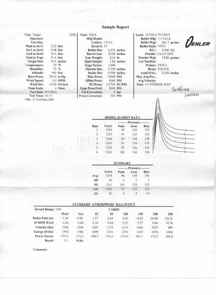

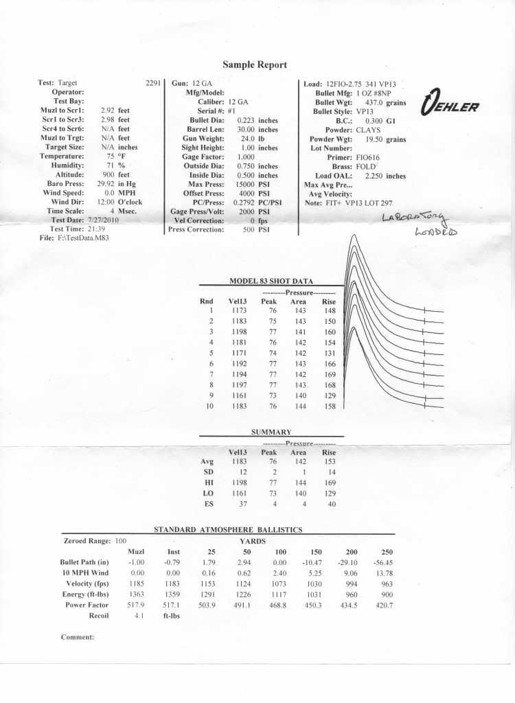

I supplied BP with 10 shells. Here is a letter, and data:
I live in very dry conditions out west, hulls were stored in a dry storage shed, have used three other wads with the same load, and even changed primer on one reload, and no off sounding shells with those other wads.
Do not know why only six shells tested? Supplied ten. If my hulls were bad it sure does not show it in the results. My hulls were twice fired.
You can decide for your selves, I have my own conclusion, and it does not look good on the part of BP, they have dismissed the photos of the fired wads. 10tenner

12 2.75 Fiocchi Fio-616 Green Dot 21 VP13 none 1 1/8 Lead #8 8800 1220 my busing is throwing 21.5 grs. I noticed a considerable reduction in recoil with the VP13 wad, and was not getting the breaks in the birds as I was with the VP15. When I shot the ClayDot load the recoil was minimal, and bits of plastic could be seen going out in the air. Anytime you have a leak in gasses the PSI drops and the velocity drops. BP is not going to change there mind, since millions of wads have been fired. I took those reloads apart before BP even contacted me, and I am not even sure I sent them them the bad lot, as I have more than one lot. It could even be a single mold issue. I have some VP10 wads that the center section, or the arch on some VP10 wads are completely filled in, so this indicates a mold issue. I do not have time to do a study right now, hunting season is staring in 12 days. I still would like to know what they did with the other 4 shells, could it be some bad wads found, I do not know, it they took the shells a part to see what powder charge, etc, why not reload them in new hulls and test them?
Last I tried same reload, and even changed the primer Noble Sport 209 to see if it was the CLAY DOT powder. Shot GU1225, Nobel Sport NSGT24, and XXL Orange wads with no problems. I even shot box of XXL Orange, and NSGT24 last Saturday, and box of NSGT24 wads last night. If I am right BP is indicating in the letter Clay Dot is not balistically the same as Clays?

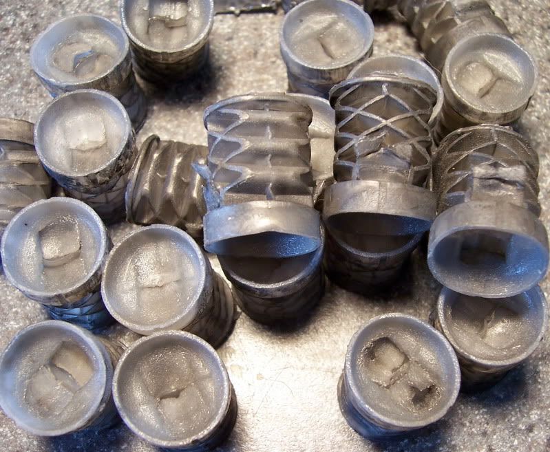

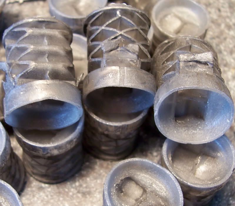

I wouldn't say that T.g. ... - Ron Jr. at Claybuster took it upon himself to re-make the mold for the CB-6100 to correct the powder cup which wasn't sealing properly. Yes, granted Ron, and his operation is a cut above the rest in that he has the ability to make his own molds, but over and above that, it's clear that Ron is also a practical business man who knows what the right decision is when confronted with a problem and a situation.
Based upon what I've seen so far, I have faith that BPI/HelarcoUS has people who are also of the same caliber as Ron Jr. at Claybuster, and can influence the HelarcoUS plant managers to make a change. That's my gut feeling. The reason I say that is, (and I think you'll agree), is the level of passion for "attention to details" that they appear to have as illustrated in their reloading data. They have more comprehensive published data for their wads than anything I've ever seen. Hell, there are other wad makers here who won't even post any data on their wads much let alone even post pictures of their wads on their web page.
I may be wrong, but I just don't see the BP/HelarcoUS folks as being a bunch of back-yard mechanics just punching out bits of plastic on some old injection mold machines in the back of some warehouse somewhere.
It could be. Accurate data is important. The mold cell/section numbers are stamped on the inside of the shotcup.
Me too. But unless you gave them the exact numbers of 461.7 grn's payload, and 19.80 grn's of propellant (and they took that for granted), they would have had to cut some of them open to take measurement samples, right ? Also, why don't you just call them on the telephone and talk to them and simply ask them?
Correct, - Clay Dot is NOT ballistically the same as Clays. I've done more than enough testing to prove that point already. It may be "close", but it's not the same. It's about 35 fps hotter than the same charge weight as Clays, which means that the pressure is also higher. It also seems to have a sharper recoil.
Moreover, your data that that you received from them sort of illustrates this. i.e., 19.80 grn's of Clay Dot under 461.7 grns of shot averaged 1,244 fps, whereas 19.5 grn's of CLAYS under only 437 grn's of shot averaged 1,183 fps. Granted, not an apples-to-apples comparison, but at a glance, I don't think that a .3 grns reduction in powder under a payload that is 24.7 grn's lighter is going to yield a velocity that is 61 fps lower.

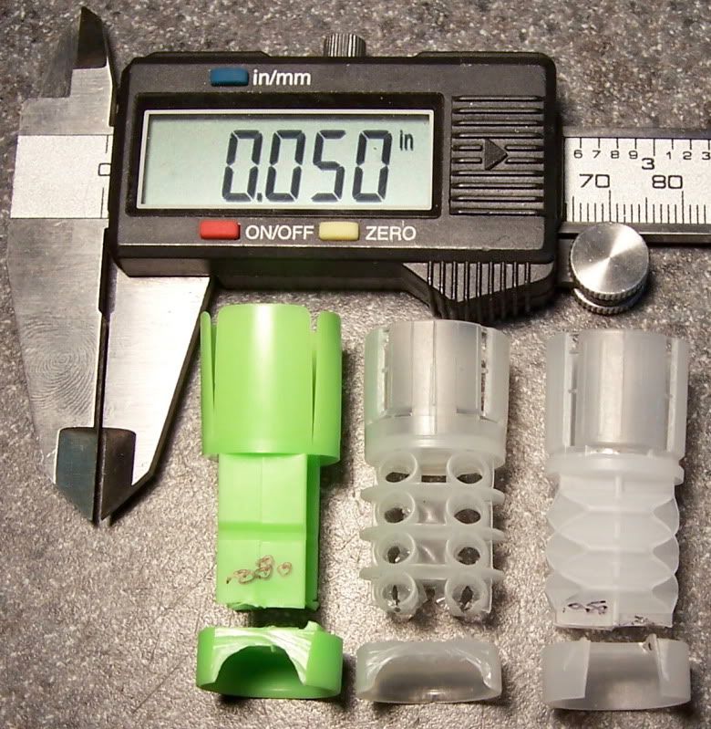

Take a VP 13 wad and in the rectangular section push with a pen. Now do it with another brand of wad. Vp13 wad will compress and allow indents, and if I pressed too hard will give way and puncher. I cannot do this with the other wads I tested with Clay DOt. What I can do is take the 4 wads, and trim them to see the top of the powder cup thickness.
Unfortunately, I'm out of VP-13's, - is there a way that you can send me some to test? (PM me).
I did however, find a few VP-05's up on the bench, and so I did this measurement for you. The powder cup thickness is .050. The Bossi wad (used in factory Rio's) is .070, and the Claybuster CB-6100 is .080 as shown :
Legend (left to right): Claybuster CB-6100, Bossi A-28-1, HelarcoUS VP-05
A little more of a close-up of the same photo:
I'm a bit interested in this saga, and willing to put a little more effort into it all before I totally throw in the towel on the HelarcoUS VP-13 wad. And the reason is simply because my testing data was so darn encouraging. Yes, it's a cheap-arse looking wad, and yes, I too have noticed the bits of plastic flying out in the corner of my eye when shooting them at night under lights at my Wednesday night trap shooting venue, but the chrono data, and the powder migration qualities, and price/availability aspects of the VP-13 are were so compelling, that I believe that it's worth attempting to work with these people to get it right.

I deal with molded covers that are in the steering wheel of your vehicle. Two weeks ago the tooling broke, and another cover was suspect, flashing in one of J-hook openings. Quality engineer passed them, but they did not look good. A mufti-million dollar operation, still can have Quality control problems. Another example, the Nissan emblem was not being welded property on the sonic welder. I told the Quality engineer to look at the discoloration of the plastic. He then had the plastic analyzed, and they found out the resin the vendor was using was out of speck.
That proves the base wad is not thick enough, and the plastic is not as rigid as well.

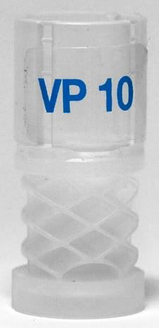

I just looked at my bag of VP-10 wads and noticed the same thing. It doesn't look like a mold issue. It looks intentional.

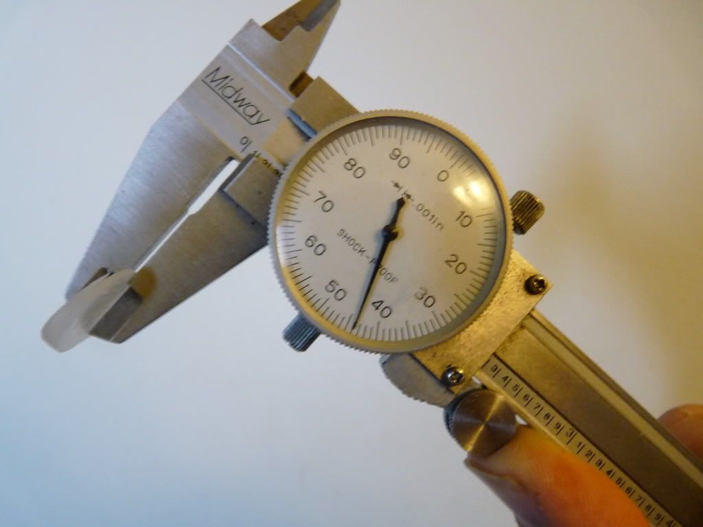

I cut down a VP 13 wad and measured .044.
I cut into the rectangular section and it measured .036

Smelly Benelli, thanks for posting the pictures. The arch above the powder on some of the VP10 I have are completely filled in. I do not know if it was intentional for support, or a mold issue. 10Tenner
Wow, this whole thing is rather interesting....
T.g., you've mentioned numerous times that the VP-10 seems/looks beefier, and since I don't (or ever did) have any VP-10's here,the closest I do (photo wise) is to just post side-by-side photo's of the actual photos that are on BPI's website :
If you look closely where the crush column meets the powder cup, you can see that there are more contact points on the VP-10. Further, and maybe this is just the lighting in the photo's, but it appears that the cross sectional ares of the width of the roof of the powder cup can be seen thru the edges of the cup, and it does seem thicker. Again, it might just be the lighting/photo.
But thanks S.B. for posting the photo's of the VP-05, - that's more information that we didn't have before.
Hopefully that thing has current calibration, and/or you were able to check it with a second micrometer.
If so, this indicates that there is at least a .005 difference between the thickness in the roof of the powder cup between the VP-05 and the VP-13. Which could stand to reason actually if you look at S.B.'s photo's of fired VP-05's who's splits are not quite as drastic as your photo's of the VP-13.
MM3

Mokeman, I will take a photo of the VP13 and VP15 more contact with VP 15. I took additional measurement, new picture above.
I have a 1 in micrometer, and they read the same. 10tenner
So you are saying that you actually have VP-10's where this is not filled in ??
If so, do you see them mixed within the same bag ?
This is significant (in my mind). This would indicate that they (Helarco) ARE tweeking the molds of some of their wads in the background, and so they may actually be silently engaged in all of this. At minimal, it is evidence that they did in fact change the VP-10 based on these photo's (when compared to the photo of the VP-10 that they have posted on the website).
MM3
The pics I posted of the VP-10 were from a new sealed bag of wads. I opened the bag after reading tengauge's post above. I think I bought the bag about 6 months ago.

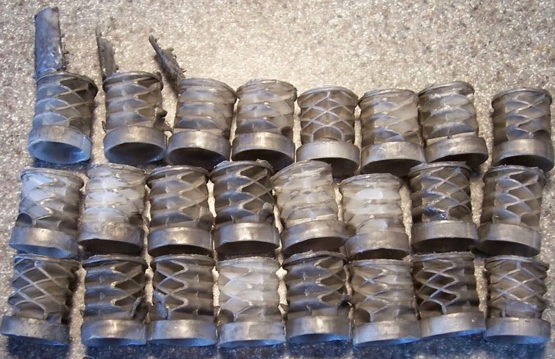

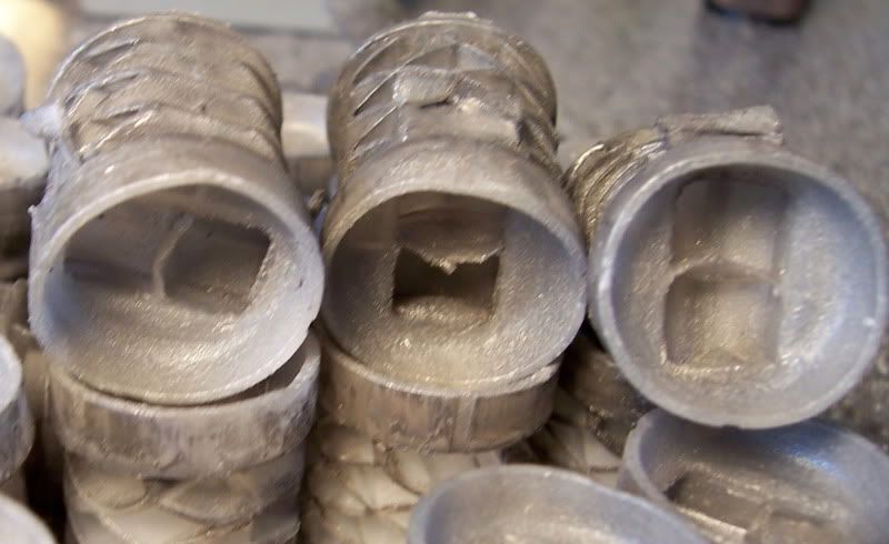

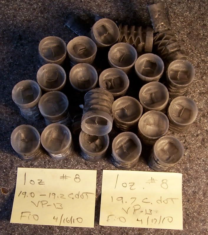

Ok, as promised, - I spent some more time looking into this today ...
I shot 2 boxes, - 50 1-ounce loads made with HelarcoUS VP-13 wads at the patterning board today.
The first box was ~19.1 grns Clay Dot in clear Fiocchi hulls, and the second box was 19.7 grns of Clay Dot in orange Fiocchi hulls. I was only able to find 24 of my fired wads (geeze, what a hell-hole down in front of the patterning board, - can we get someone to clean that up down there ?).
Test conditions:
Date: 8/21/2010
Time: 15:00 - 16:00
Temperature: 73 Deg F
Chrono: Pro Chrono digital
Gun: 30-inch Browning XS Skeet
Choke: Carlson extended tube "SKT"
String size: 12-14 shots
Data:
Strings 1 & 2 (S1 & S2) were assembled as follows:
Payload:1 oz #8
Hull: twice-fired clear Fiocchi
Wad: HelarcoUS VP-13
Primer: Fio 616
Charge: ~19.1 grns Clay Dot
Results (S1):
H: 1260
L: 1207
Avg: 1236
ES: 53
SD: 17
Results (S2):
H: 1257
L: 1222
Avg: 1247
ES: 35
SD: 11
Strings 3 & 4 (S3 & S4) were assembled as follows:
Payload:1 oz #8
Hull: twice-fired orange Fiocchi
Primer: Fio 616
Charge: 19.7 grns Clay Dot
Results (S3):
H: 1285
L: 1259
Avg: 1270
ES: 26
SD: 9
Results (S4):
H: 1291
L: 1239
Avg: 1266
ES: 52
SD: 16
There were no signs of bloopers, off-sounders, or anything even remotely close to a weak load as felt by recoil. Just 50 solid-ass "Whap's!" as a blast of #8's pulverized against the big thick pattern board some 20 yards away.
I first attempted to go down and retrieve each wad and label it with the chrono speed, but THAT got old REAL quick! Best I could do was to separate out the wads that I could find from each of the two boxes tested, but that didn't quite pan out either as each time I went down there after each shot, I either couldn't find the wad, or I might have picked up a wad shot from the previous box.
Towards the end, I figured out where to gaze my eyes before taking the shot, and I was able to see (in flight) where the wad was bouncing back to. Never took my eyes off of it, and walked down to get the wad.
So here's what we're looking at. My actual Post-it note box labels are below the wads:
Almost every wad had it's feathers plucked either in flight, or from slamming into quarter-plate at 900 Mph:
Some had the roof section of their powder cup blown so far up into the cushion section, that it even flipped up backwards out of the base of the cushion section on the top side of the powder cup:
Closer observation:
And some are torched up quite a bit:
I'll be on the telephone with BPI first thing Monday morning.
MM3
